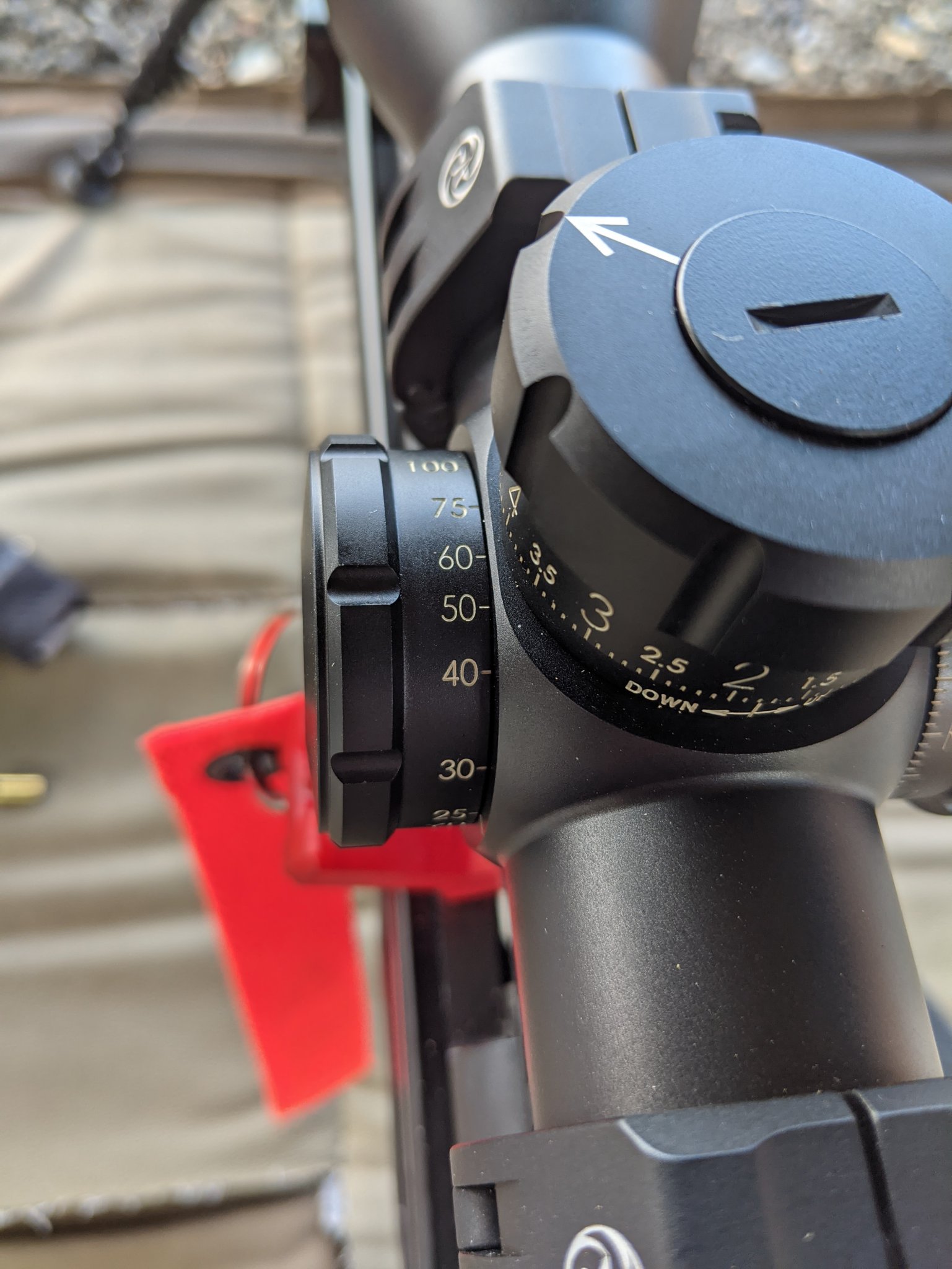

I went down a deep rabbit hole when glass shopping for my B14r steel and wound up going with a Kahles K525i. My wife is building up a B14r carbon rifle and looking at US Optics TS-20 or NF NX8 4-32 as weight and a simple reticle are big requirements for her.
