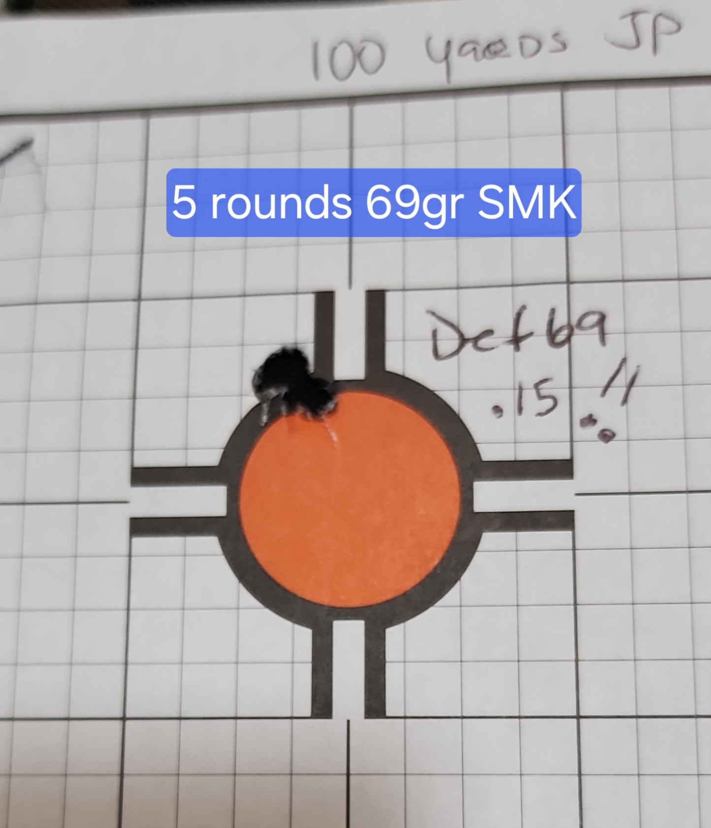

Defender Ammunition makes some really accurate factory ammo. 69 gr SMK and 77gr HPBT shoot great out of my 20" JP.
Reactions: simonp and WeR0206
