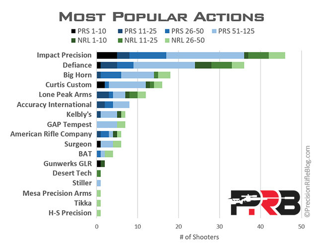

Here is some data on the most used actions among pro PRS shooters. “Best” can mean anything, but when you survey what the pros are using, seems like that’s a good starting point for what to look at. Is it ok then, to ask “why” anonymous online people think these pros prefer these actions?
Because most of them get them for free.
And they are not "pro's" - not a single one of them is a precision rifle shooter by profession. They are plumbers, Walmart greeters and dentists that happen to be good at a grassroots hobby that a very small percentage of the population shoots.
Take those "what the pros use" articles with a grain of salt. They are all good products for the most part, but what they use may not be the best product for YOU. Actions all have their own features and nuances - figure out what features you want and pick an action based on that.
Some of those shooters switch action companies every year, I wouldn't be blindly following what they do.
Reactions: Fig and bourbonbent
Sure they might not be a definitive ranking of the "best" but you would be hard pressed to find a poor choice in the PRB listing.
Especially since it basically mirrors the every day suggestions on this forum lol
"Dont listen to the PRB but do listen to us regurgitate the same info back at you"
They're all good actions more or less, that I agree with. However, just because Dave Preston uses a Curtis, doesn't mean that Joe B looking for an action should.

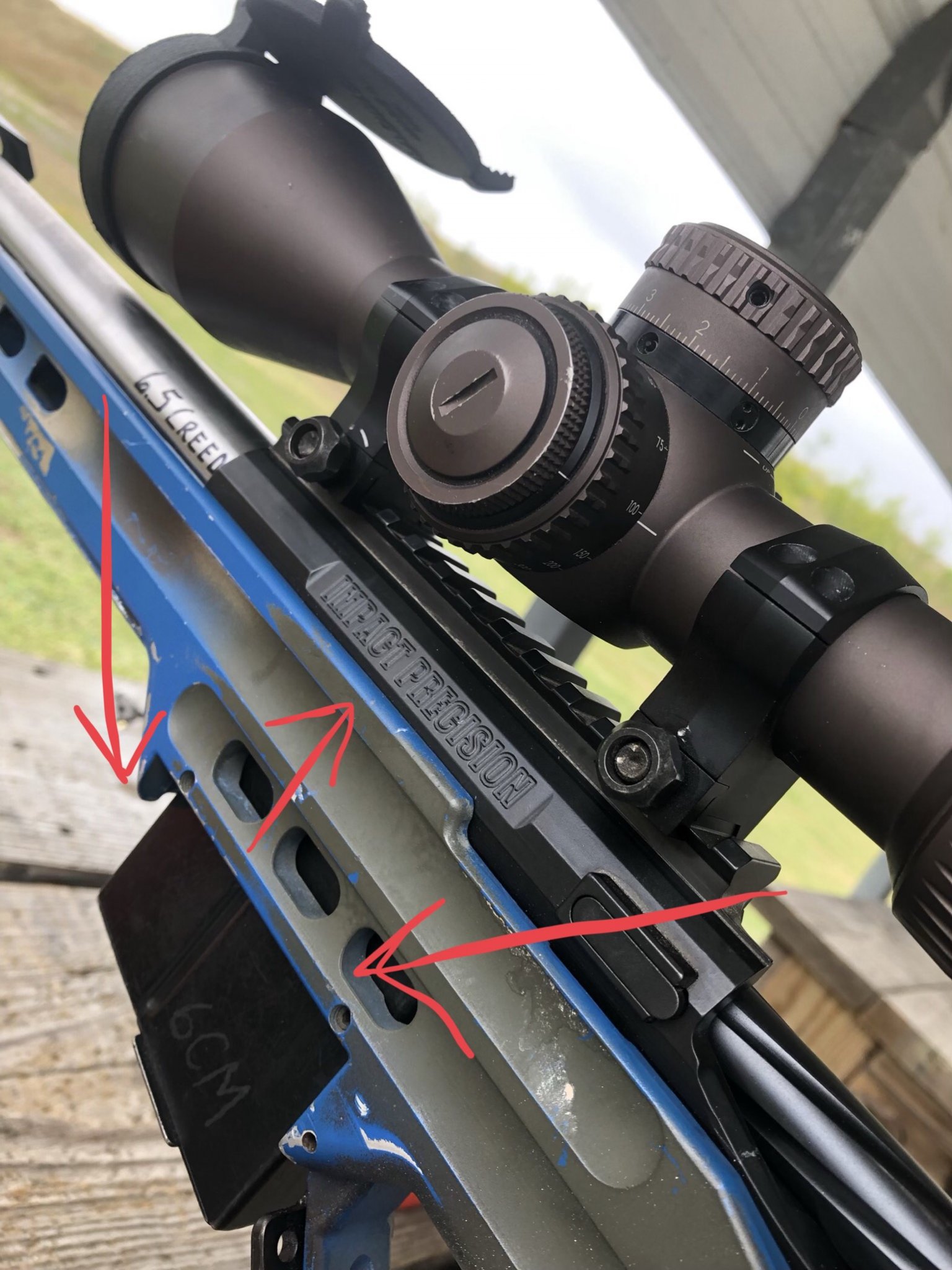

I’m new to this stuff, so forgive the dumb question. I notice the barrel says 6.5, but the mag says 6cm. Would a sponsor care and dictate that you shoot a 6.5cm over a 6cm? Also, what else am I missing?
Pretty sure he’s pointing out AW mag in an impact action. Could be wrong
It’s an old AW mag that was modified for 6 Comp Match...I just marked it so I knew which it was in a stack of them
theres no one who dictates anything i shoot...i shot my impact for the brawl this year, and my AT for silent night...likely be running the impact in NM
