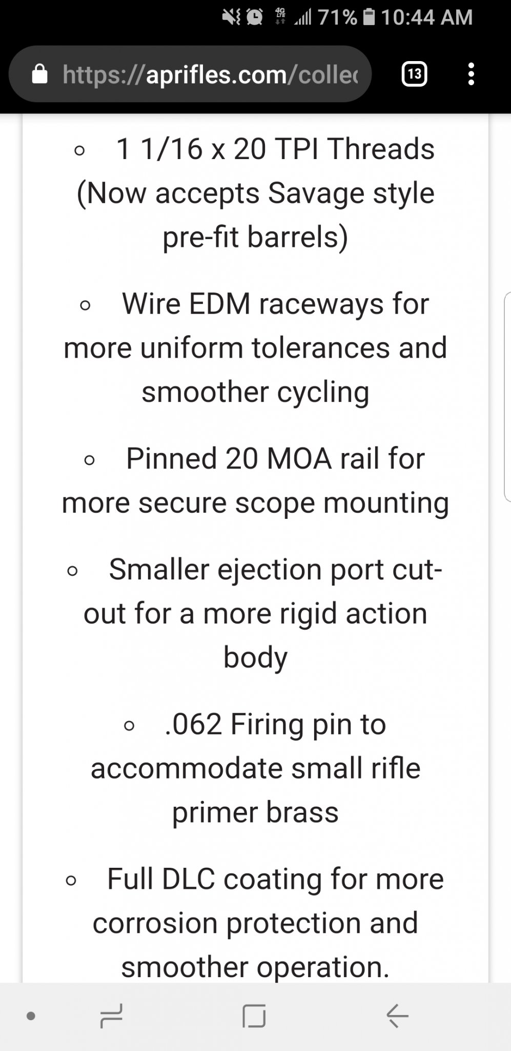

The new Alamo Precision Rifles APR Gen 2 looks really good for the money. Pre-buy price is $750...
https://aprifles.com/collections/apr-actions
I thought the Gen 1 was appealing at $800, but now they have the Gen 2 at $750. I think it would be worth the gamble. Everything I can find about APR they put out a steller rifles and can find no reasons this would be different.
