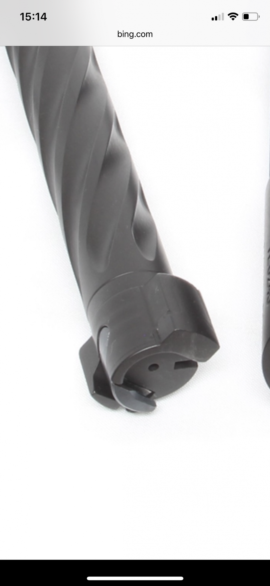

Not to derail the thread, but you see this with Bighorn, Curtis Custom and a few others where the more budget friendly actions have pinned recoil lugs. I realize this makes the receiver less expensive due to the size of the piece they’re starting with.
What else are you giving up with not going integral? I’m assuming a slight loss in rigidity. Is there any detriment to accuracy potential?
I think that is the only thing you would give up with a pinned lug. I doubt you would see the extra accuracy from an intregal lug, if that is even a thing. Doubt it's ever been tested. I bet your barrel condition either has more to do with top accuracy or hides the loss or gain of accuracy due to 3.2 smidges of rigidity.
To me, the integral lug is just a convenience of reducing a variable for switch barrels. If you're version of switching barrels is actually barrel replacement then a pinned lug would do fine for your purposes as well. IMO
Only if you want to switch barrels in the field without taking your rifle apart and don't want to rezero. If you are going to shoot a barrel for three months, use an evening to take your barreled action out of the chassis, put it in a barrel vise to remove the barrel and put another on, zero it the next day and keep it on for a couple of weeks you'll be fine with a pinned lug. If you're baller and don't even want to think about your recoil lug and have cash to spare just get the TL3
