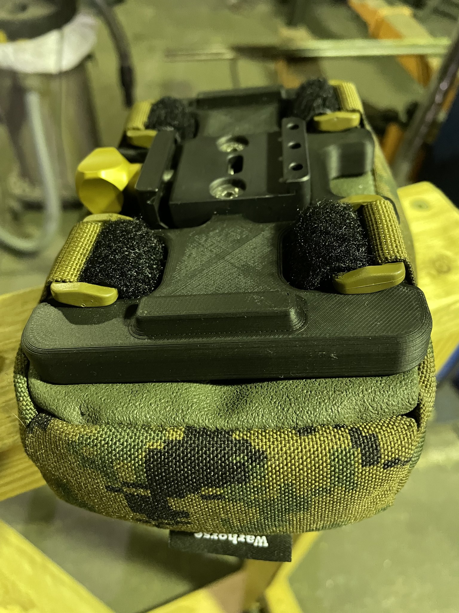

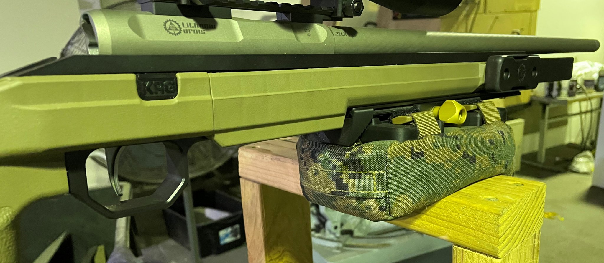

I 3D printed a plate to fit an Area 419 clamp and use a little Warhorse Developments bag on it. It was supposed to be just to try it out before machining a proper one up but it worked so well I didn't bother changing it. I use a waxed canvas Shmedium most of the time but this definitely has its place depending on what you're shooting off.

I know this is old, but want to print one like it. How did you screw the clamp into the plate? Just directly threaded into it, or added other threaded nuts? And if nuts, how were they mounted into the 3d printed plate? During printing or afterward?

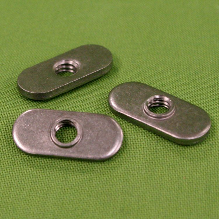

I designed it to use some M5 sheetmetal spot weld nuts, there's a recess in the bottom for them to sit into. 3/16 UNC would be around the same size.
You can download it at https://www.thingiverse.com/thing:5867111
