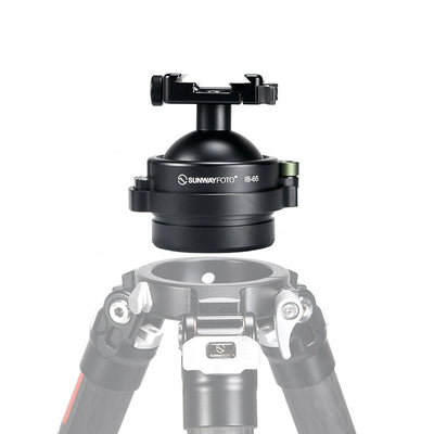

B y r o n Private Full Member Minuteman Nov 8, 2004 1,110 766 Western Kentucky Mar 6, 2024 #5 Mar 6, 2024 #5 I went with this unit from Sunwayfoto. I tend to go for things that are over engineered. Load capacity on this unit is 66 lbs. and handles Arca and Picatinny with a throw lever clamp. I run it on a Leofoto SO tripod. Your tripod will need to accept 75mm bowl fittings.
