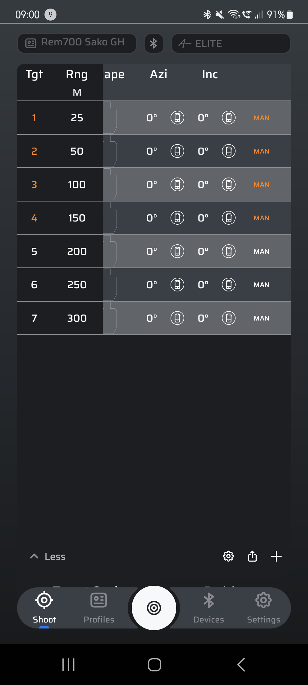

Has anyone tried the new Lapua Ballistic App? I skipped the email login but was still able to create basic cartridges and rifles etc. I would think that their ballistics is close to good. The main screen on the app has option for windcalls/corrections. There were options for moving target etc. I will be playing with this more soon - I'm just wondering if it's a brand new option or if it has been released already and I just missed it.
The 6DOF bits only apply to Lapua projectiles, which they have data for. In practice, this means accurate spin drift calculations (significantly more accurate than Litz's formula, which everybody else seems to use), and accurate predictions of transsonic stability.
Other than that, it is just as precise as any other serious app out there; given the same inputs they all give the same results down to a rounding error close. The difference is made by the interface / personal preferences (I quite like Lapua's -- most operations are on the same screen), and the availability of custom drag profiles for transsonic onwards -- Lapua for Lapua, Hornady for Hornady, AB for most else.
This said, Lapua's app seems to be a bit more battery-hungry than the others.
Most excellent review Sir - thank you for the input. I'm moving forward with it as a base.

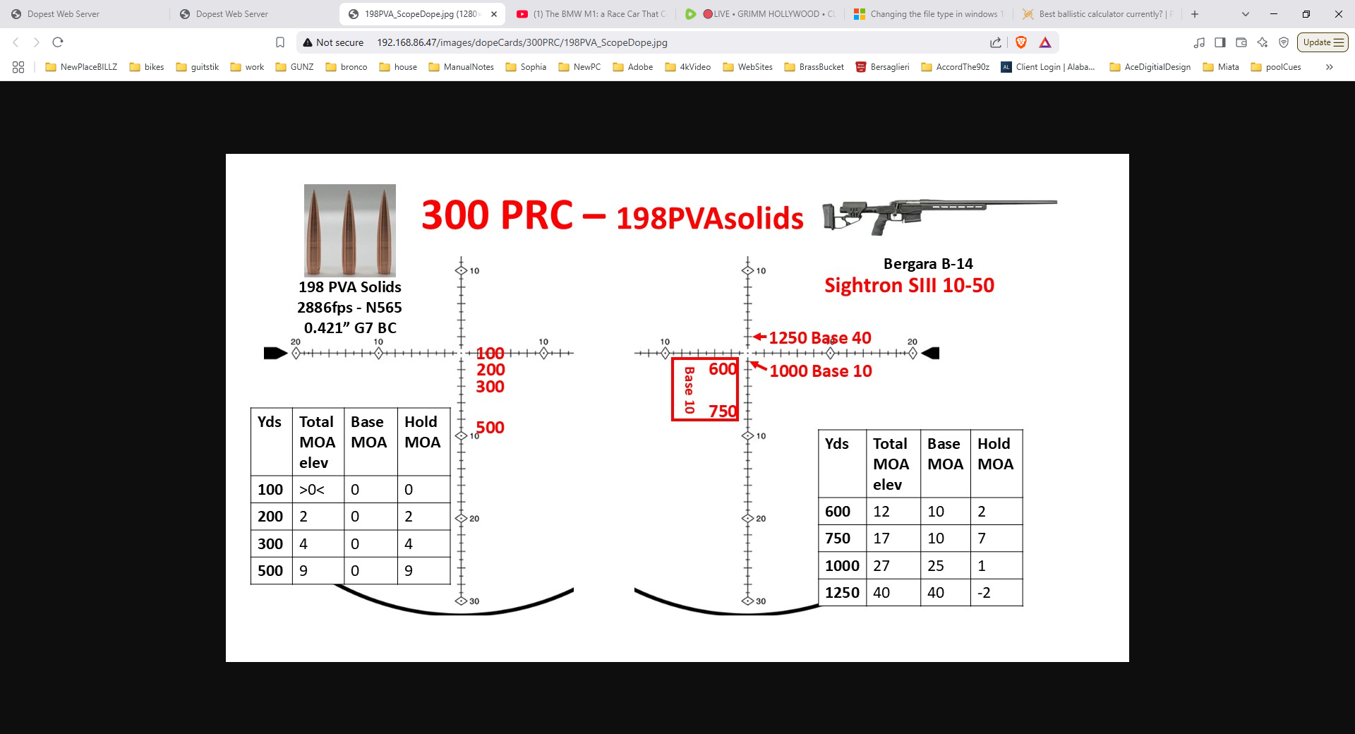

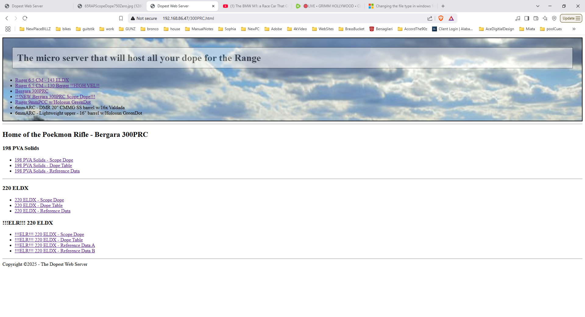

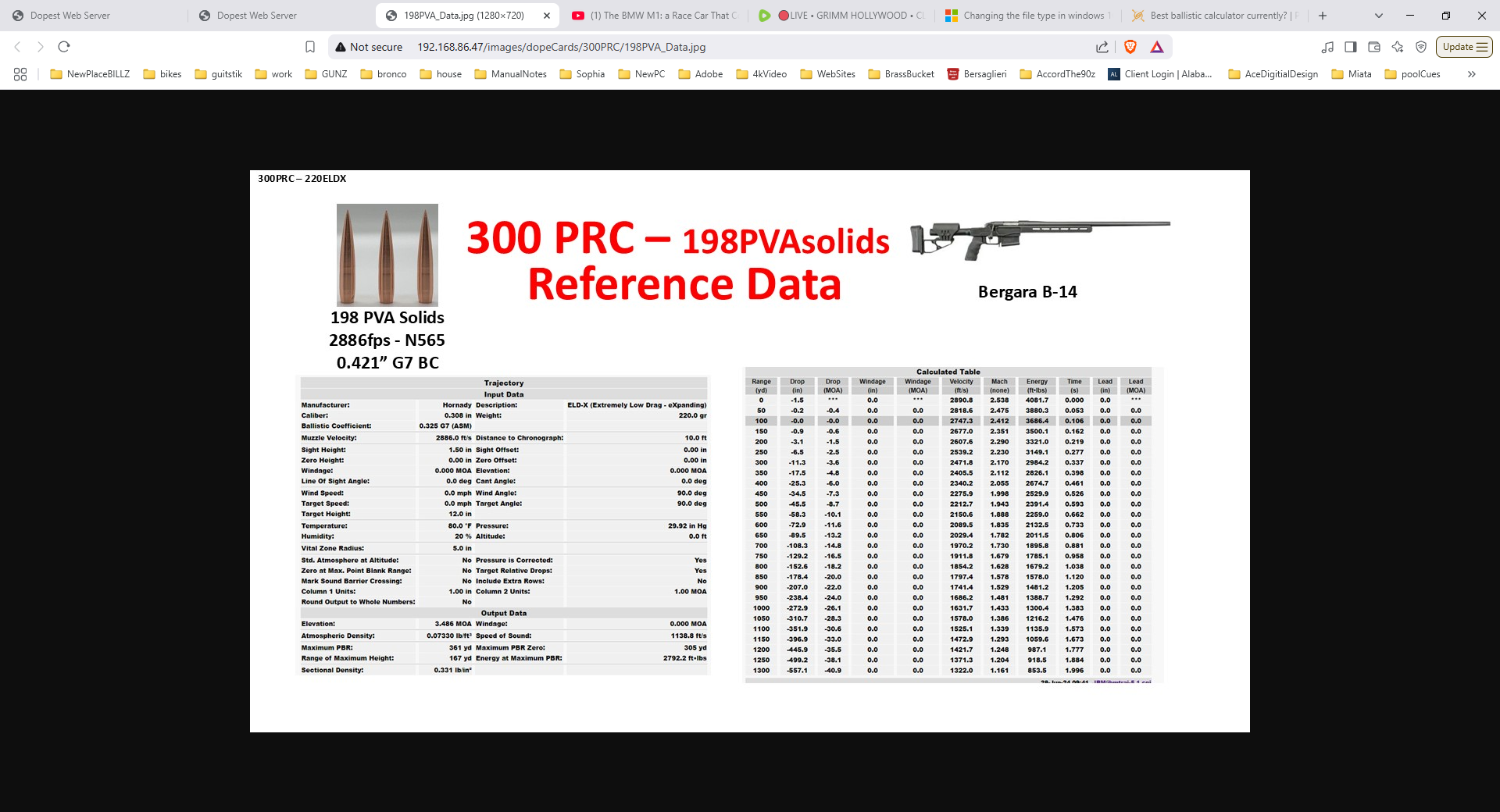

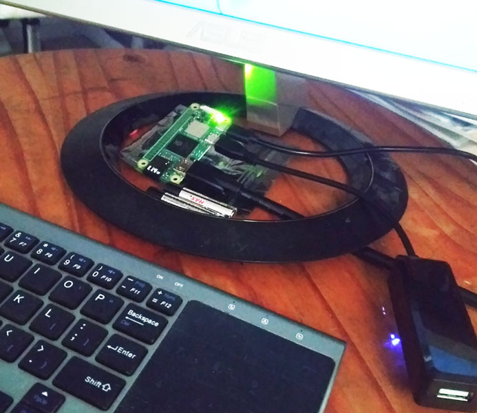

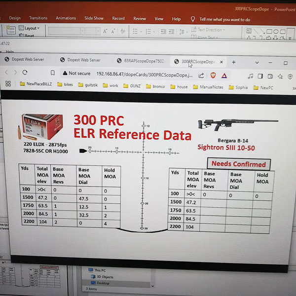

I have some Adafruit Microcontrollers on the way and may be using them as an Ubuntu/NGINX web server to host HTML pages of Dope via Wifi when I get to the range - Thuper-Nerd-Thit...
...waiting for my new 6.5 barrel to get here to start loading and put into the Lapua BC.

Great data and reading... My microcontroller adventure continues, to wait for more parts - proper voltage power supply.
