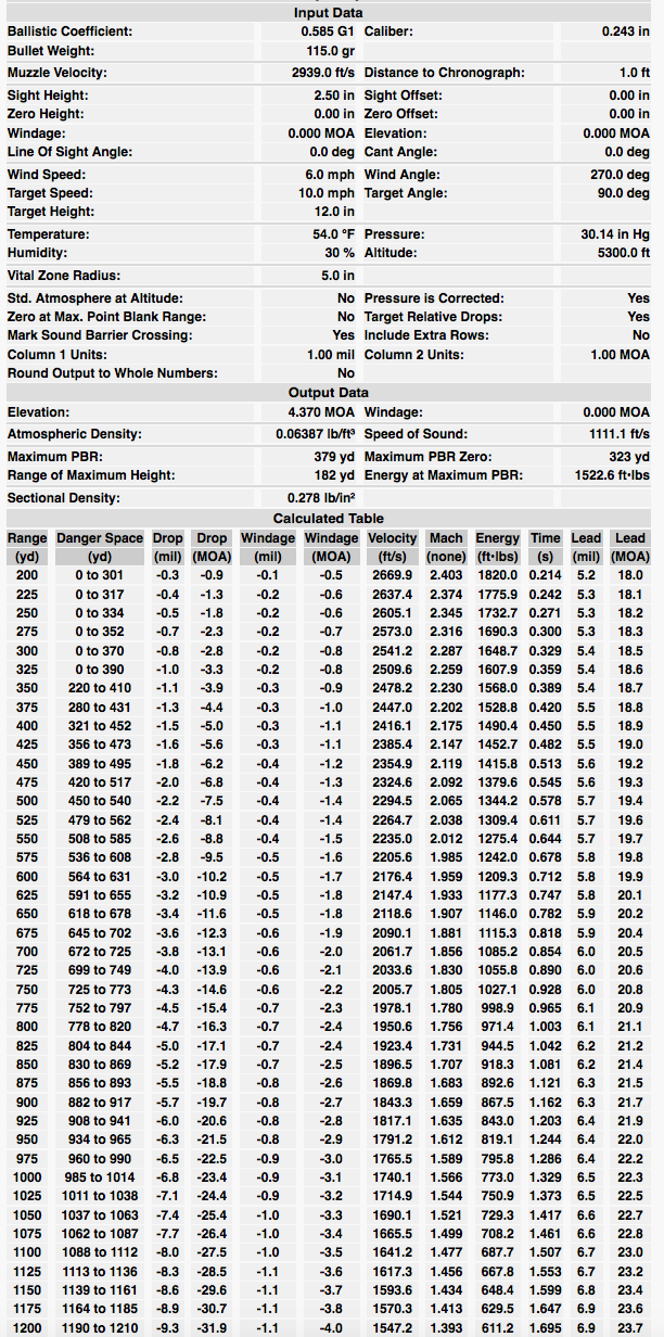

Thanks for your reply Frank, sorry I posted in wrong section, please move if needed. I will post two photos, one of a handwritten set of ranges (drop in mil first, wind second) from a match, all of the drops I feel are accurate (note I didn't hit all the targets but the ones I missed due to drop I corrected the drop to what I thought was correct), the second is output from Ballistic AE (drop in mil is second column). Bullet is 115 DTAC (old not new) at 2939fps, sight height 2.5", zero atmosphere 54.5 F, 19% humidity, 5276 elevation, 30.014Hg. You can see they are pretty different. Looking forward to more advice, thanks.
You inputs don't look like mils at all, I think it's a bit of operator error in there,
Can you post your input page(s) as this is all messed up from what I am looking at, as nothing is matching up
Example, 300 yards, .57 mils ?
A 300 yard dope would be like .8, here is a JBM that is actually right

Your turrets are set at (1.0) value is that maybe a (0.1)?
Both calculators I use its (0.l)?
The 0 hight is that center of scope above bore or something else?
It looks right,
You need to list out the ranges in an order you can understand and then see how it matches up.
Part of it appears to be the angles, if you look at the sheet for everything in the 600+ ranges you have longer ranges with smaller numbers. It’s either a range issue or angle issue. You really need to figure each location out as similiar ranges have different actual values.
That these ranges every app will give you the the same answer, it’s something not app related as they are short distances. I would use a 100 yard zero too, but the numbers are pretty close. At 400 you have 1.5 but your app say 1.3 that .2 should not be a miss with a 200 yard zero. The JBM numbers look pretty darn close based off 100 yards.
