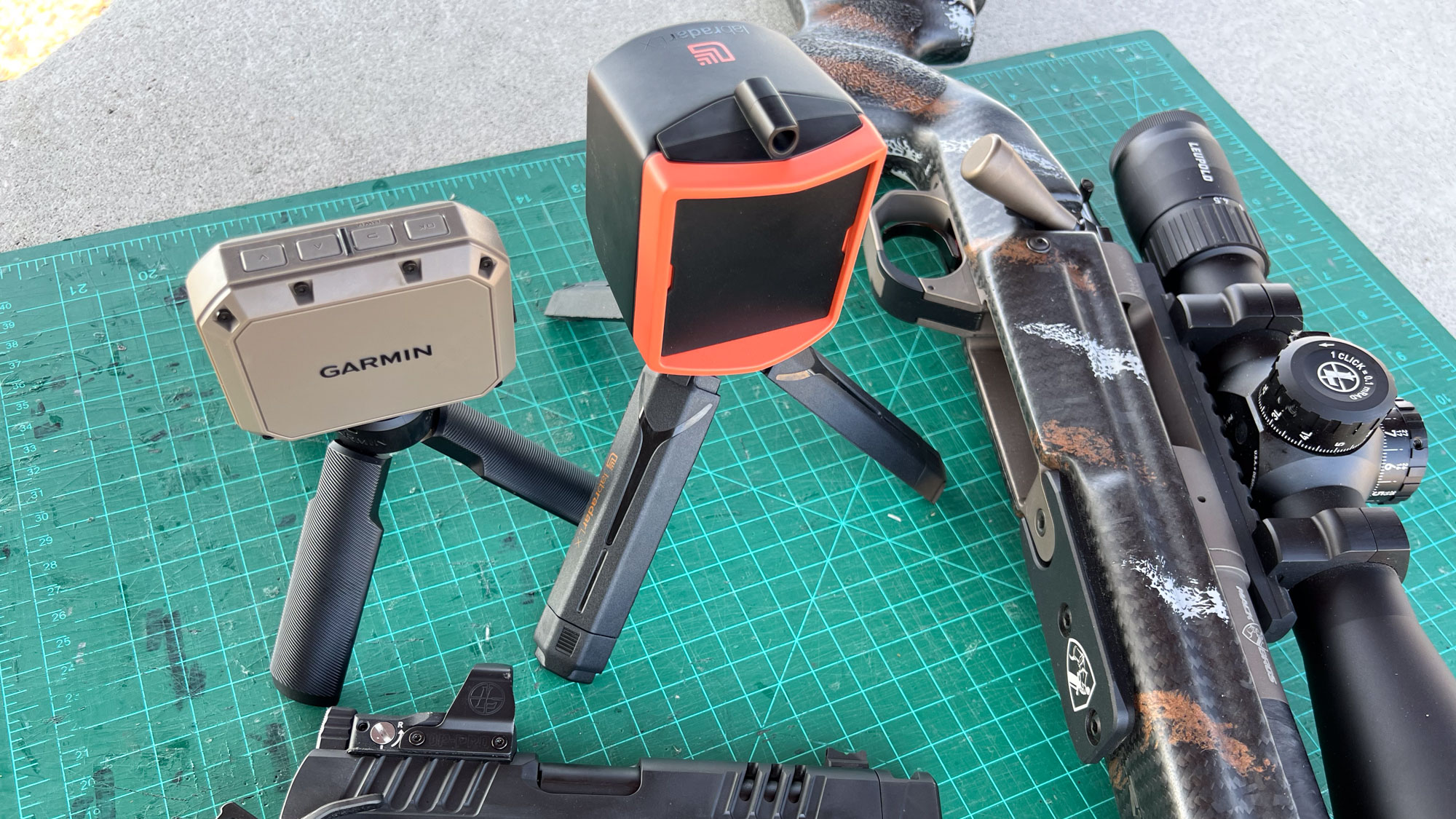

I want to say just suck it up and get both honestly. Both are so valuable for different reasons.
Garmin: Aside from just getting velocity data, being a testing tool and seeing how well reloads/factory ammo is shooting velocity wise it can be a great tool for trouble shooting/identifying an issue.
Story time: I had an issue this past season where 80 or so rounds in my barrel would spike 30-40 FPS, zero would shift slightly and I’d start hitting high. This first appeared in July at the THS match in SD and I was chonoing every prone stage until it settled. I wasn’t able to trouble shoot it from then to the PRS finale, (due to unfortunate family life circumstances), and it hurt a lot more this time, but I was able to keep up with it due to the Garmin. Since then I’ve been able to test and talk to a few folks like Buschman and found the problem. It wasn’t a carbon ring or anything like that.
Kestrel: valuable piece of kit to update environmentals in apps like 4DOF if you don’t use the ballistics on the Kestrel, get wind values, and true up both velocity and BC if you need to. Additionally, you can use it to “tune” yourself on what certain wind values feel like.
Both are valuable for their own reasons.
Being at the competition you can always ask to borrow someone else’s Garmin, but it’s a little more awkward to ask to see someone’s Kestrel to update your l app since some folks use it as their solver. So if I haddddd to pick one it would be the Kestrel first and the get a Garmin later.
Just because no one has said it yet, the Labradar is overpriced, obsolete, and unless you just love finicky, unsupported technology that delivers esoteric data, shouldn’t even be a consideration.
I'll be renting out the use of my 5700 and Xero at the next match. $6.89 a stage for a target card, plus a flat rate of $13 to hold your gun profile for 32 hours. $4.50 to have the targets pointed out using my Binos with a 2 min max observation period. I'm going to have to have a $600 damage deposit in case you change my tripod legs and I find you caused it to blow over in the wind or come down with pink eye later. $20 to borrow the Xero during "sight in" but that will go towards any additional services as a credit later in the match.
I read a review where it sounds comparable to the Garmin, but a little slower and not quite as user friendly.
I guess the previous “spend a fortune and then if you want it to work you also have to buy a stand, a battery, a trigger, and a drinking straw” experience left a bad taste.
