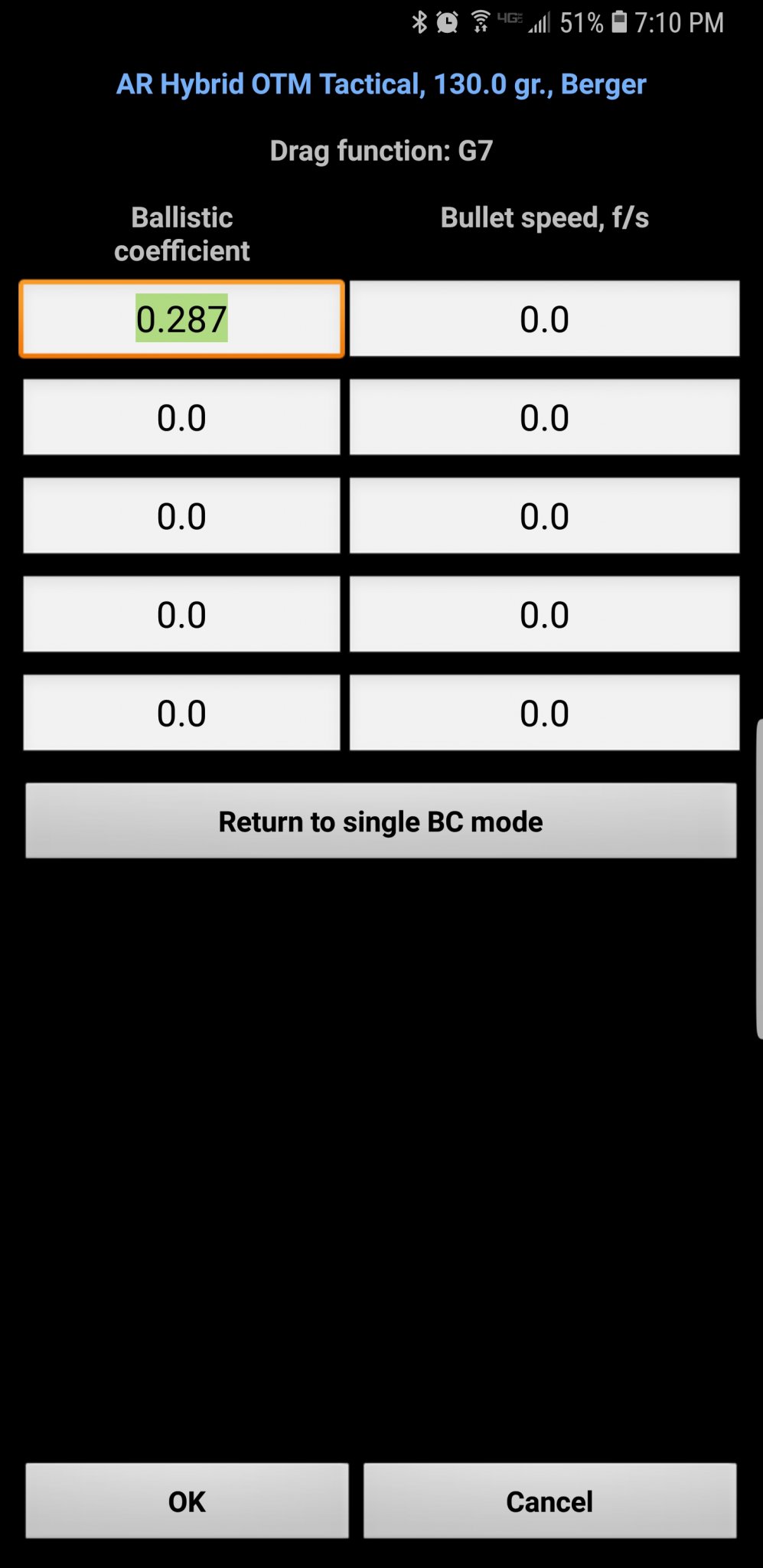

Strelok can do this. Just click "multiBC" under cartridge selection.
