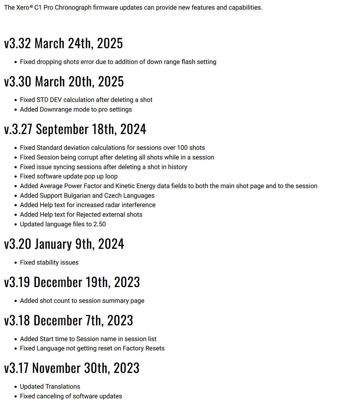

Mine missed 13 out of 60 shots with v3.30 a couple of weekends ago. With v3.32 last weekend it picked up all but 1 shot out of 50.

Shot two strings Saturday with 3.32 > Rifle > 1700-5000fps; 103gr 6mm bullets avg ~2880fps. C1 captured 32 of 34 in string 1 and 21 of 22 in string 2. Device placement consistent with prior sessions enjoying 100% capture of rounds pre 3.30; all shots from static bench location. Would really like to have my original C1 back.

Had mine out for the second time on v3.32. Shot 6 strings totaling 80 shots yesterday and did not drop a shot. Last trip shot 90 and it got all those. Really weird the inconsistancies between users/devices. I dropped a couple on 3.30, but 3.32 has been perfect for me.
I could have missed it earlier in this thread but I had mine out last night for some test rounds and v3.32 picked up all 20 rounds and I noticed there's now a "Pause Session" option in the drop-down list before you "End Session." I didn't try this feature as I was racing the sunset but am now wondering if it's the ability to Pause, upload to you phone if you choose, but then be able to go back and add to that previous session?

well, if they did then they didn't put it in the release notes which would be kind of a significant boo-boo
