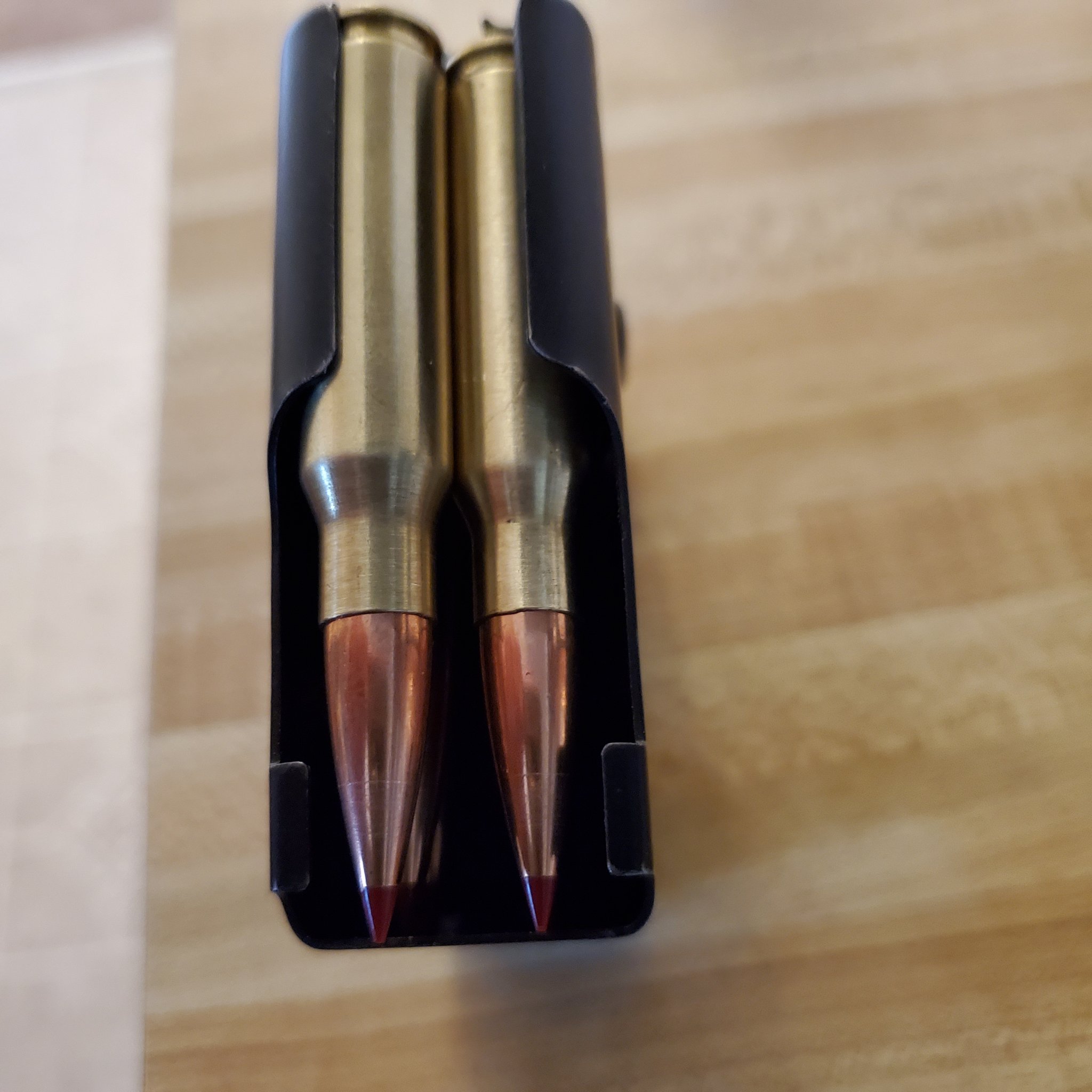

The 308 Win, of course.
Example: Magnesium upper, titanium carrier, light fluted barrel, 6 lb AR 10 308, with 16" barrel 168 gr ELDM 2756 fps 1/2" 5 shot groups.
155 gr 2815 to 2900 fps, pictured chronograph on rifle.
208 gr ELDM 2442 fps pictured in mag.
Light and accurate
Lighter than most AR 15s but brings more energy and velocity then my 18" 6 mm ARC with 108 ELDM at 100 fps less, and similar BC values .536 for 6mm vs .523 for 308. And the 308 has 2" less barrel, and 100 fps more velocity.
I like my 6 ARCs but the 308 has better ballistics.
And incase one happens on a Grizzly bear the mag full of 208s at 2442 fps will handle that situation too.
