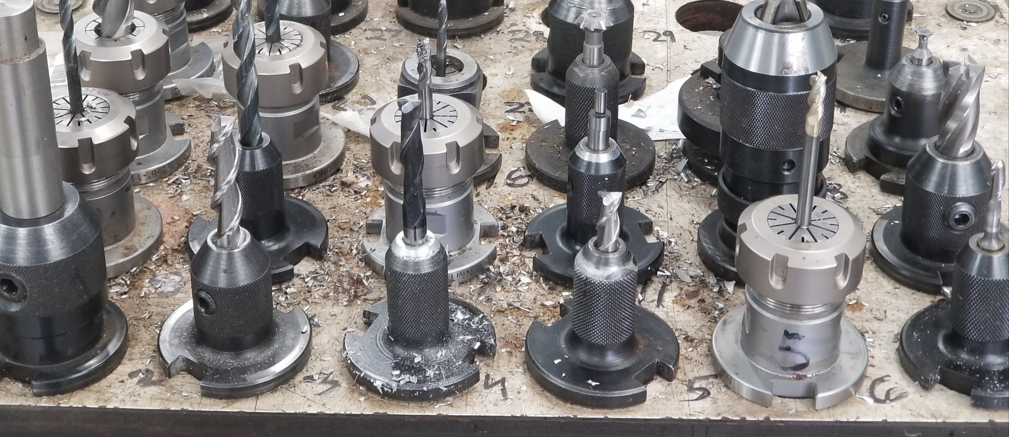

The holder #5 on this toolcart has the TiN coated Mori 3 flute in a er holder "choked up" enough to just cut the pocket I needed

The holder #5 on this toolcart has the TiN coated Mori 3 flute in a er holder "choked up" enough to just cut the pocket I neededView attachment 7017472
