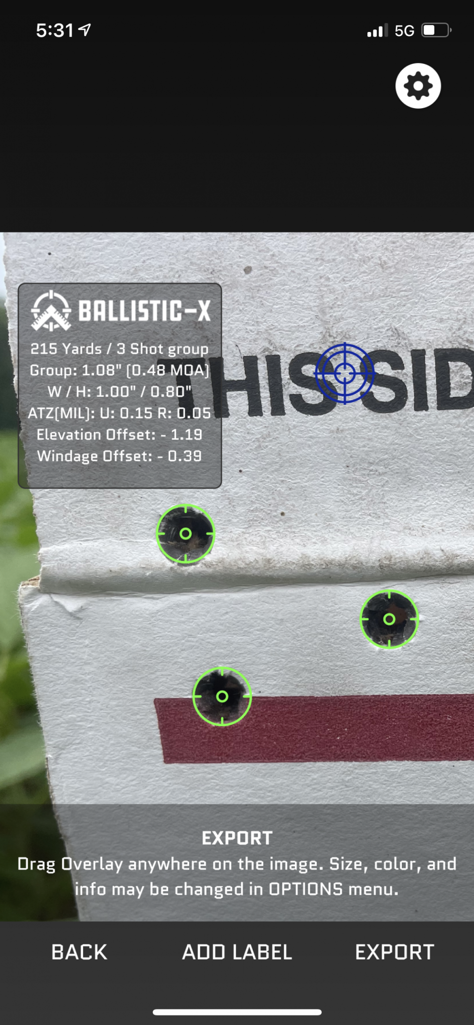

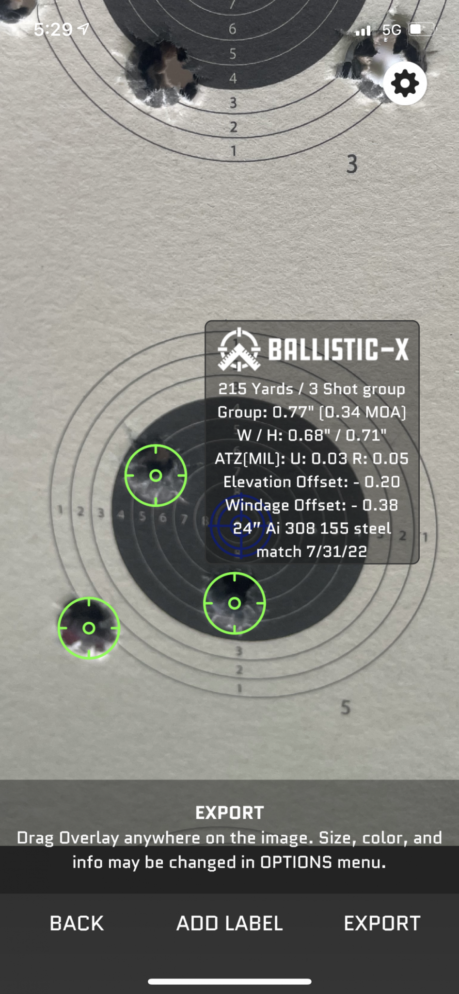

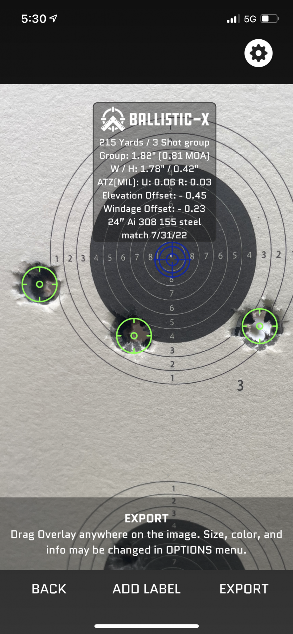

Here’s some crappy groups shooting 155 hornady steel match 308 through a used unknown round count barrel I picked up used. 200 yards. I’m a terrible shot

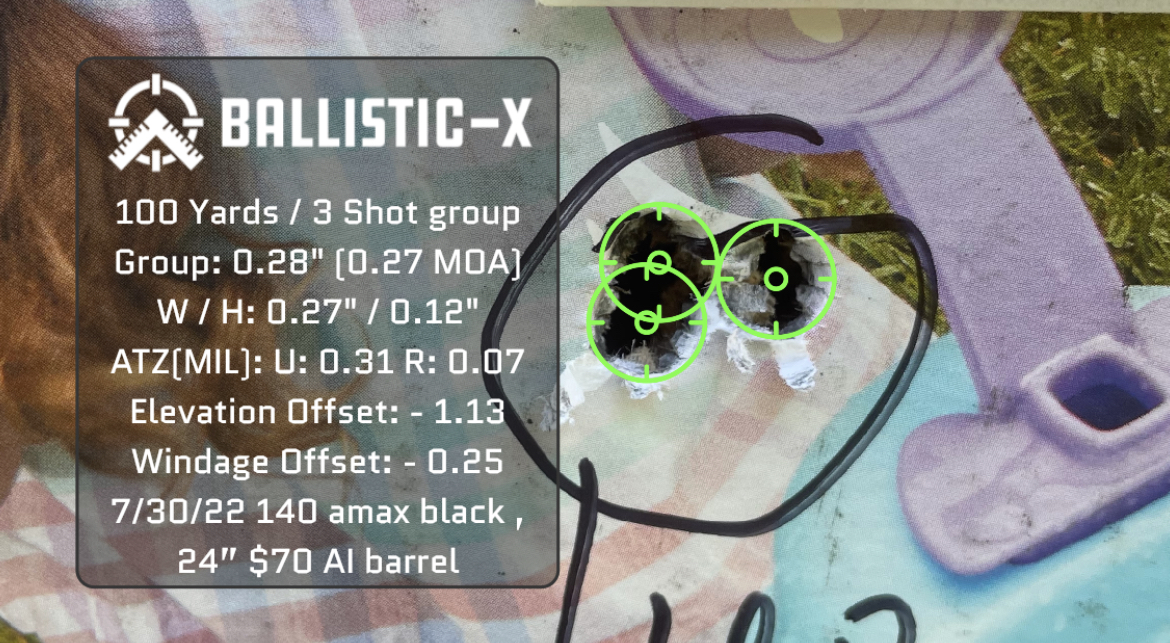

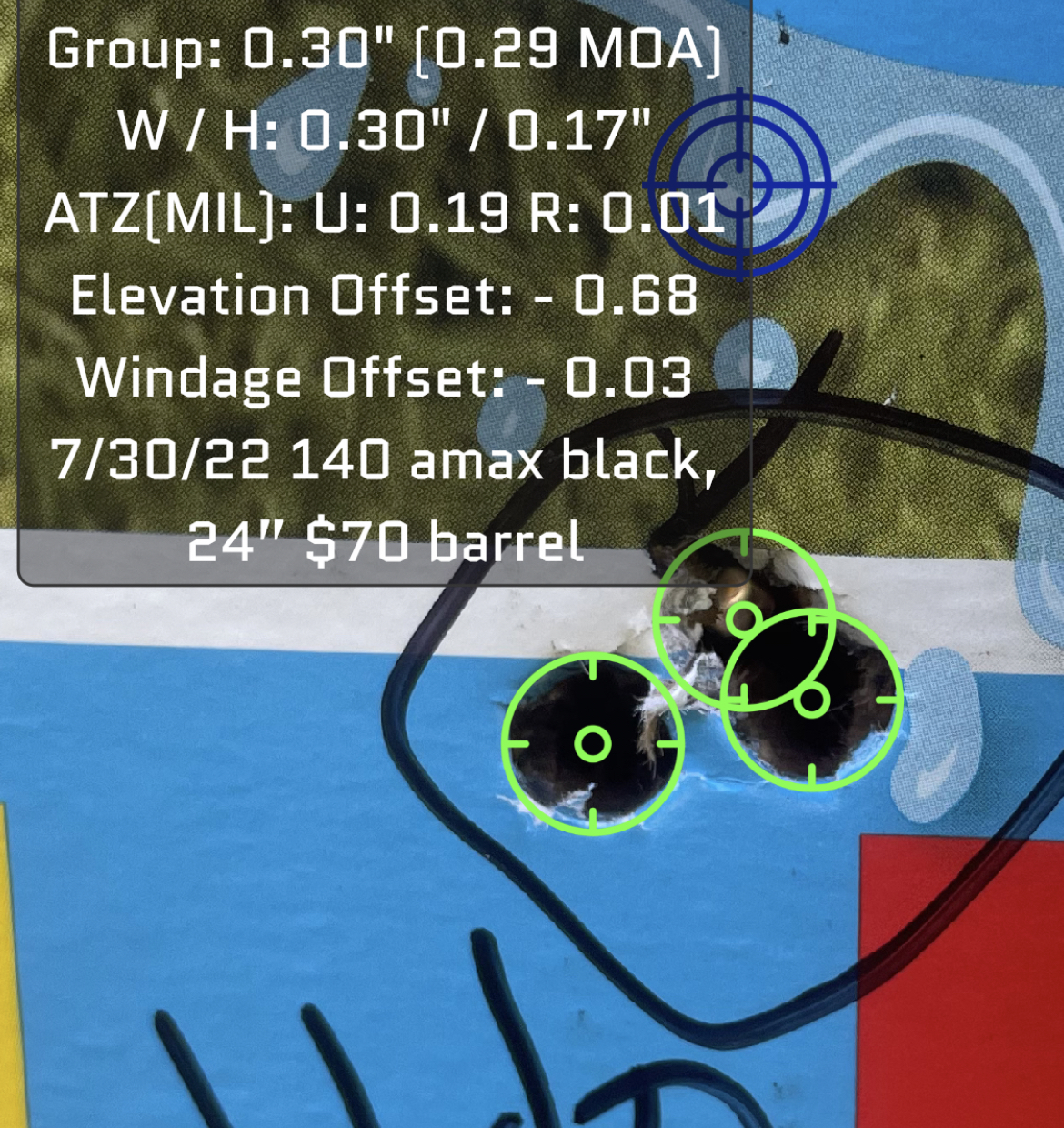

Also shot 2 3 round groups at 100 with a similar unknown round count used 6.5cm barrel. Wanted to see if worth cutting down to 18”. Shot exceptionally well with hornady 168 amax.

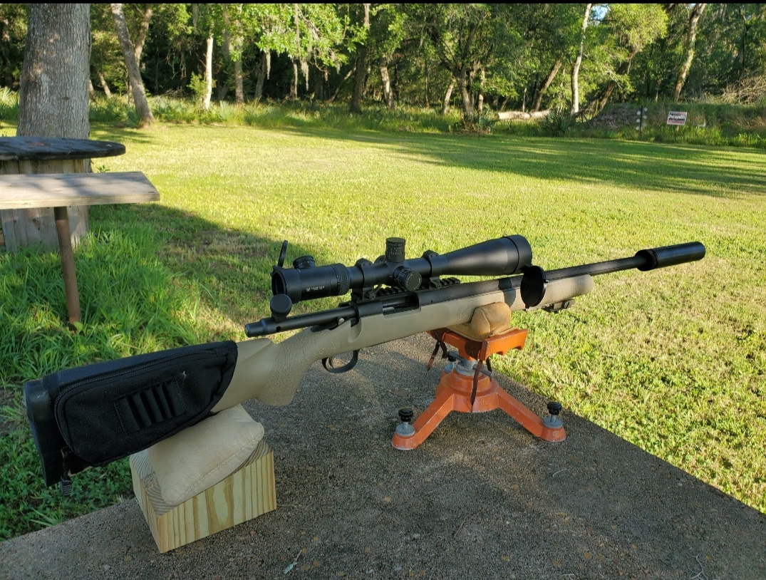

These two groups are a year apart. FGMM 168, 100 yards. Only four shots in the top one because the first round was a sighter after mounting the scope. Next four all in the same hole. Rifle is a 700LTR, 20" barrel with a 1:12 twist. I've considered rebarreling it with something faster a half dozen times but the way it shoots I just can't bring myself to pull it apart.
