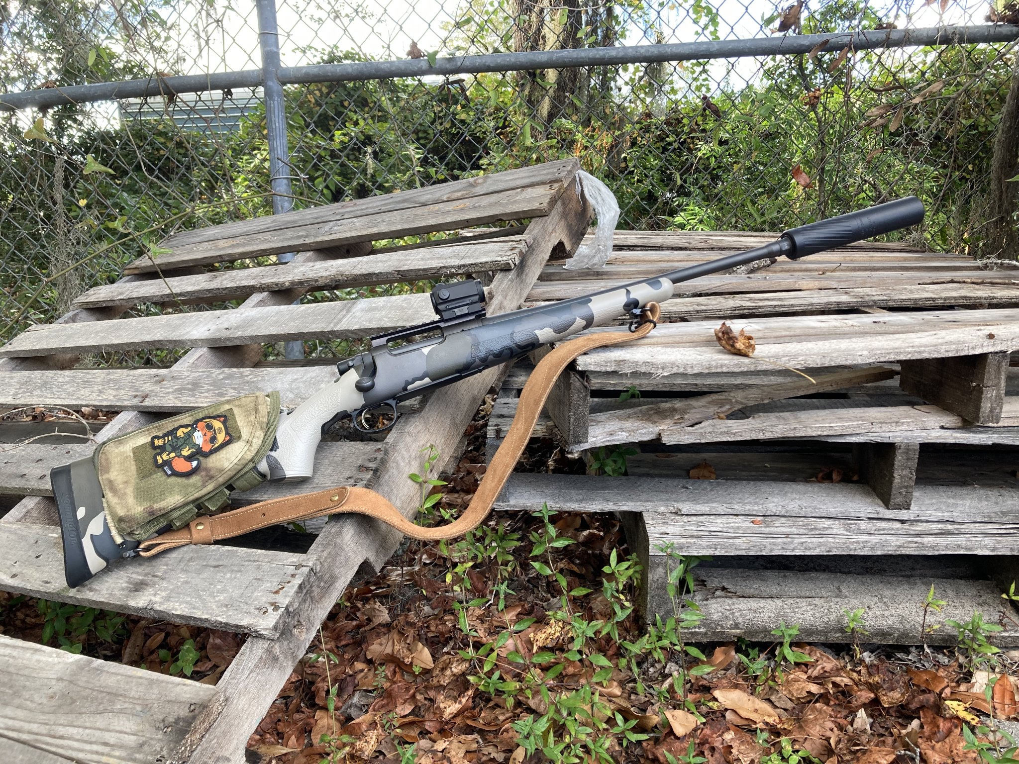

    I’m running a 6.5 PRC 20” with Ultra 7 with 156 Berger’s.
    Safe load at 2705MV
    6.5 PRC not the greatest with heavies and short barrel.

    Great looking gun. Are you happy with the 20" or do wish that you had gone shorter?

    Happy with my 20” would not go any shorter since I like to shoot heavies. Plenty of down range energy for white tails 500yds and in. Originally was going to use it for larger game as well but after finding the velocity was not there I decided to build a big bore light weight 300NM to take care of that. It is just a good excuse to get another gun!
