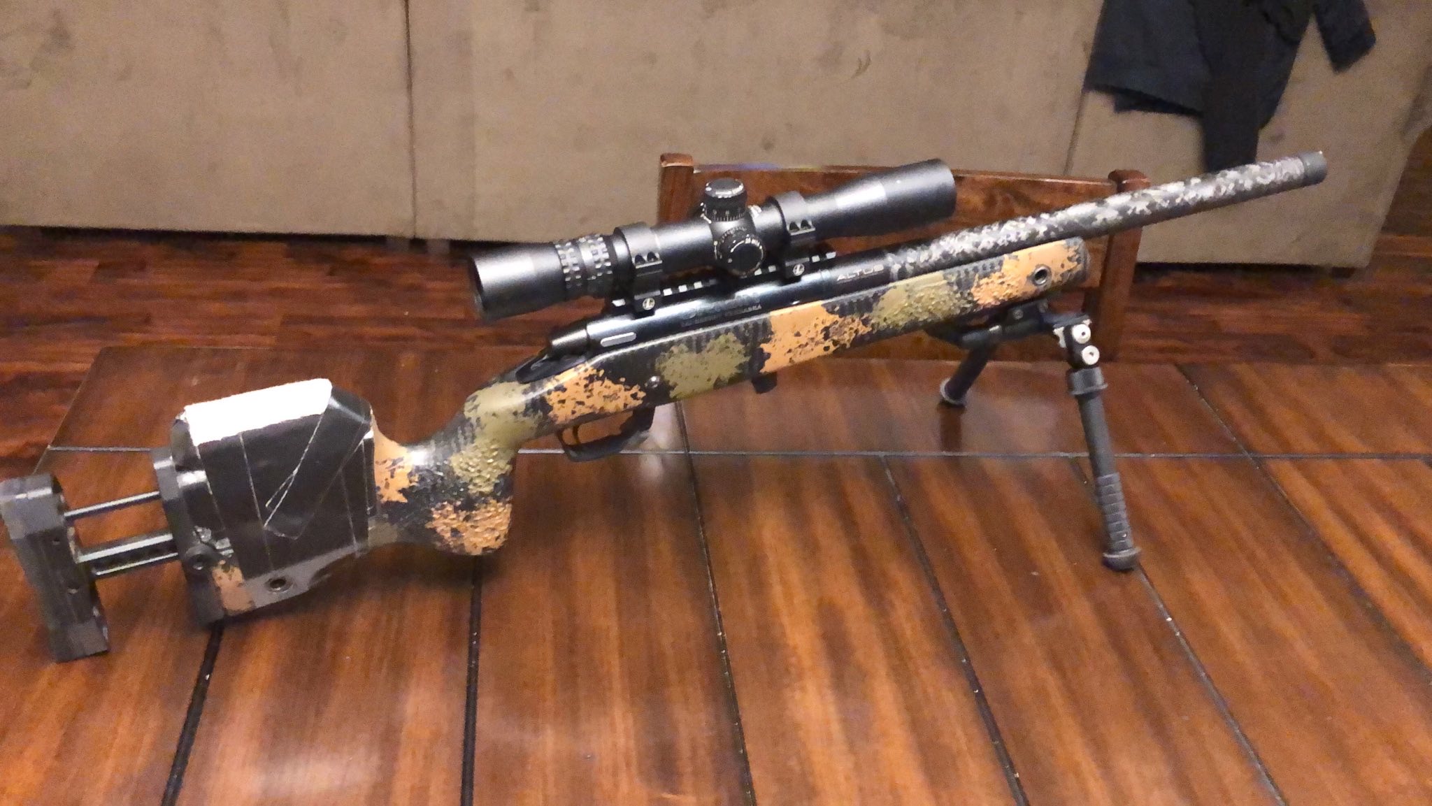

I have a 6.5 Prc at 21” that I run 156s at 2940 Bartlein barrel
A 21” 300 wsm that I run 200 eld x at 28xx Bartlein barrel
A 21” 7mm STW that I run 175s at 2900 which is a light load. Bartlein barrel.
22” 22 creed. 75s at 34xx. Carbon 6
16.5” 22 creed. 77s at 31xx. Factory bergara
16.5 308 155s at 2750 ish proof.
A 18” 223 AI. Bartlein
And a mk 12 and a variety of other shorter ARs
My Lapua. My GAP 10 6 creed. And my sharps are the only rifles with over 22” and they annoy me now lol.

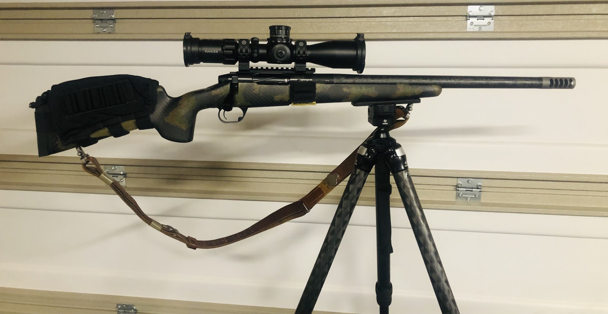

6.5CM or 308. 500 yards is easy money for either one. Built my daughter a 16.5” 6.5CM and I’m running a 20” 308. Ammo for both is plentiful. I personally went with the 308 cuz it’s hits a bit harder than the 6.5 at those ranges but either one will serve you well
20” 308
16.5” 6.5CM
