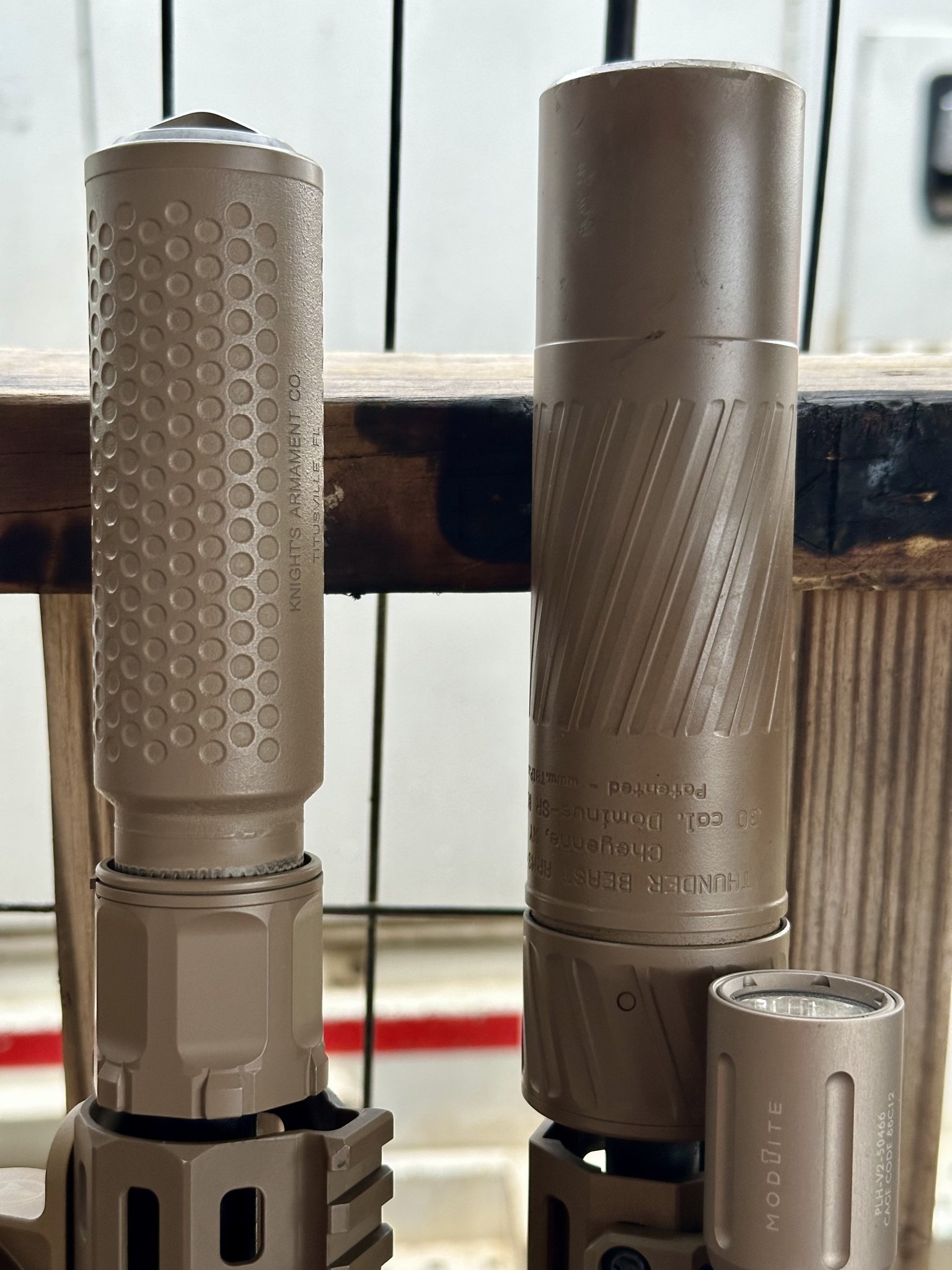

    For academic purposes, this is what’s going on a factory 11.5 SR-15:

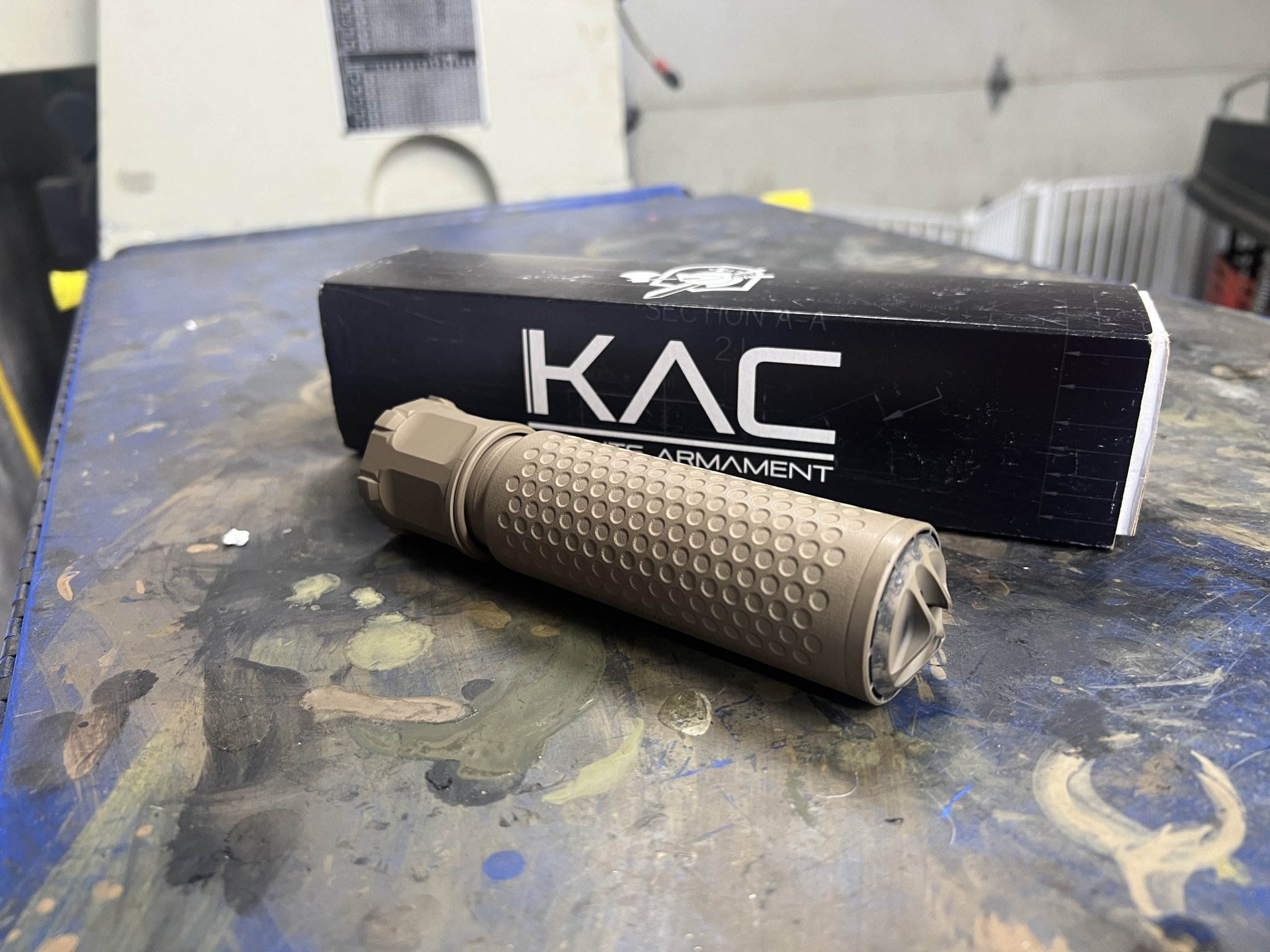

    Use at least 0.075 of shim when you install the 3-prong if your 11.5 is a Mod 2/10.5" URX4.

    Care to lift up her skirt, and show me that blast baffle? 😉
