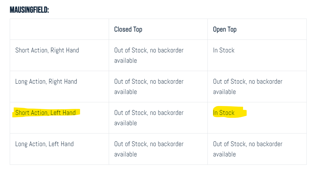

Have you checked with ARC to see if they have any Mausingfields left? According to their "lead time" sheet, they do have LH SA open top Mausingfields left:
Reactions: Cody S
