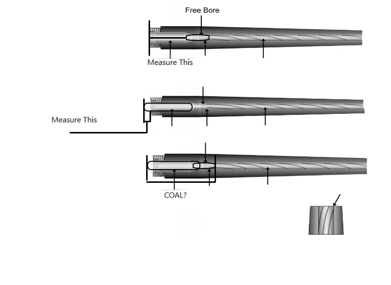

My preferred method is very different than the video, and doesn't require any disassembly of the gun but is at least as accurate IMO. The only special equipment needed is some sort of collar on your cleaning rod that can be locked in place.
I close the bolt and run the cleaning rod in from the muzzle with a flat-tipped brass jag. With the jag against the bolt face, lock the collar on the rod right up against the muzzle.
Then, to measure distance to the lands for a bullet, seat a dummy round long so the bolt won't close. It doesn't matter how long, but you shouldn't be able to cam the bolt down. Hold the bolt in place by hand so the bullet is pushed against the lands gently; you can use rubber bands if preferred, but don't force the bullet into the lands hard.
Now run the cleaning rod back in so the jag touches the bullet tip, and measure with calipers between the muzzle and the collar; that's your OAL to the lands for that bullet. At that point I like to seat the dummy round deeper to match that measurement, and keep it in the die box for reference. Once I have that, I prefer to use a base to ogive measurement from that dummy instead of OAL.

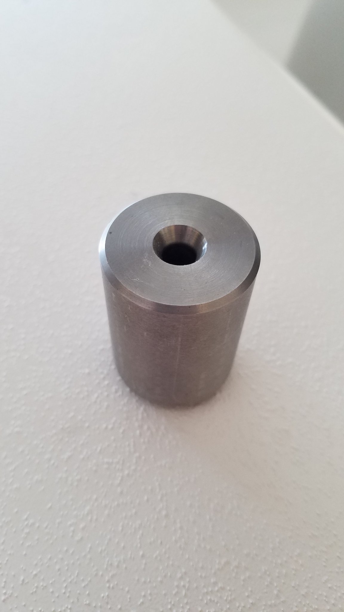

I like to use a barrel stub with the reamer ran in where the shoulder begins.
Insert a cartridge that has been fired in your chamber, partially neck sized only, with your chosen bullet.
If you can rotate the cartridge, it's touching. Move the bullet inward until you can rotate.
The stub will leave marks on the bullet from land contact so you will know how far to move it.

That's definitely a consideration, with two things to do about it -
1 - Don't jam the bullet into the lands, just press it lightly and hold in place. Don't push on it any harder than you'd push on your eyeball.
2 - Run the cleaning rod gently up to the bullet when taking your measurement, not carelessly like I've done sometimes. Definitely don't put the cleaning rod halfway in the bore and just point it upright; tips definitely get dented and it affects the results.
However, if you do dent a tip, it doesn't matter as long as you're measuring base to ogive instead of bast to tip. That ogive is the important dimension anyway for everything except mag constraints.
As for the accuracy of the calipers against the collar - if you're moderately competent you should be able to get within a couple thousandths or better. It's a pretty precise method, without the "adjust die, check again" system of most other methods.

The best way to measure distance to lands is by using a slit case. A slit case holds the bullet hard enough not to move but easy enough so it is not engraved by the rifling.
I leave the jag off and it doesn't touch the tip of the bullet anyways. It works very well.
No, that doesn't give you a correct measurement, if the end of your cleaning rod is threaded. You need the end of the rod to contact the bolt face, and then the tip of the bullet, but with a hollow threaded end it can either fit over the tip of the bullet, or miss it off to one side. Then your measurement is not OAL, it's to some unknown point partway down the bullet nose.
You need it to touch the tip of the bullet, otherwise this method does not work.

Maybe what I will do is pull the barrel, grab a bullet and put the barrel in a vice muzzle down. I will drop the bullet in the chamber end of the barrel. You would assume it would stop at the lands. Use a calibrated stick from the muzzle end and touch the back of the bullet. Modify the cleaning rod idea and use a cleaning rod stop to take a depth reading from the chamber end to the back of the bullet. Measure how far the rod went in. Next, take a resized case and drop it in the chamber. Measure how much of the bottom of the case is exposed from the barrel end. Add the amount of cleaning rod length to the amount of exposed case, and that should be the depth to load a dummy round.
