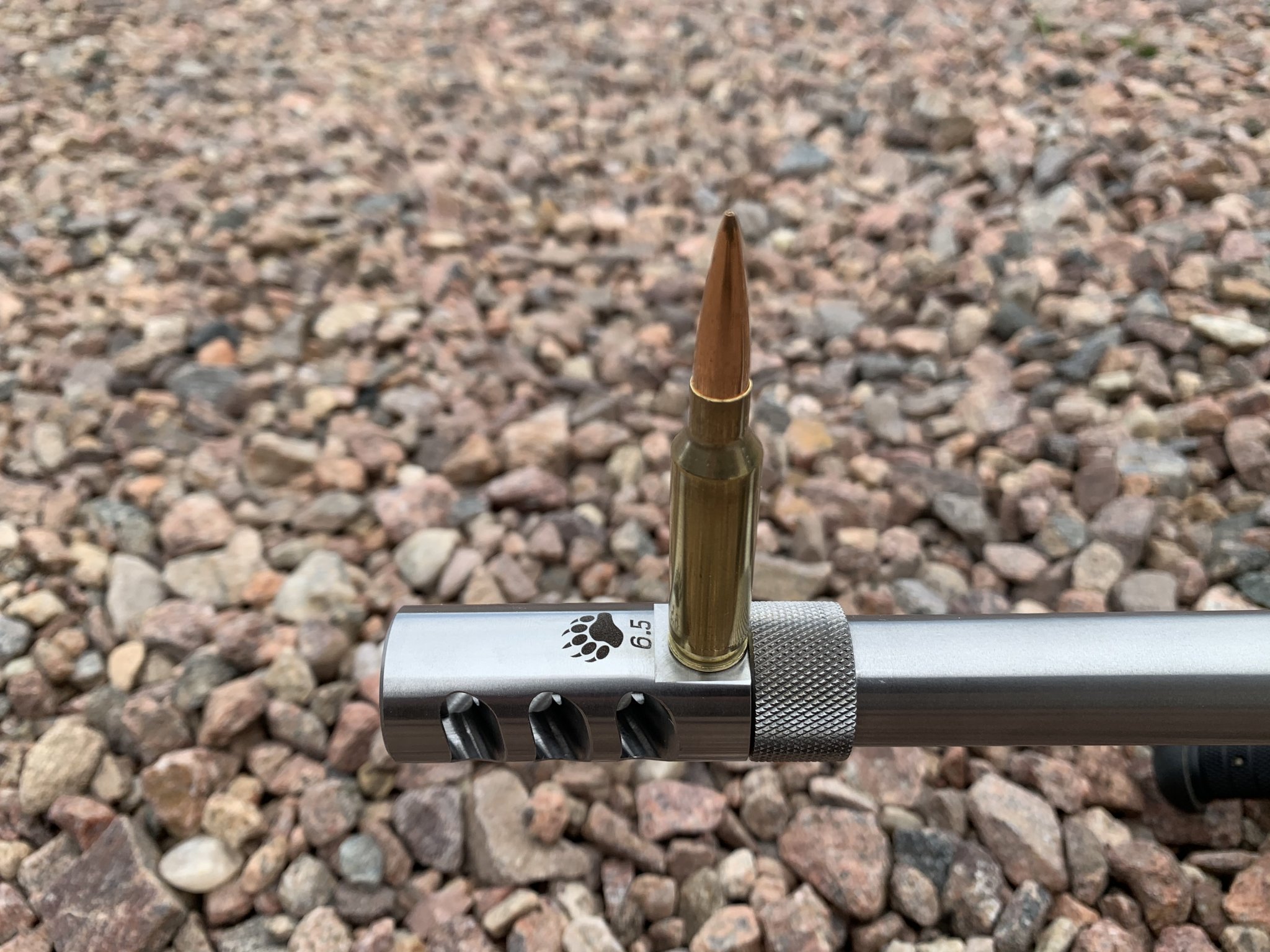

I just got one in the mail today. Absolutely great quality, no fill, as advertised.
The tactical brake (as seen in the picture) have flat ports (no reverse ports), but they are angled slightly upward to drive some of the blast upward, this pushing down on the muzzle.

So on a heavier comp rifle they have too much downward pressure? I’ve only shot them on lighter hunting rifles where that’s super desirable.
On a hunting rifle I think they’re awesome.
Recoil reduction is great with high bore center rifles.
On a rifle that already doesn’t have muzzle (or very little) rise it pushes it hard downward and I gut a bunch of weird flutter on recoil.
Put a Heathen with no vertical bias on that rifle and it literally doesn’t move left, right, up or down at all on recoil if you have a good position.
It absolutely shot nicer afterwards.
A lot major brand muzzle brakes offers some form of downward pressure. Gen 3 APAs, area 419s, tubb 5 star, Harrells, MBM, etc. Also, I haven't seen any test showing downward pressure having a negative effect on accuracy. But, I have seen test showing a positive effect for staying on target. This benefit is even more pronounced during positional shooting.

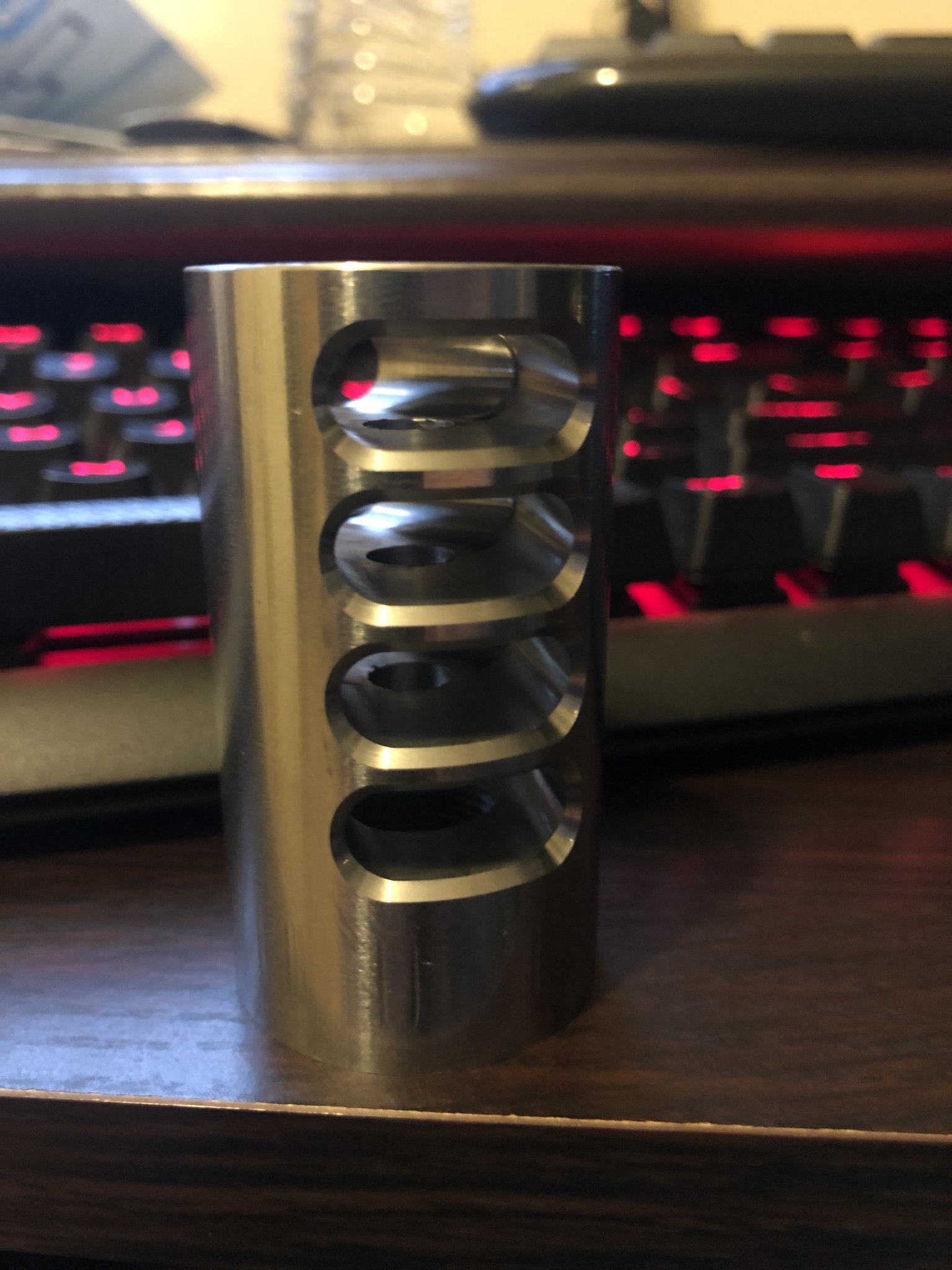

You can’t beat the performance of a 4 port beast for the cost.
