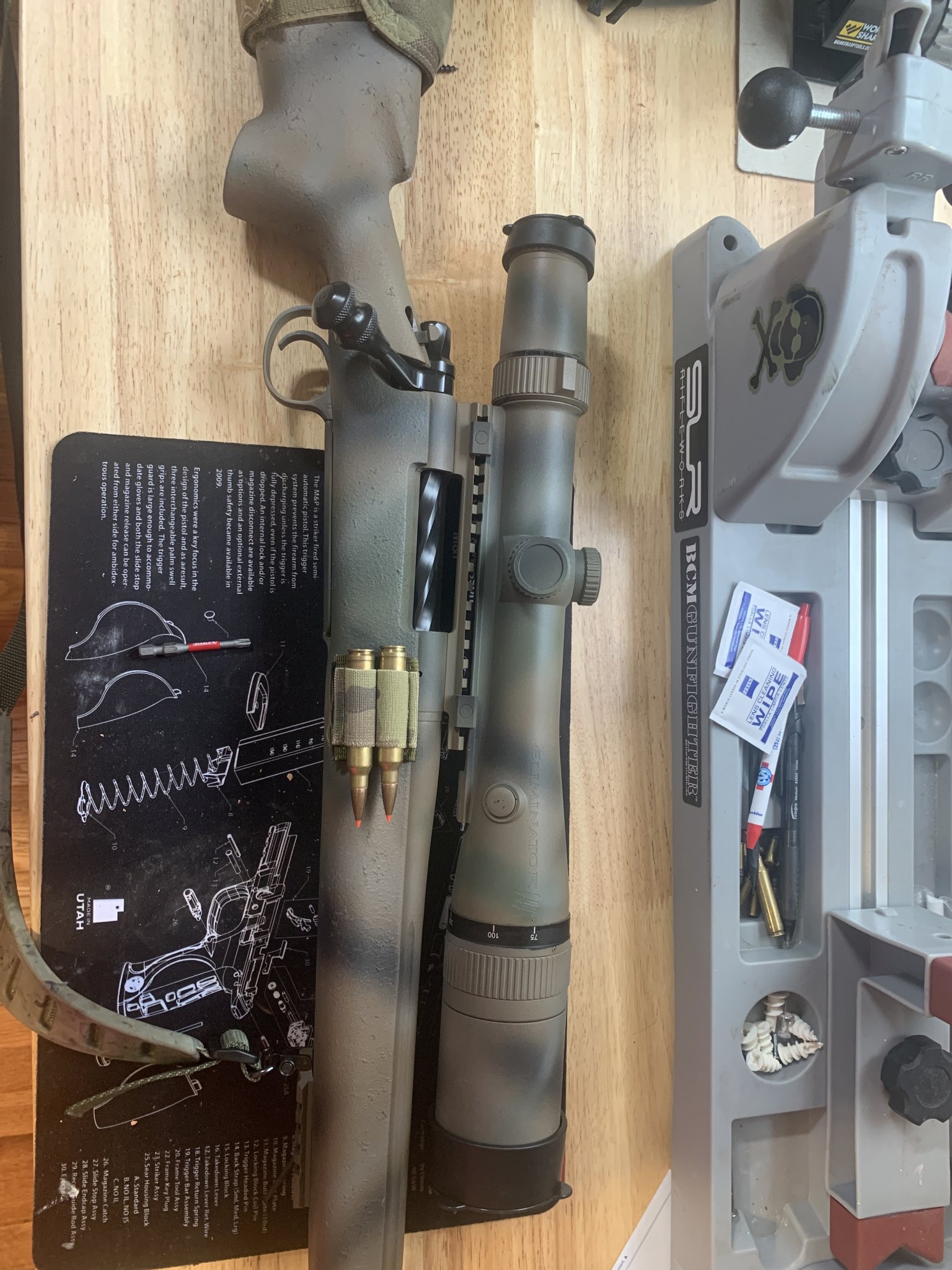

    I’ve had good results with durakote using a cheap harbor freight hvlp sprayer. 6 years later no chipping or signs of wear. Prep is key with any of it and you’ll have good results.
