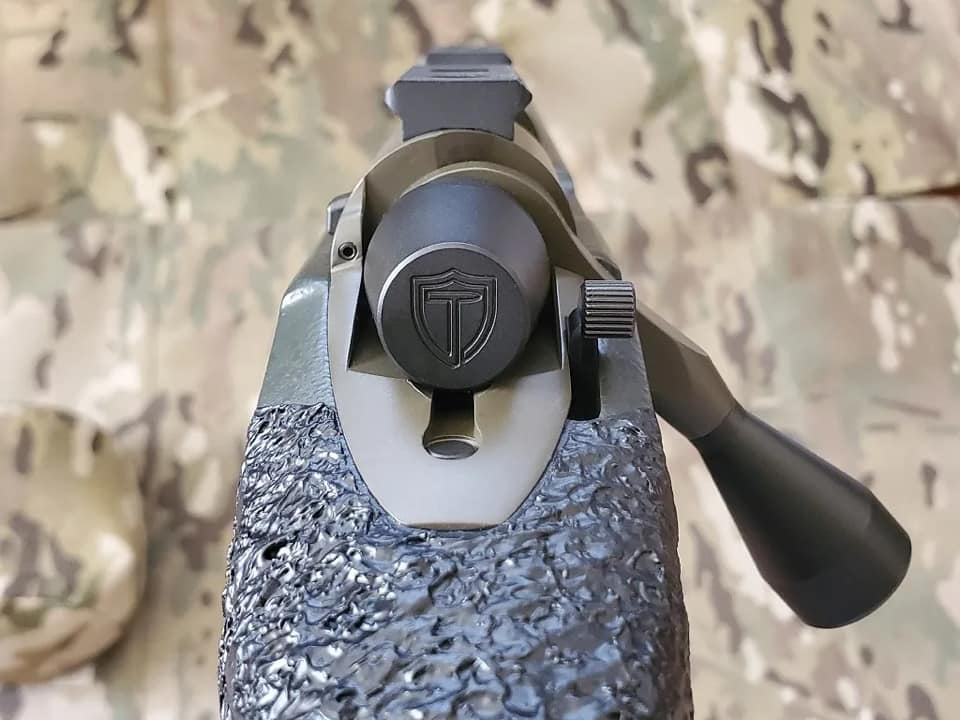

My terminus Zeus in this video and you can see the brass eject.
This version’s switch bolts between the PRC and the 308, this was a PRC shot.
I switch mags, barrel and the bolt, it’s actually going back to 6.5CM as I went through 2 cases of PRC so time to put that up. Runs like a Swiss watch

Yeah, but just a pic of the action wasn’t showing his problem. It needed to be in the stock, with a mag, preferably with a scope attached. He stated he had already decided to sell it before posting here, and he was just “wondering” if anyone else had experiences with a Terminus Apollo.
That’s a classic passive-aggressive move.
If you think its the scope and rings remove it and see how the brass ejects. Change the ejector spring to a lighter spring. Joel has to be one of the best when it comes to CS.
