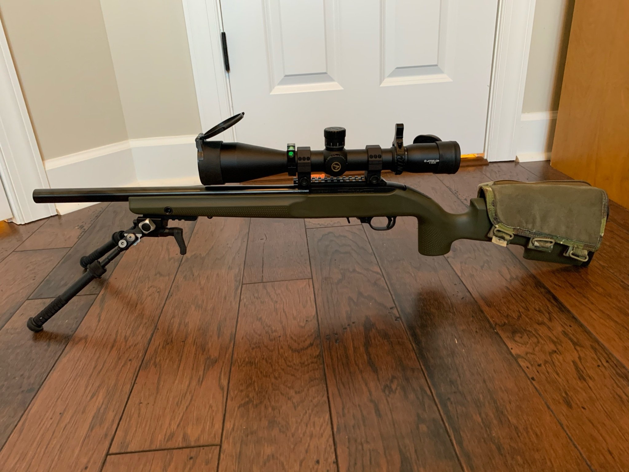

I have a CZ457 ProVarmit and a decked out 10/22 in a Victor Titan and the CZ shoots better and more consistently - both have an Athlon Midas Tac 5-25x56. 50yds with SK Standard Plus
All that said, I still want a Vudoo in an MPA chassis like my big gun.
