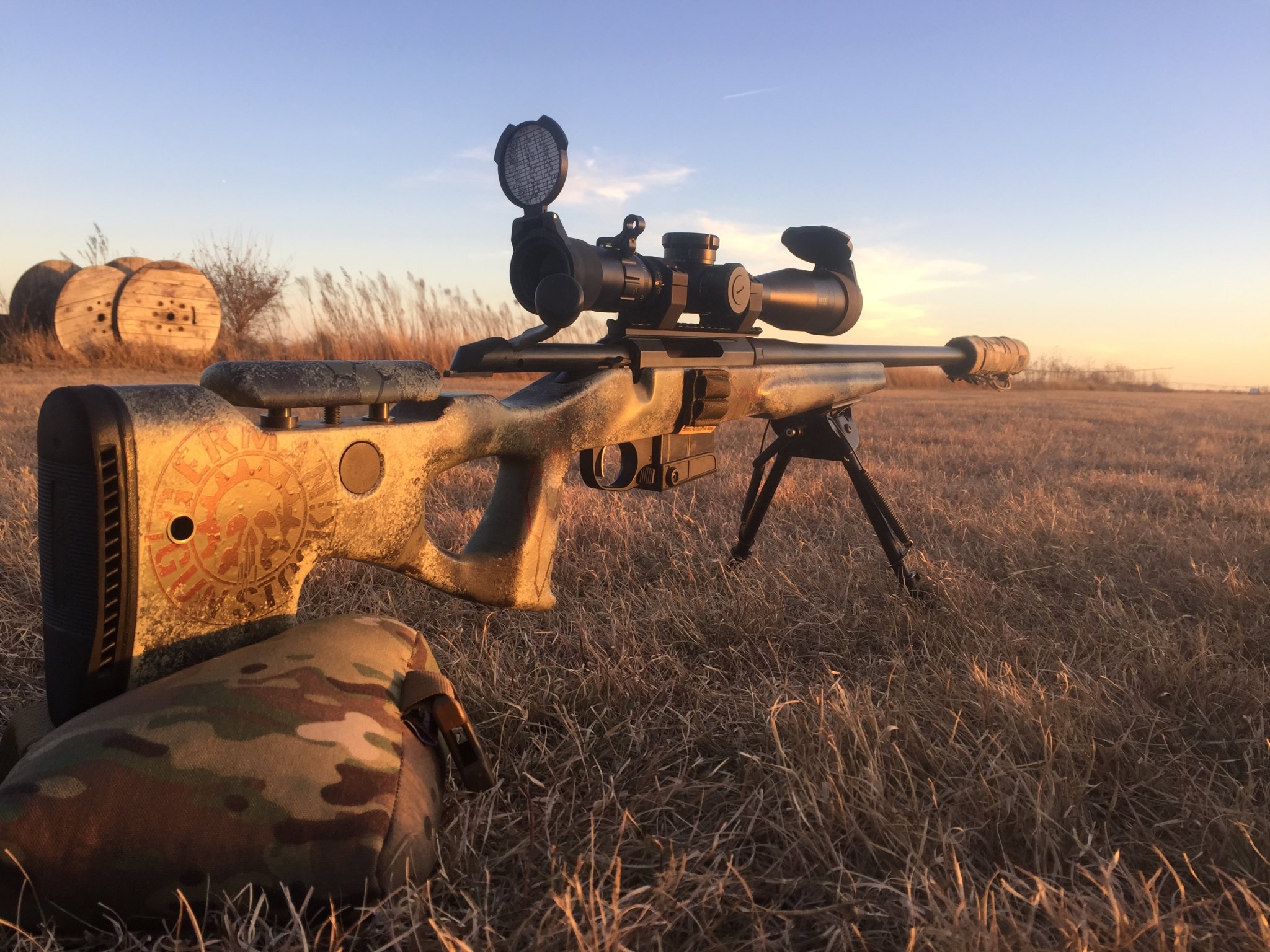

Tikka t3x varmint in 223. Run MDT mags. Might need a little tweaking to get gun to run with pressure on mag, but they work.
I was leaning towards the T3X lite, partially for weight savings, partially because I won't need the mag system. Any issues with that I'm unaware of?
How well do the tikkas do, especially the light contour ones, with long strings of fire?
My other option is a barrel/mag insert/bolt face for my Blaser. Price is likely fairly close, between the complete rifle/chassis/bits and bobs, vs. the R8 barrel swap. I do know that the R8 does not move its groups when fired fast and hot, so there is that. The minus is the lack of chassis options and the small internal magazine.
I have the .223 Tikka Varmint in MDT LSS-XL Gen-2 chassis/skeleton buttstock with Vortex Viper PST Gen-2 5-25. It's a consistent 1/2-MOA platform with factory 69-grain SMKs. The only time I shot on paper at 300 yards, I got a 0.75" 5-shot group - but I attribute much of that to luck as there was a lot of mirage and light full-value crosswind.
But it isn't light, weighing 13 pounds with no mag.
The MDT mags take some breaking in - when new, tight and a bit sticky. Also, single-loading rounds atop an empty inserted mag doesn't work very well - it can be done but requires good timing tapping the bottom of the mag while closing the bolt. My TAC-A1 in 6.5 single-loads easily.

Just my opinion trying to help the op. Nothing wrong with the Tikka and they can feed ok from a mdt magazine. Just would not be my choice.
I have a Tikka T3x 223 Varmint in a KRG Bravo chassis running MDT mags. Feeds flawlessly. Great trigger, smooth fast action, and an abundance of aftermarket upgrade parts later if you wish. As for converting it into a 6.5 later, you'd need a new bolt regardless of brand.

Accurate Mag. A T3X Hunter in .223 would work as well, unless you're shooting heavy strings of fire. Personally, when this barrel is fried on my Varmint, I'll screw a PVA or Bughole pre-fit on it in a different contour.
The KRG X-Ray and Bravo chassis are pretty light.

I have a .223 varmint running CDI bottom metal in the factory stock. I sold the metal AISC Accurate mags and went with MDT mags as you can load longer with them. I am running the 75gr ELDM at 2.49" coal and they feed great. I had to take some material off of the feed lips to clear the bolt, but it was really easy to do. You could buy a T3x lite and drop it into a KRG Bravo and have a lightweight rifle that uses AICS pattern mags.
There are lots of stock options out there for Tikka actions and there are more coming. Grayboe is coming out with a Tikka version, McMillian, Manners, German Gun Stock,.... lots of options.
Just an FYI, the AM AICS mags can be mod'ed as well. A rat tail file and about 5 mins of time and boom, 75gr ELDM's seated long with no issues.

Thanks for all the replies and info. I've basically decided on a T3 Lite, dropped into a KRG Bravo, and the barrel cut to 16" It will be stiffer than as issued, and maybe that will help with the shot strings staying tight, idk. It won't be thick enough to thread 5/8X24, which is what I need, but I can get it threaded 9/16, and use an adaptor. Sounds like Accurate mags are a fairly sure thing, with the MDT plastic mags a possible second. I have a good source for a T3, just need to order it up and get things going. It is much cheaper than the CTR, and since I won't be using the CTR stock, it seemed silly to pay extra. Also, if the barrel really doesn't do what i want, I'll have spent that much less on the gun and can get the barrel swapped to a Bartlein in short order. I put an email in to Sterk about his parts and am waiting to hear back. Should be a fun little gun when its ready.
For those of you with Bravo's, how do you like the ergos? I plan to get hands on one next week, and assuming its all good, order one.

Don't know if you saw the "conclusion", but I bought a T3 lite stainless. Its a laser gun. I like it so much, I also have a T3 SS Varmint on the way. :)
Great move!
I brought a .260Rem in Tikka Stainless lite and it shot beautifully out of the box. I promptly rebarrled it to a Comp barrel (hardy Med Varmint, 1:8tw,26”) but If I do more hunting I will likely pick up a another stainless lite. You will not regret the Varmint either.
