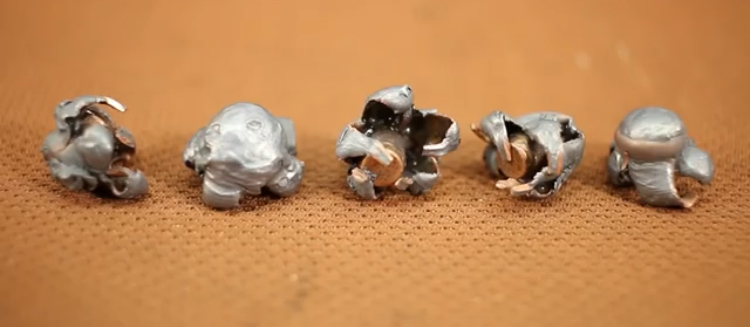

These are 75 gr Gold dots from ballistic gel fired from 2750 at muzzle. I was hoping to get at least 2650 out of my 16” or 18” barrels.
Reactions: Snuby642
