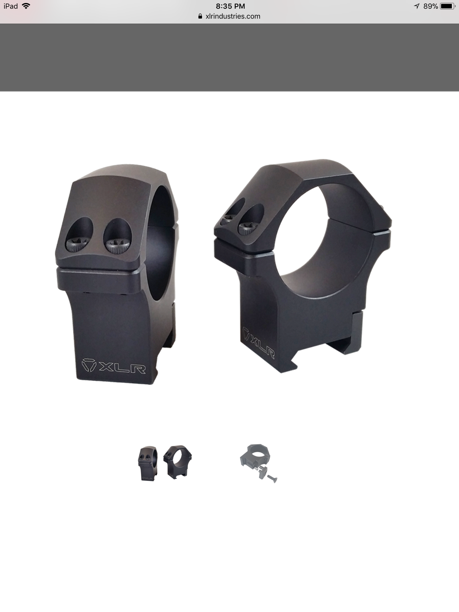

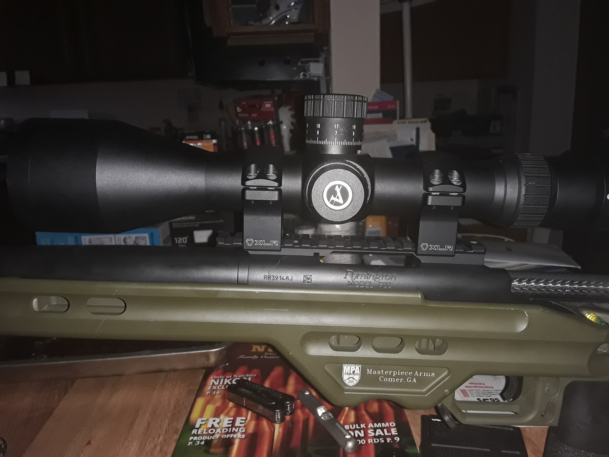

I've got a set of the seekins rings and a spuhr mount. Both work great but a friend introduced me to the XLR rings, I no longer pay $100+ for rings/scope mounts

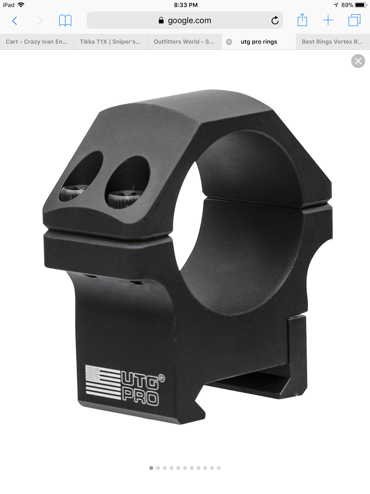

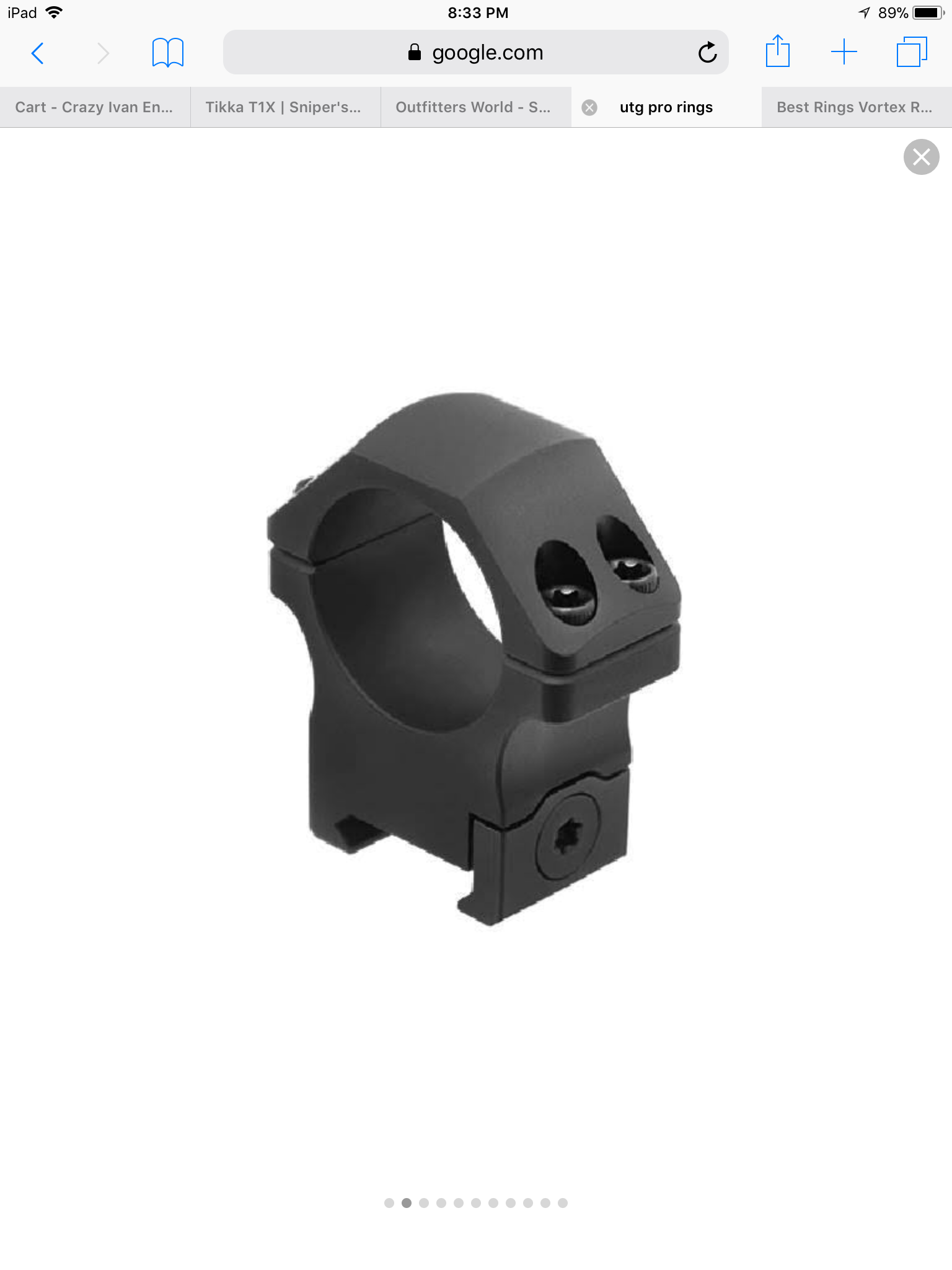

The XLR rings appear to be rebranded UTG pro rings. They are really nice rings actually and about $30 less for a set than the XLR rings. I will admit I had my reservations about anything branded UTG but the pro rings are some really nice rings for the money. I have some high end rings that I paid 5-6 times what I paid for the UTG rings and I actually think the UTG’s May be a more solid ring. You can get the UTG pro rings for about $45 if you shop around.

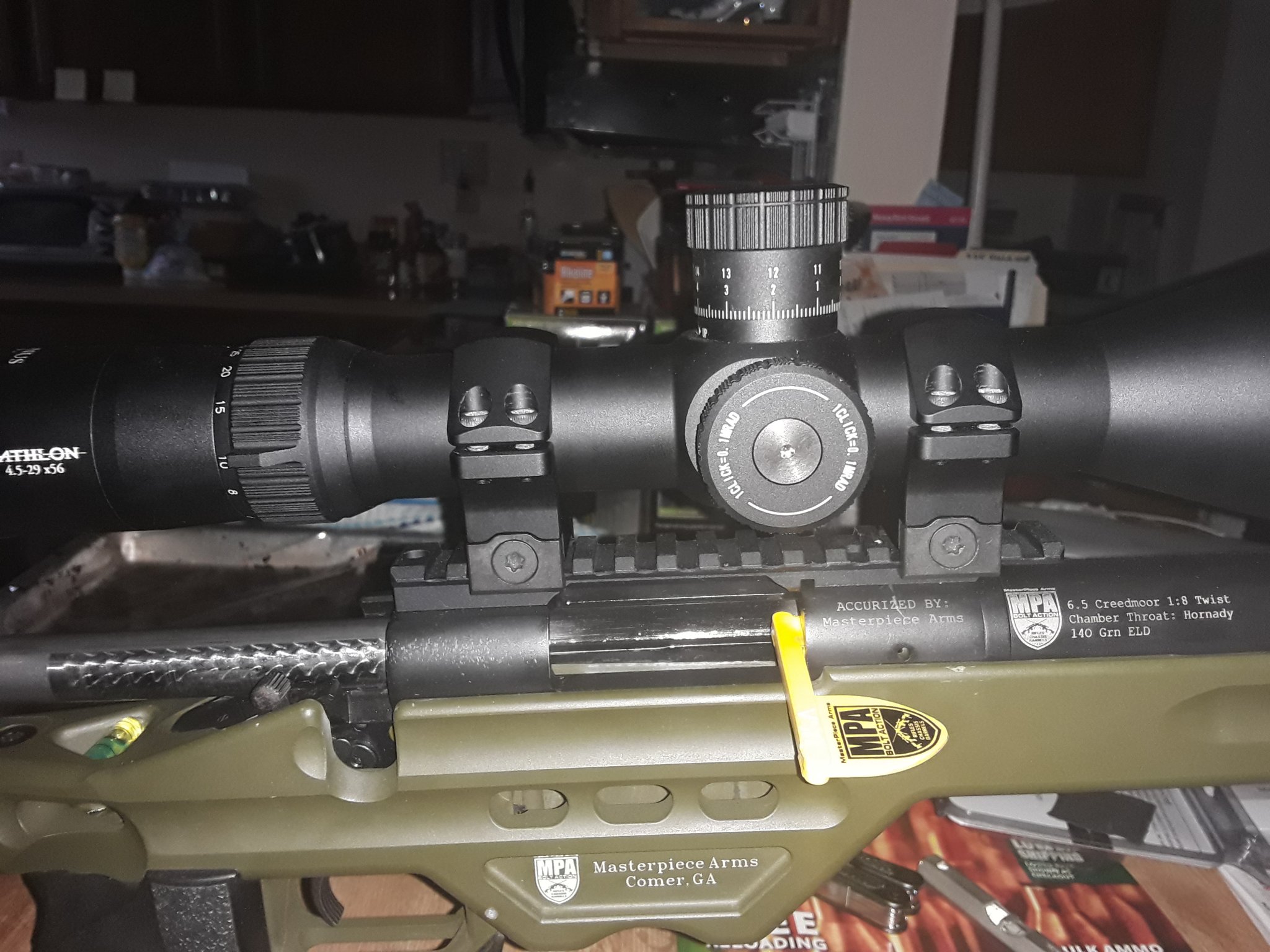

I'm. Using the vortex pmr rings. 1.45" extra high.
Very happy with the rings.
Also do yourself a favor and don't chince out on rings for your scope/rifle combo.

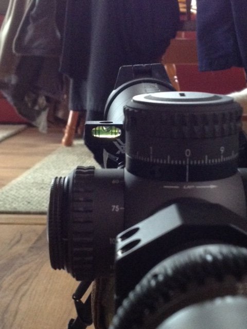

Same setup except I run the vortex rings. The only other difference is I run the bubble on the bottom towards the rear of the scope-makes it easier to pop open my left eye and have it right there for last minute checks before the shot.

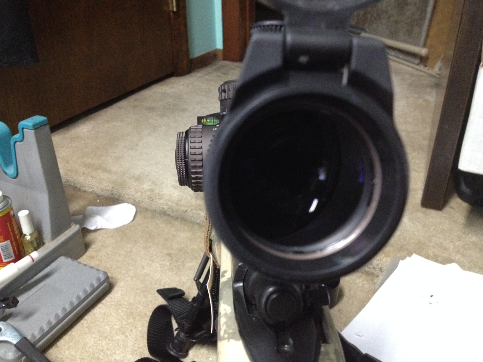

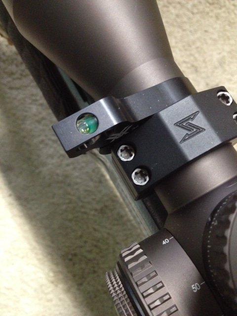

Can't go wrong with Seekins. AR height would work on the RPR. Vortex Precision rings are made by Seekins as mentioned and excellent as well. Get a Vortex Lo Pro level mounted on the scope tube. Easier to install and get level than a ring cap level. Easily seen from behind the scope and out of the way. You can mount if so below the parallax knob too.

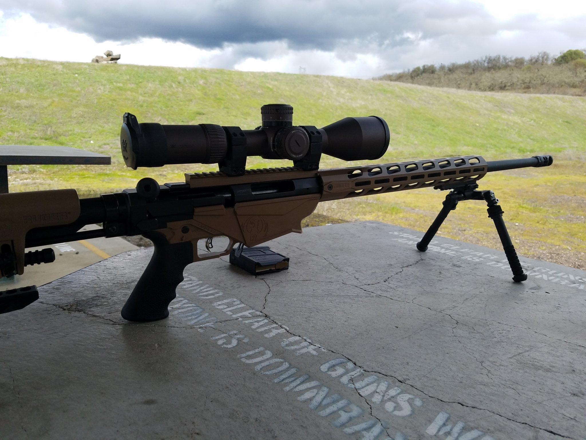

View attachment 7051333View attachment 7051335View attachment 7051336
Reactions: AllWorkAndNoPlay
