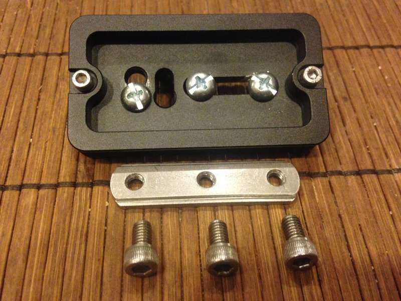

If you decide to use the RRS Anschutz rail adaptor, make sure the rail you install on your stock is actually Anschutz spec.
Reason being, the 'Anschutz' rail that McMillan installs at the factory is not true to spec. I found this out the hard way, as the RRS adaptor would not fit/slide onto the McM rail.
Wound up having to modify an Arca Swiss plate paired to a dovetail base for mating to the McM rail on my A3...
Now that the plate is mounted, the RRS QD throw lever leveling base interface does work great!

I used the same plate to mate to the Ansschutz rail above, just had to find a backing plate that'd work. Then swap to longer screws...
