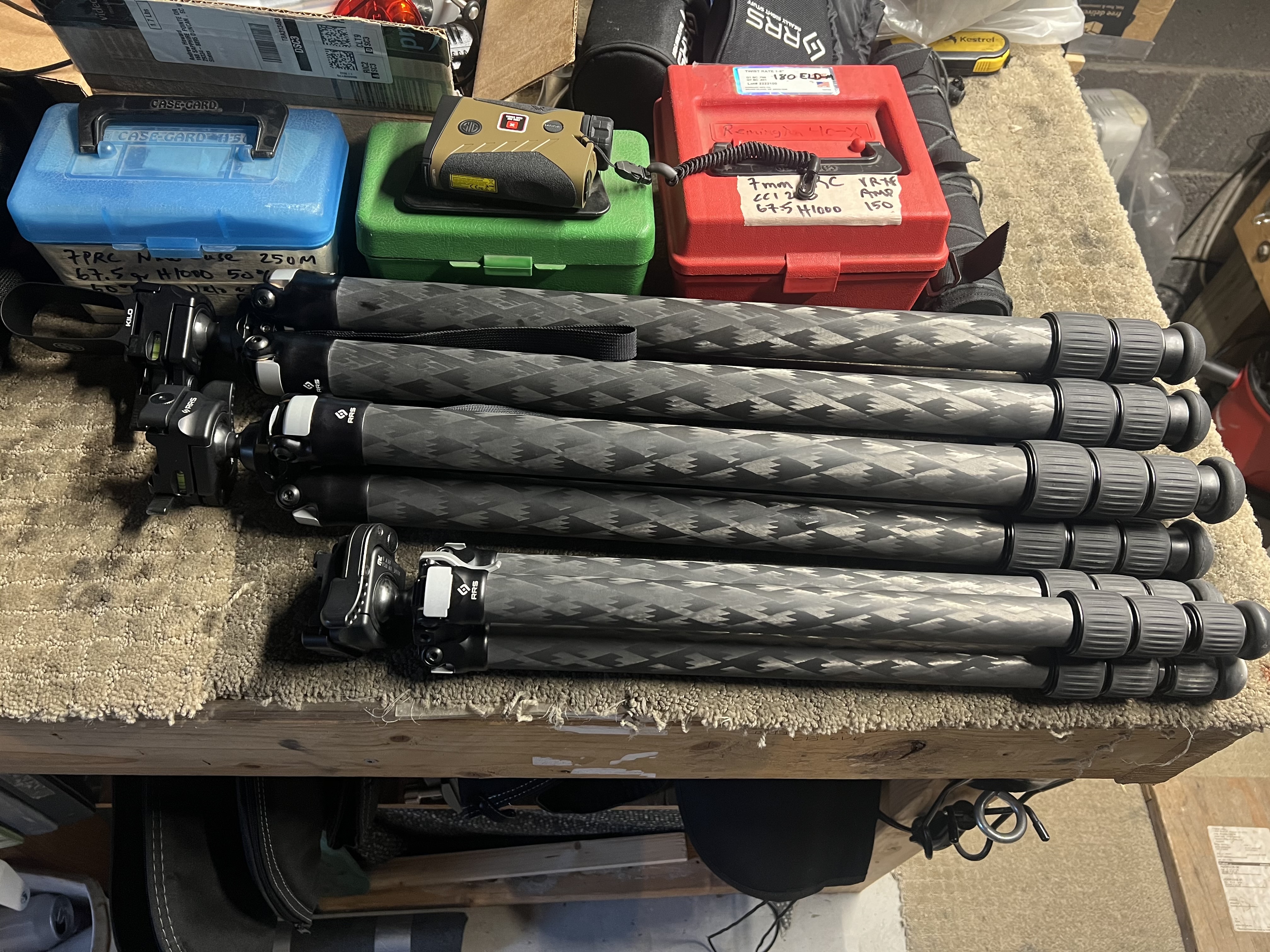

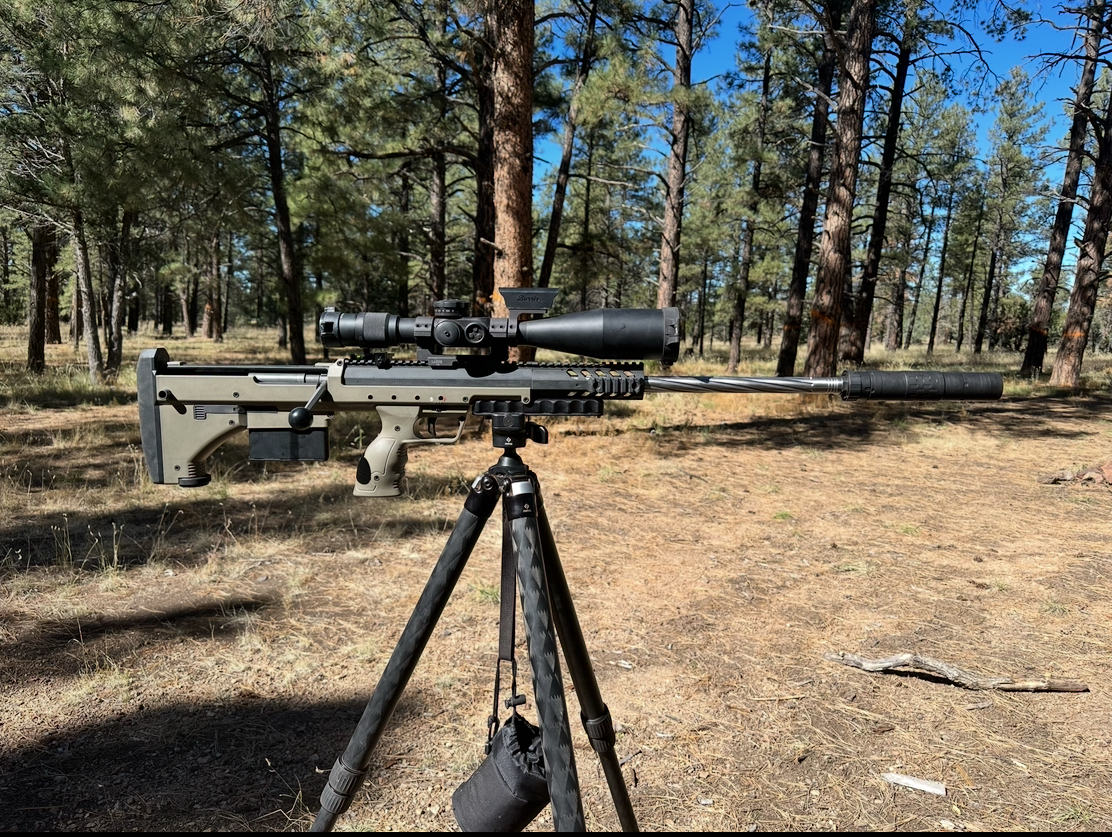

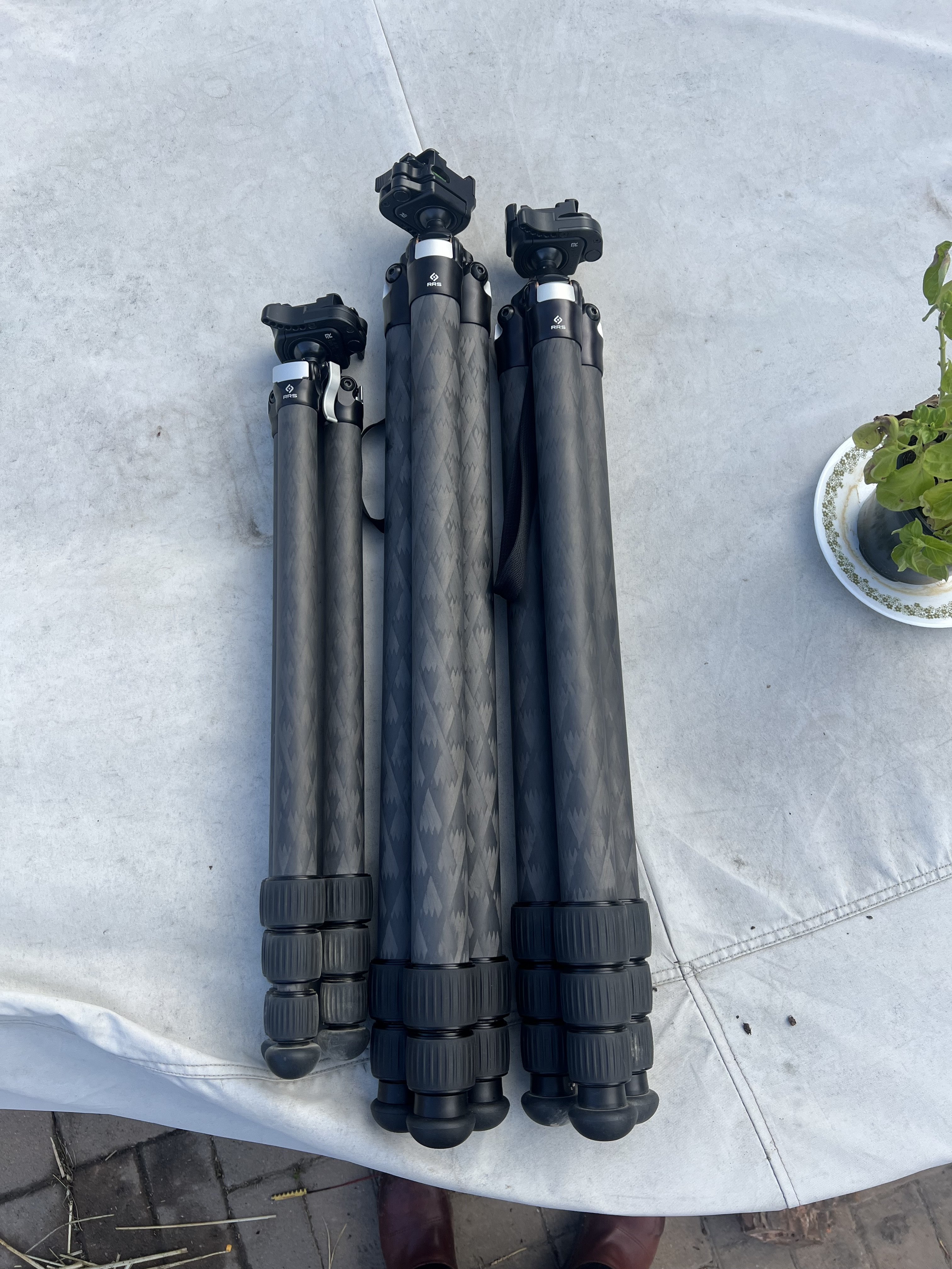

So it will surprise none of you that I wound up with three different tripods. And I may keep them all.
In my own final analysis, the 14L has plenty of stability for seated or kneeling shots, but if you’ve ever handled a three series, you know that you give up a lot of stability. So if you really need to squeeze off that extra pound or 18 ounces or whatever then go with the 14.
When I realized how capable we were with the seven PRC off of a tripod out to 1000 yards on a 12 inch plate, I realized I didn’t want to give up any stability to save that last pound so I bought a 33. It is just over 4 1/2 pounds. I suppose I could see why somebody would get the 34 because it would pack a little shorter and only add 2 ounces. For me, I like the simplicity of just having to worry about two leg extensions rather than three.
After this analysis, the one that really has me scratching my head is the common compromise of the 24L. You’re gonna give up a fair amount of stability compared to the three series and all you gain is 9 inches so if you’re really tall or need to do a bunch of stuff standing I get it. It might be the best all-around compromise if you want to truly stand for blasting or whatever. But if I wanted to stand and shoot, I would definitely wanna step up to the 3 series
That’s my current two cents worth I’m sure it will change with more time in the field

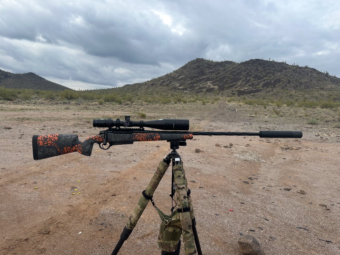

Then I use the leveling head with a panning head on top. Because that setup is lower than a ballhead (either traditional or inverted like the Anvil) that adds further to the wide apex’s stability.
I’m a pdog shooter so I’m not packing it in anywhere. The most I hike with it is a mile.
Now I use my TFC-34 just for my binos.
Moving from the TFC-34 to the TVC-33 is not as big difference as going from a crappy tripod to a RRS. But there is less reticle wobble. I haven’t measured how much less, but our resident tripod man @Diver160651 wrote something up about it…he isn’t around here much anymore.

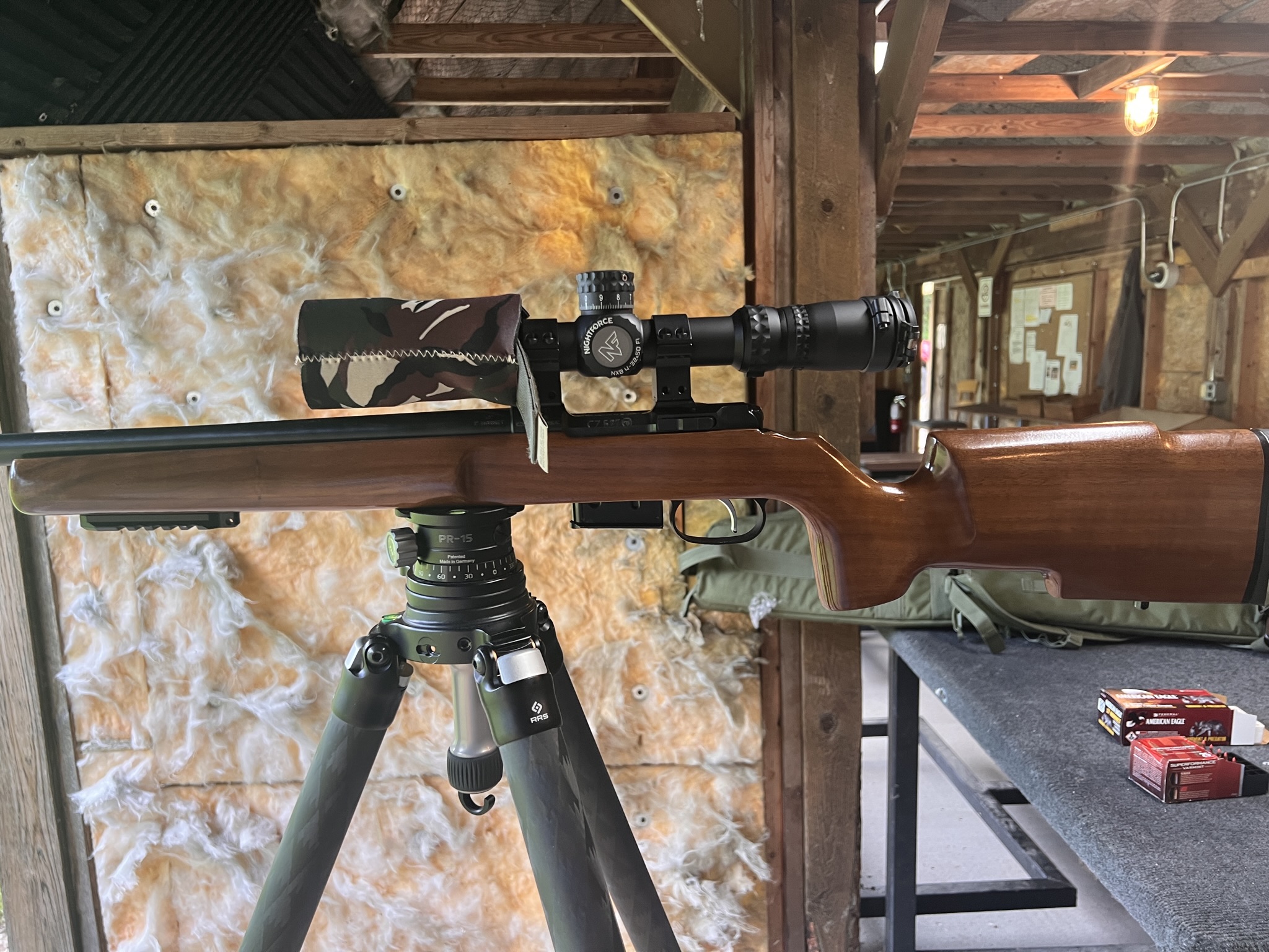

I have sort of a tallish pan head on there. Might get a slimmer one. Ignore the neoprene can koosie on the scope haha, that was a failed cheap hood experiment.
I pan a LOT during varmint shooting. It’s very nice to have separate controls for tilt and pan.

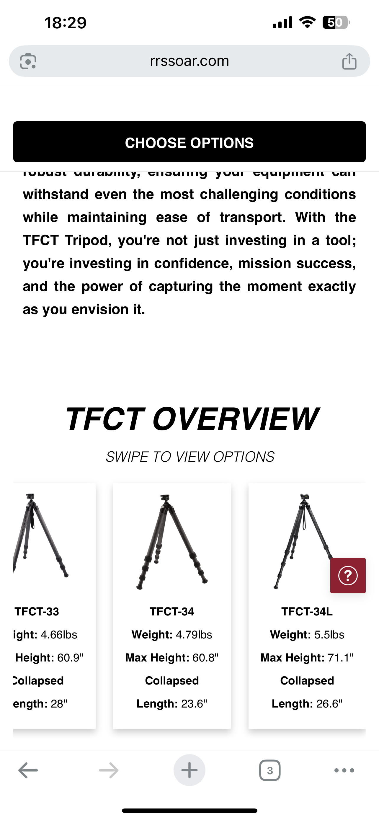

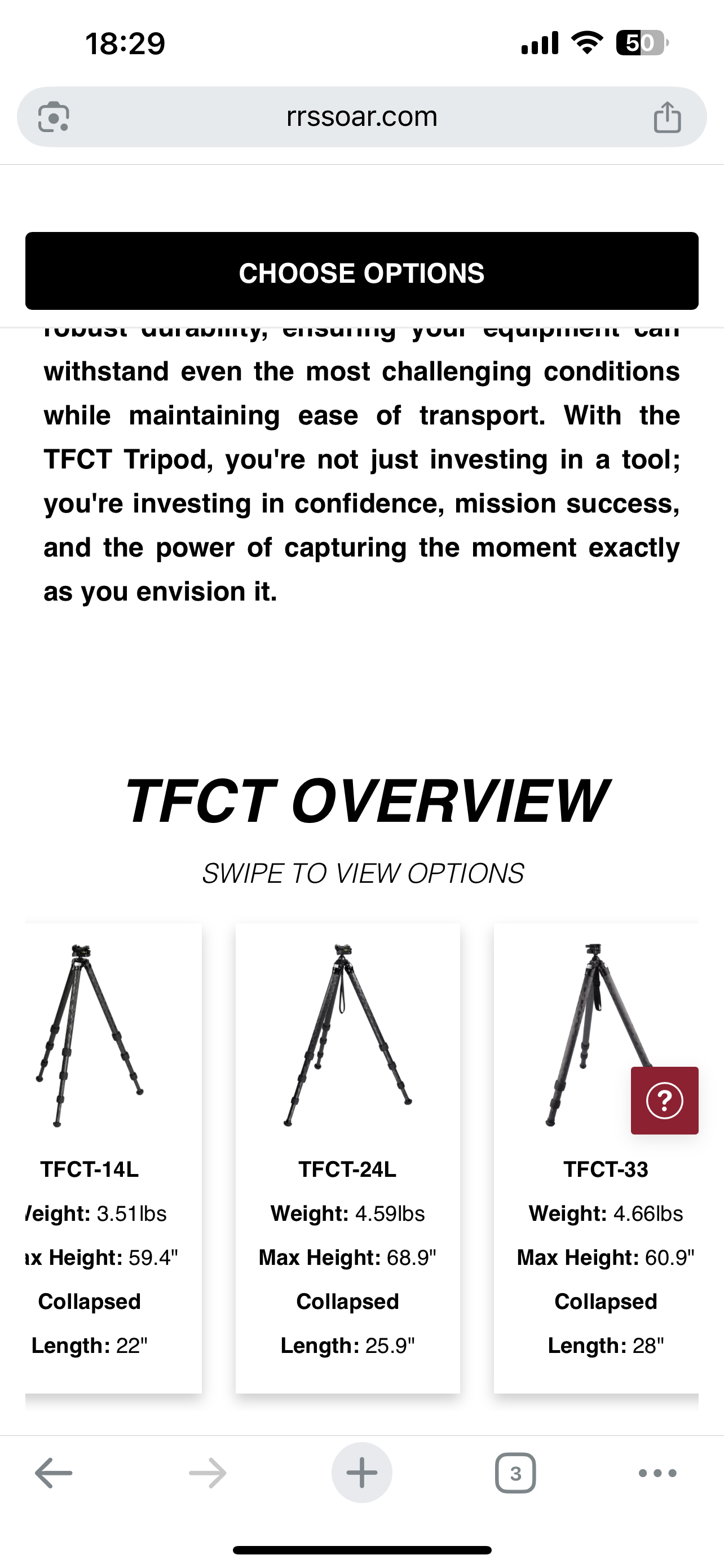

And I like the 33 rather that 34. 33 a couple ounces lighter and couple inches longer. Same extended height, but deploying 1-2 leg sections to get to desired height faster/easier that 2-3 leg sections.
Unless you need it as light and short as possible, I see no use case for 14l or 24l - cuz losing that much stability just seems like too high a price to pay for 18oz or 6” or less
And the 24l is pretty much out together. Once I hit 4.5# w 24l, it seems just silly not to go up to 3-series, if you look at the specs

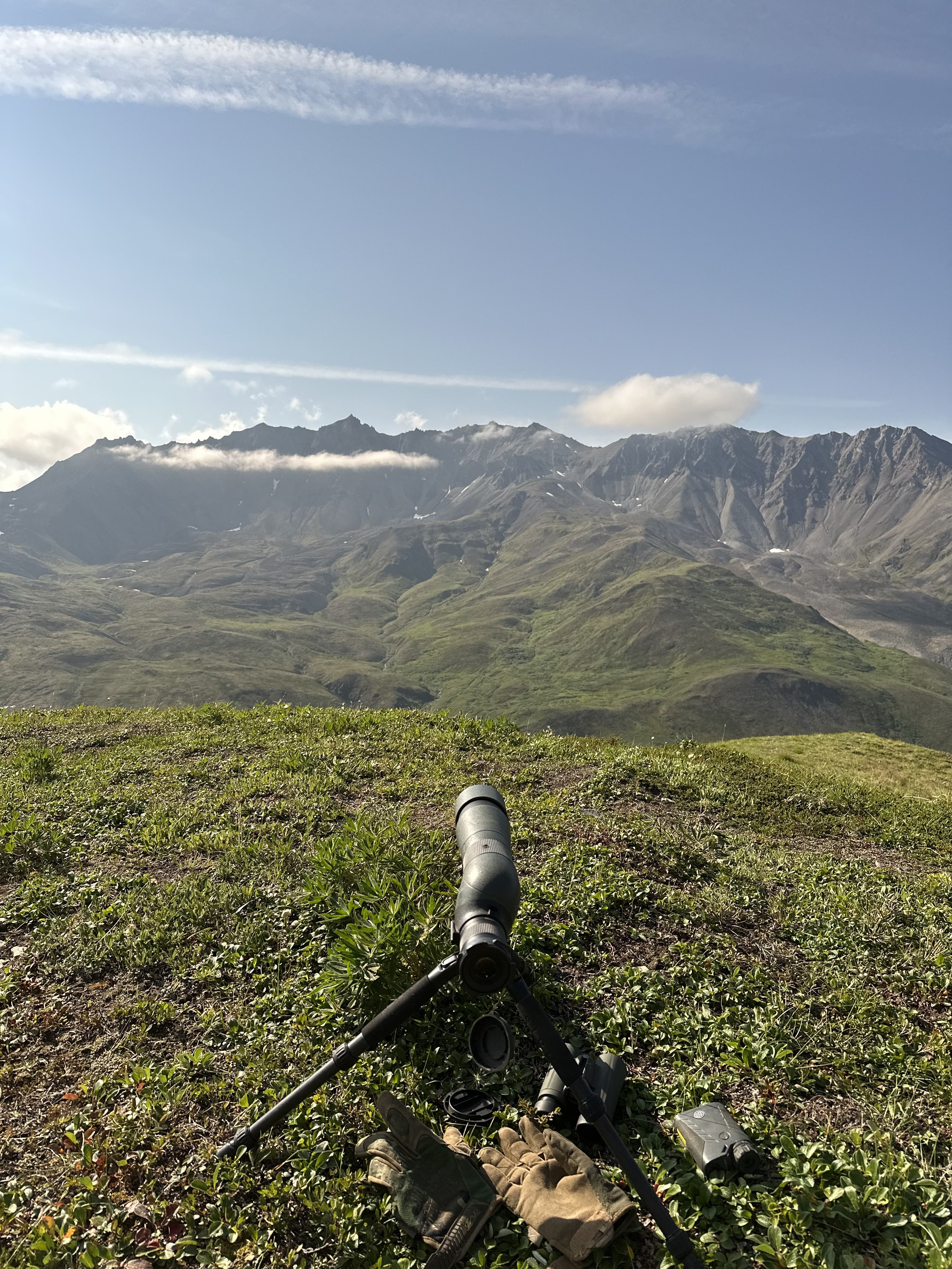

We made some additional plans for our hunt and are going to take a Swarovski ATX 65 mm scope with us because we have some additional weight allowances.
Does anybody know which PT – scout panning head from RRS I will need to attach that scope to the anvil 30 for easy switching between scope and rifle?
As usual, the really right stuff page does not make it obvious as to what I will need for that attachment

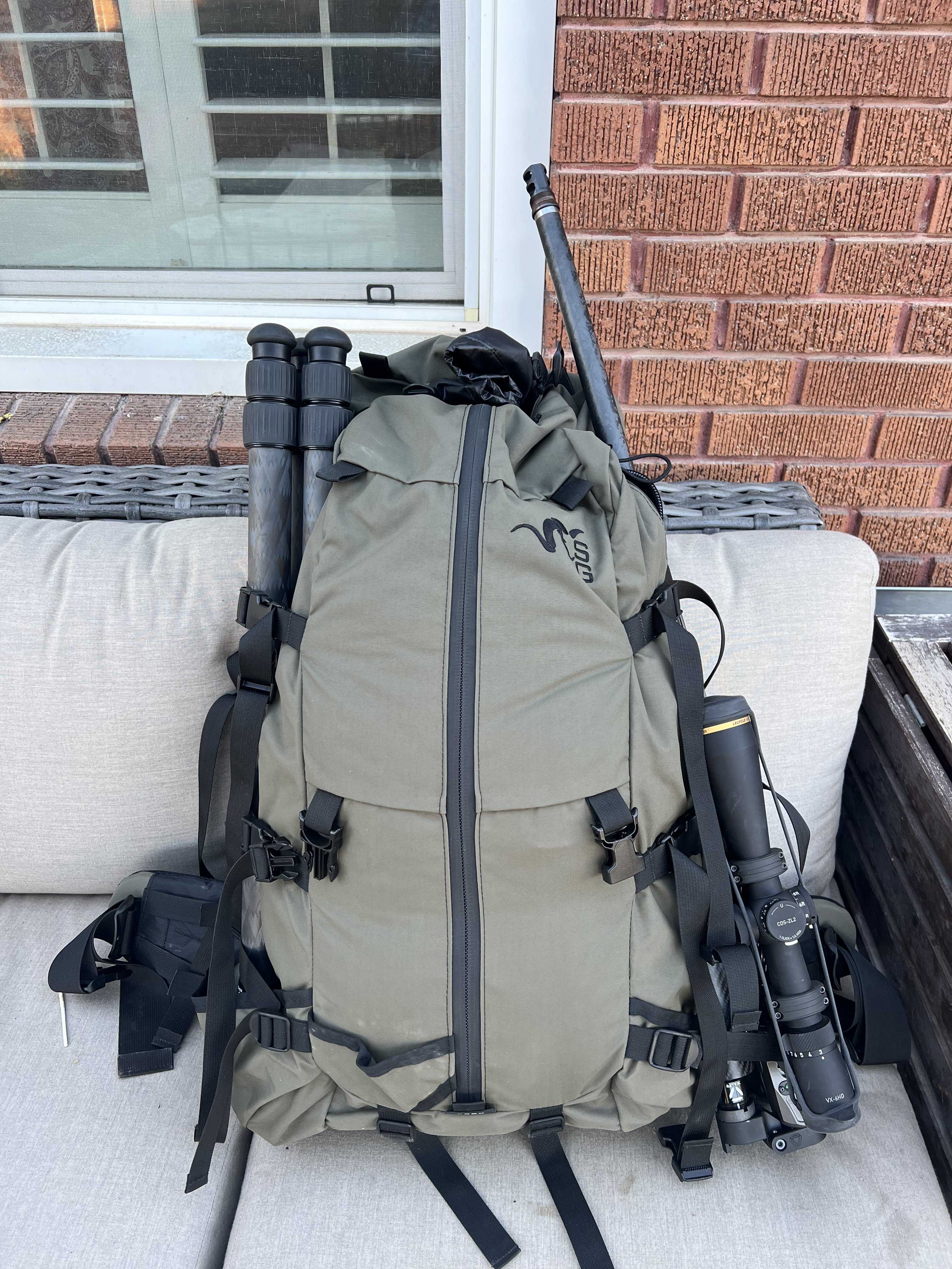

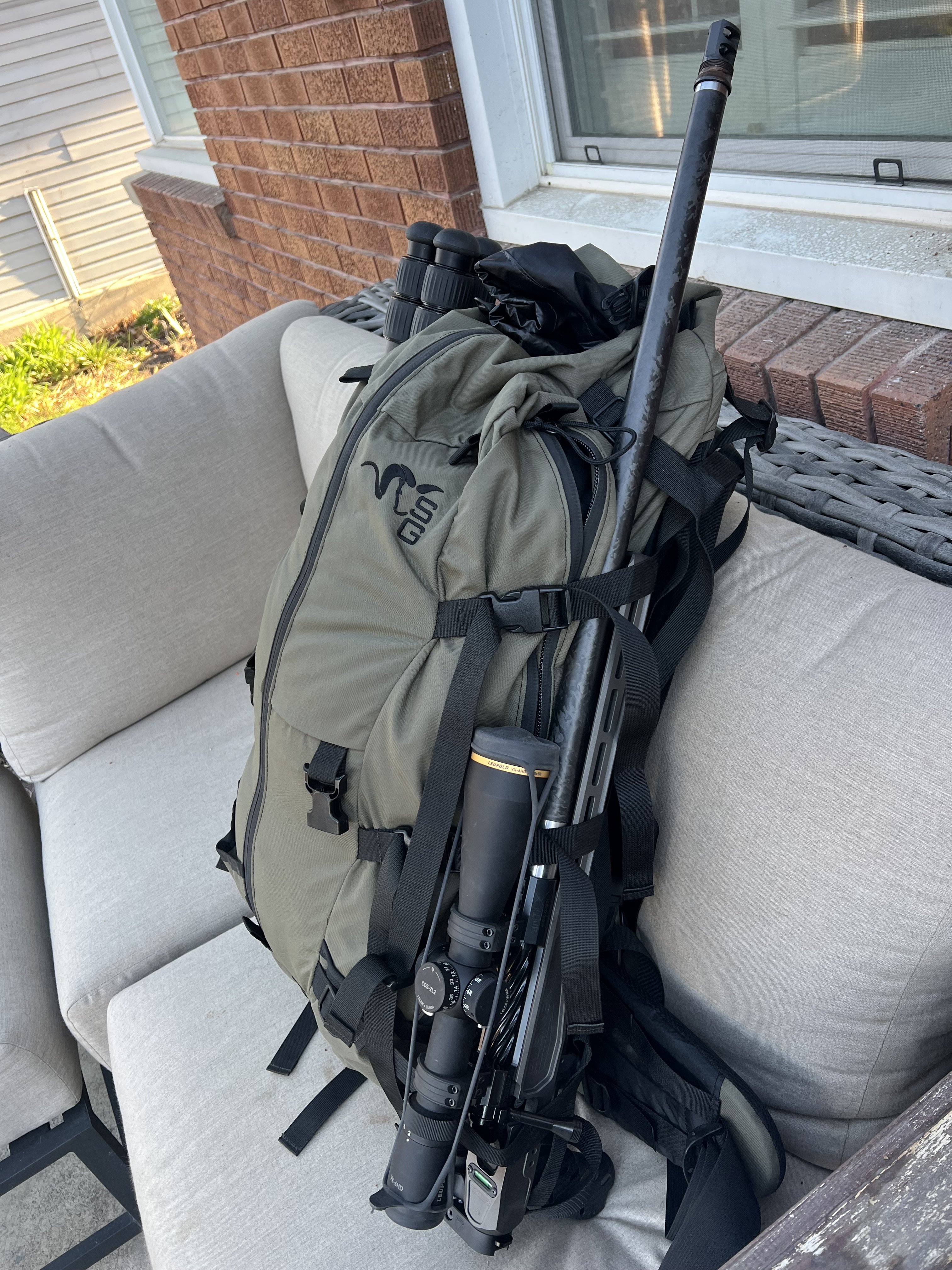

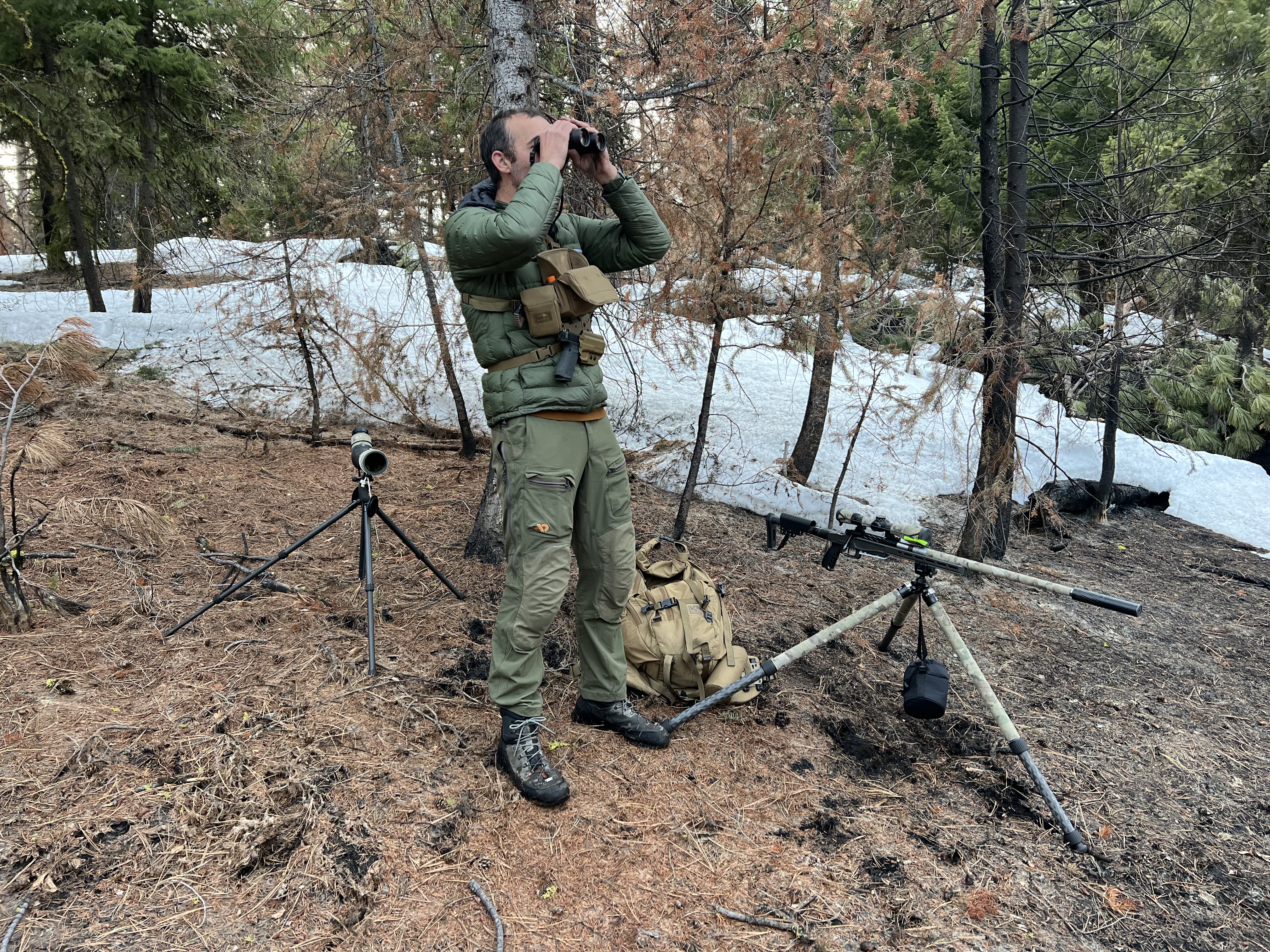

Here are a couple of pictures with the TFCT33 on the pack along with the rifle and the folding XLR chassis with a 24 inch barrel. Pack has only a sleeping bag stuffed in it for demonstration purposes. As you can see if you’re going to pack your rifle, you can definitely afford to have the 28 inch tripod on the other side.

excellent question. And definitely an option, it seems. Two questions:
Will a bone stock swaro 65 mm ATX objective go directly onto the anvil? without adapter?
And, do you find it difficult to glass/scope with the anvil 30 alone? I find it a little unforgiving with the clamp - it's touchy; meaning it's either locked, or looser than Mamma Sun's undecariage - not really a "pan and tilt" kind of experience
ETA: I just checked my ATK95 objective (early generation) and it is NOT ARCA compatible
I did find this thread but it's a bit dated and the one link is broken/outdated and the PT-SCOUT is not specifically mentioned
Thanks! So I get it: tripod, Anvil 30, PT-Scout, adapter plate, Swaro 65mm ATX. That's a STACK of equipment. Is it worth it to do the PT-SCOUT (and, this leaves the question of "which one" as there are 3 variants: https://rrssoar.com/ptscout/), or is it better to save $300-400 and 6-9oz and just glass/spotter with the ANVIL 30?
Sorry to be so dense
No. Just the arca adaptor to attach to your swarovski foot. I don't find it to hold me back at all while hunting. It's not the smoothest, but still pretty dang good. I have a older 65mm that needs a B76 to attach to my Anvil 30 and the 95mm that has a arca foot and clips right in to my anvil 30.
If you do get a PT Scout. Just get the one that has either clamp.
But I would just run the Anvil30 for both shooting/ spotting.
The only time I’m running a scout is for the monopod or on a plate to align my bino to spotter. Or if I’m RO’ing a stage, align the glass to separate targets with ease of transitioning.
Reactions: secondofangle2
My older swaro sts 65 fits the anvil 30 just fine. I do recommend some time glassing with it before you go. As you said, it’s either too tight or falling over. With some practice you can get to the point of being able to pan with the anvil 30, or at least slightly shift over to pick apart the next area over some what smoothly. Not a rrs tripod or head but same type of head in the pic.
