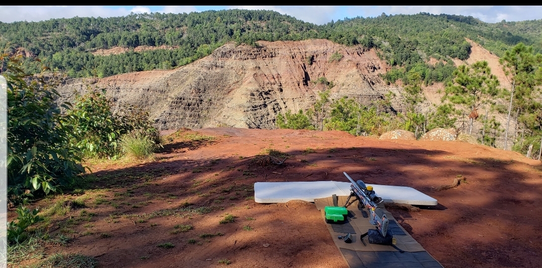

    6mmAR 600 yards 5 shots on rocks
    Reference below.
