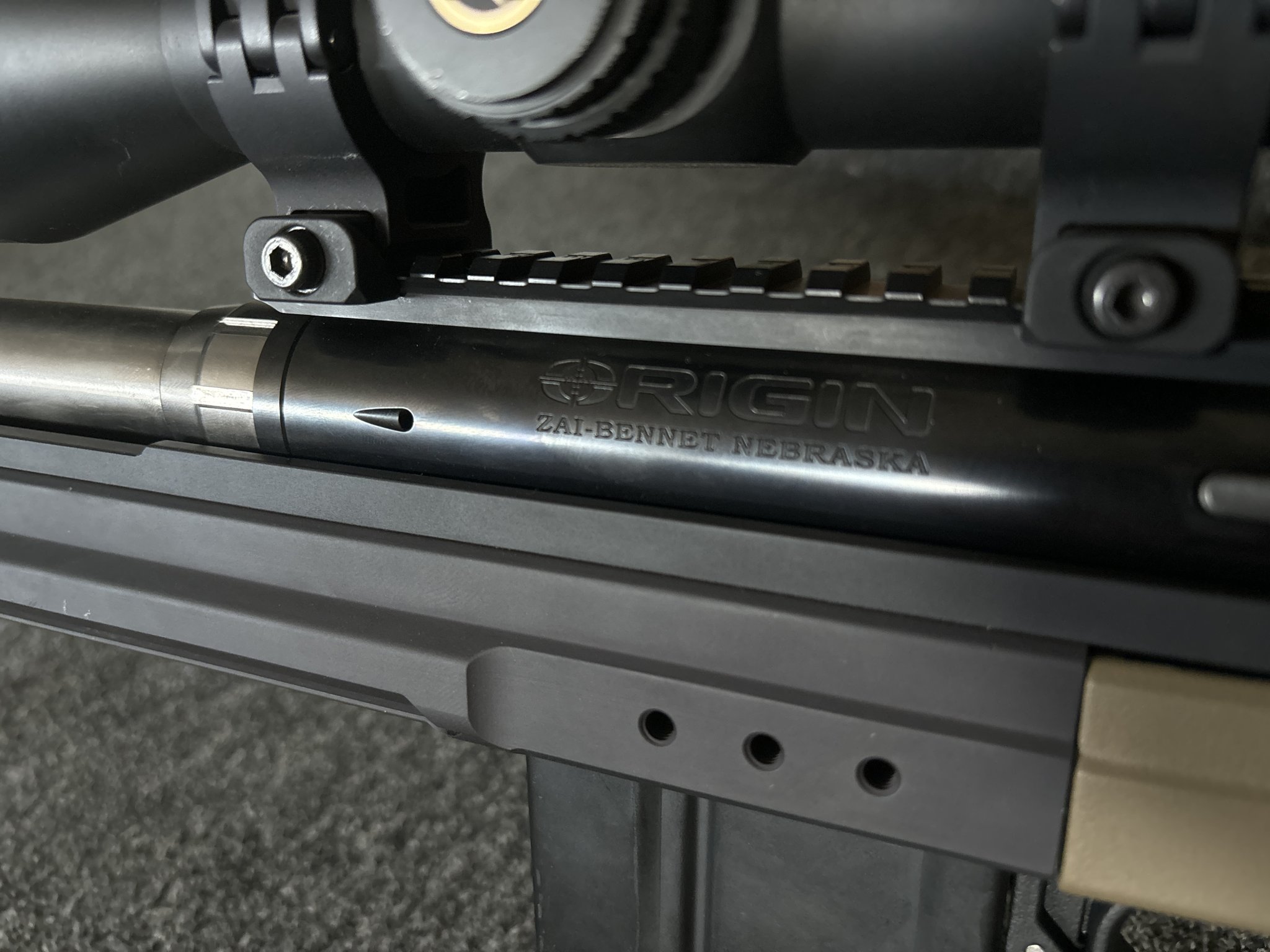

I prefer nut style pre fits for my Origin actions. I want the ability to adjust headspace (not likely needed) to my preference. I've been getting them from Southern Precision Rifles (aka Bugholes) and have been extremely satisfied. Different strokes for different folks.

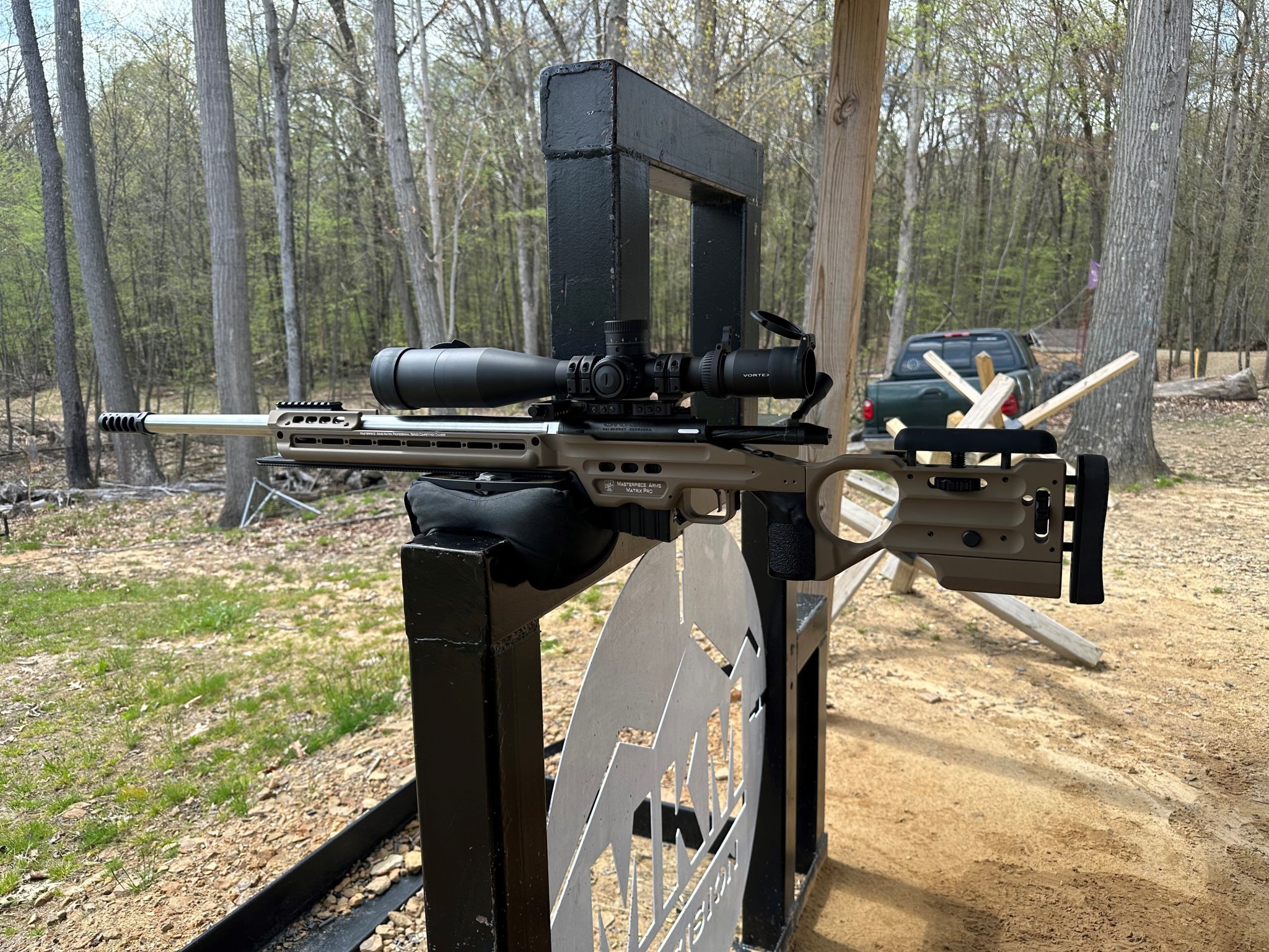

My latest barrel (pic below) was from KI Precision and I've been impressed as well. Lots of good options out there!
Very nice looking rifle
