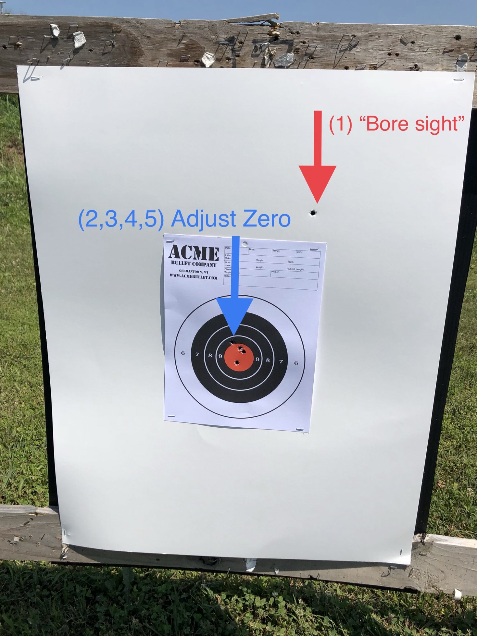

I’ve had good luck “bore sighting” on the range. Looking down the bore can really get you very close. A large clean backer board really helps. I usually grab some poster board from CVS or Walgreens on the way to the range. I used to do it at 50 yards but last time I did it at 100 yards.
Here are my results:

On a decently accurate rifle with a good bore sighting, you don't need to start at 25 yards, I start at 100 and usually get within about 1.5".
The next trick is after the first shot, aim at the center of your target again, get good and stable on the sandbags and then dial the reticle over to your point of impact. You get your zero in two shots if your rifle has accuracy approaching the click value of your scope.

Thanks - I'll give the "two shot" method a try this weekend
So, I'm now definitely a fan of the "take a shot and then dial the reticle over to the point of impact method" now.
I did a real quick bore sighting of my scope at home before leaving the range using a pie plate stuck to a tree. Went to the range and put my target up on on of those big pieces of poster-board and ran it out to 100. I put my rifle in a vise, took my first shot and I was about 3 inches high and 2 inches low. Moved my reticle over to that first shot and took another shot and was dead center. Four shots later, I had a nice 1/4" grouping at 100 yards. After that, it was 1/4" groups all day (well, actually for an hour since I ran out of ammo - I only brought 3 boxes with me).
This was by the fastest (and cheapest) zeroing session that I've had in a long time
