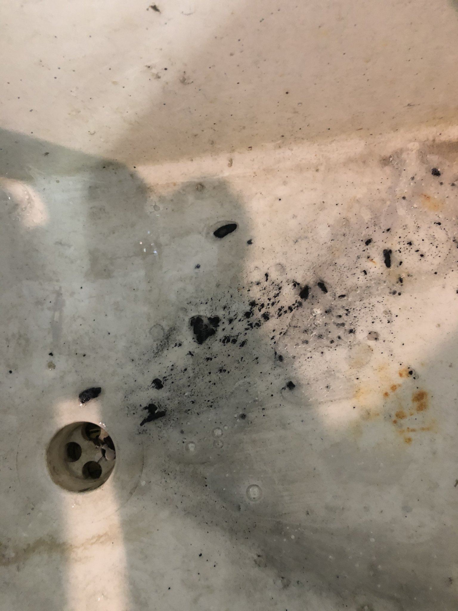

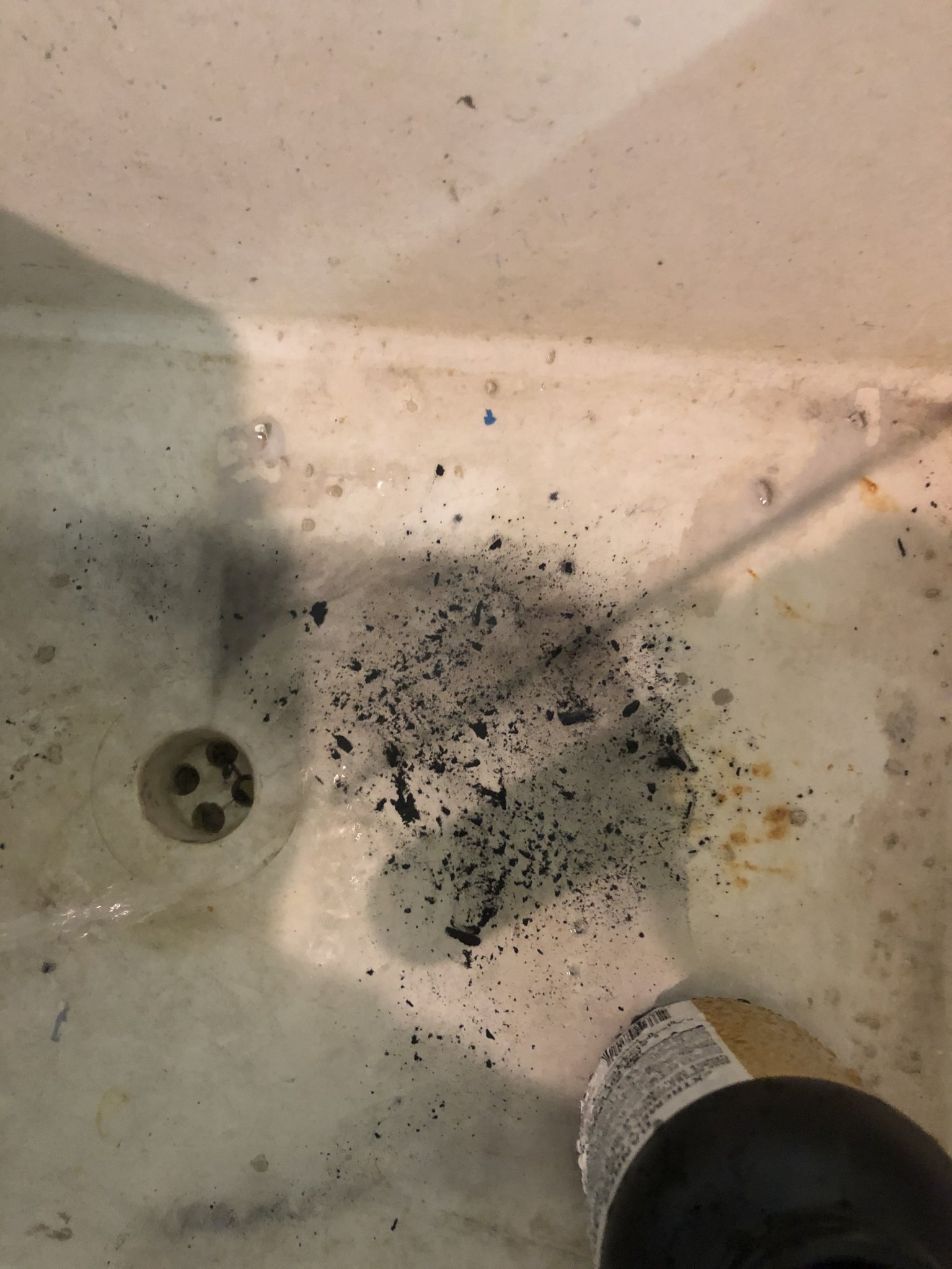

    Cleaned my ultra 9 and 338 ultra the other day. Soaked inside with CLR then 15minutes in the ultrasonic. Did three cycles of that.
