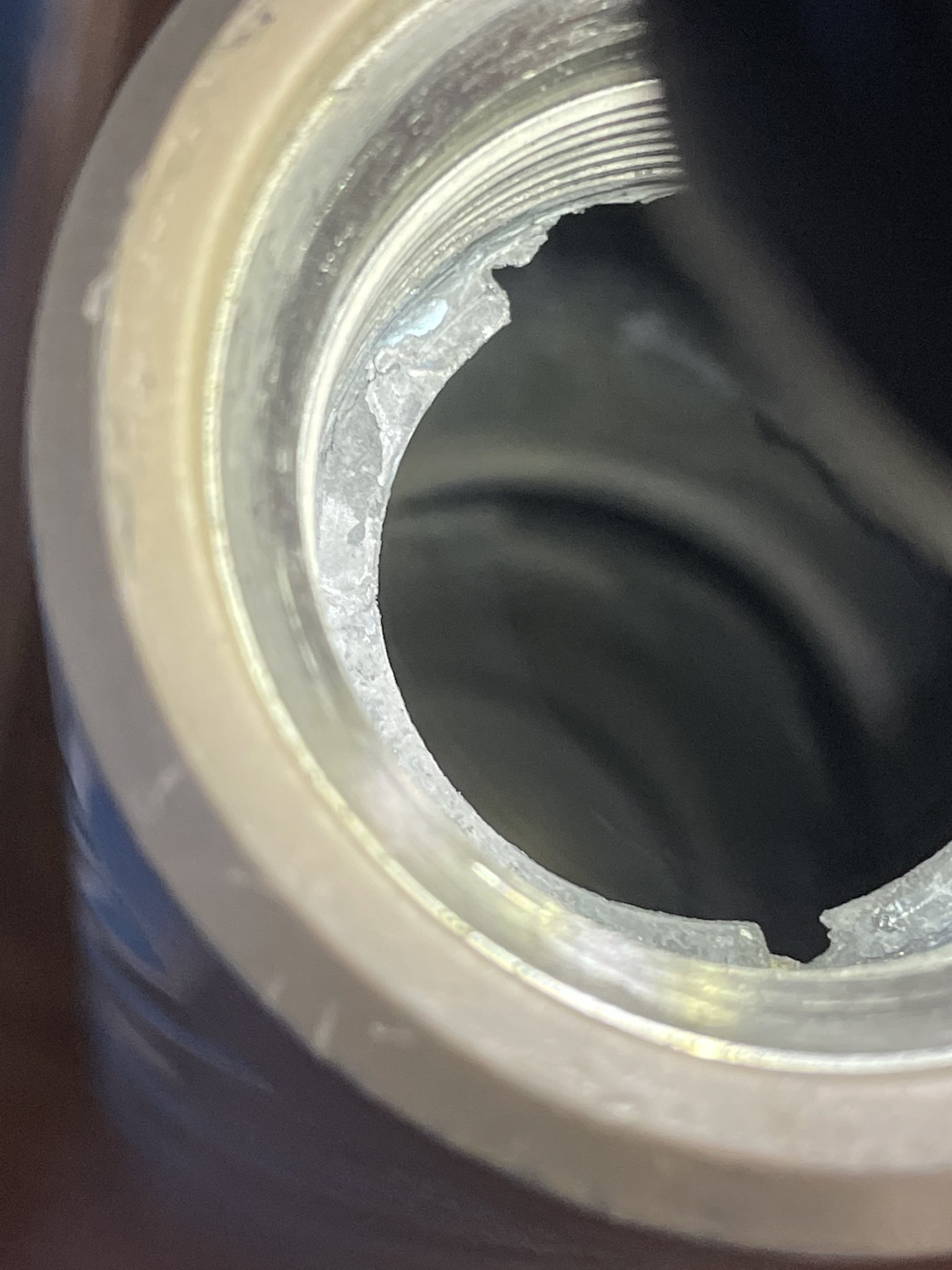

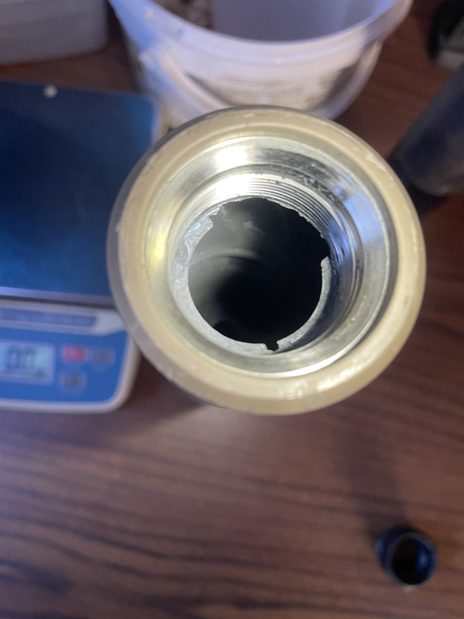

    I tend to push things till they push back. Lack of cleaning on a Tbac 338 ultra bit in a big way at a gas gun match. Had chunks of carbon fouling action causing malfunctions.
    Can has north of 5000 rounds of 6cm 6.5cm and 556. Maybe more

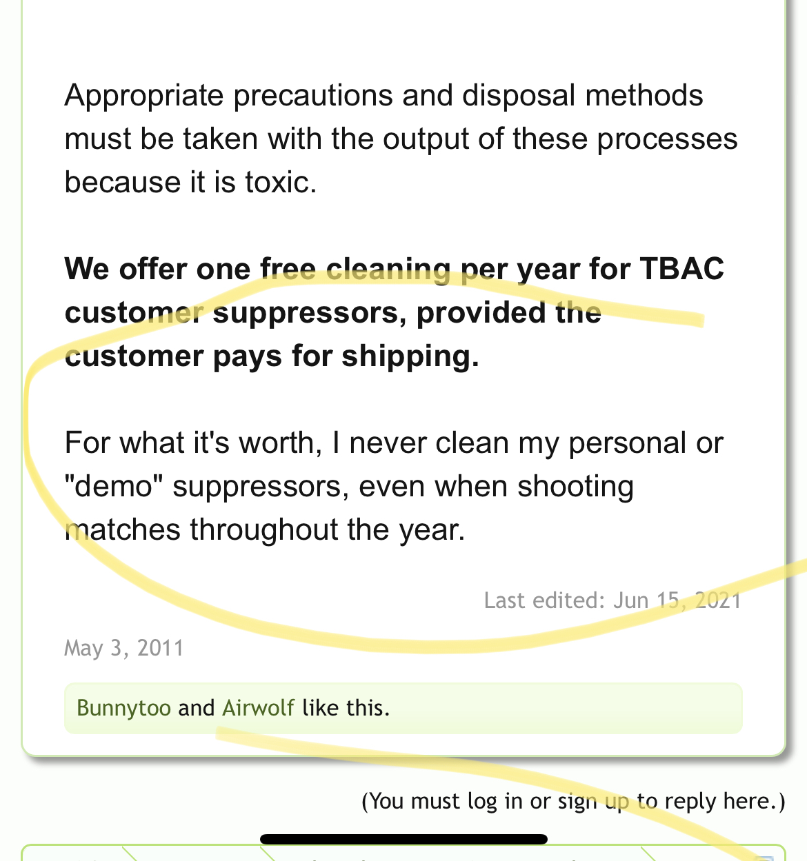

    If it's so heavily fouled... Just send it to TBAC. They offer a cleaning once a year IIRC.

    It had probably 7500 rounds through it on 223/6br/6.5CM. Had never been cleaned since new and had over 6oz of carbon built up. The can was so dirty that when carrying barrel up the can had debris fall back into the action and gum it up. Firing pin was having light strikes due to carbon debris.

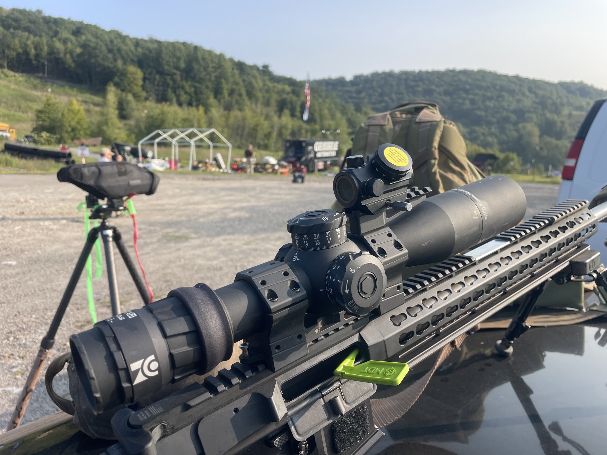

    Waiiitaminnit...
    Is that a poors Bushnell TRS-25 on top of your ZCO? I'm not even concerned about the torx bit that you forgot to remove at this point in time.
    Between this and those AICS-Remington photos you've been sharing in the AI picture thread, I'm starting to have my doubts man... :D
    Waiiitaminnit...
    Had to get a pic before I took it off.
    Wanted to try a red dot for the off hand portions last minute. My T1s in my junk drawer didn’t have mounts. But I had this brand new Bushnell I bought a couple years ago to put on a .22 pistol.
    Zeroed it the night before.
    Fucker was 3’ off in windage the next morning when I confirmed zero at match.
    F them poors optics
    Those AICS Remington’s are mid 2000s era GAP full customs . They were hot shit back then. Lol

    ? Maintain
    He says you don’t need to.
    My results determined that not to be an absolute.
    Still was top 10 finish. With all those malfunctions and manual bolt operation. Rest of my finishes there are too 5.
    ? Maintain

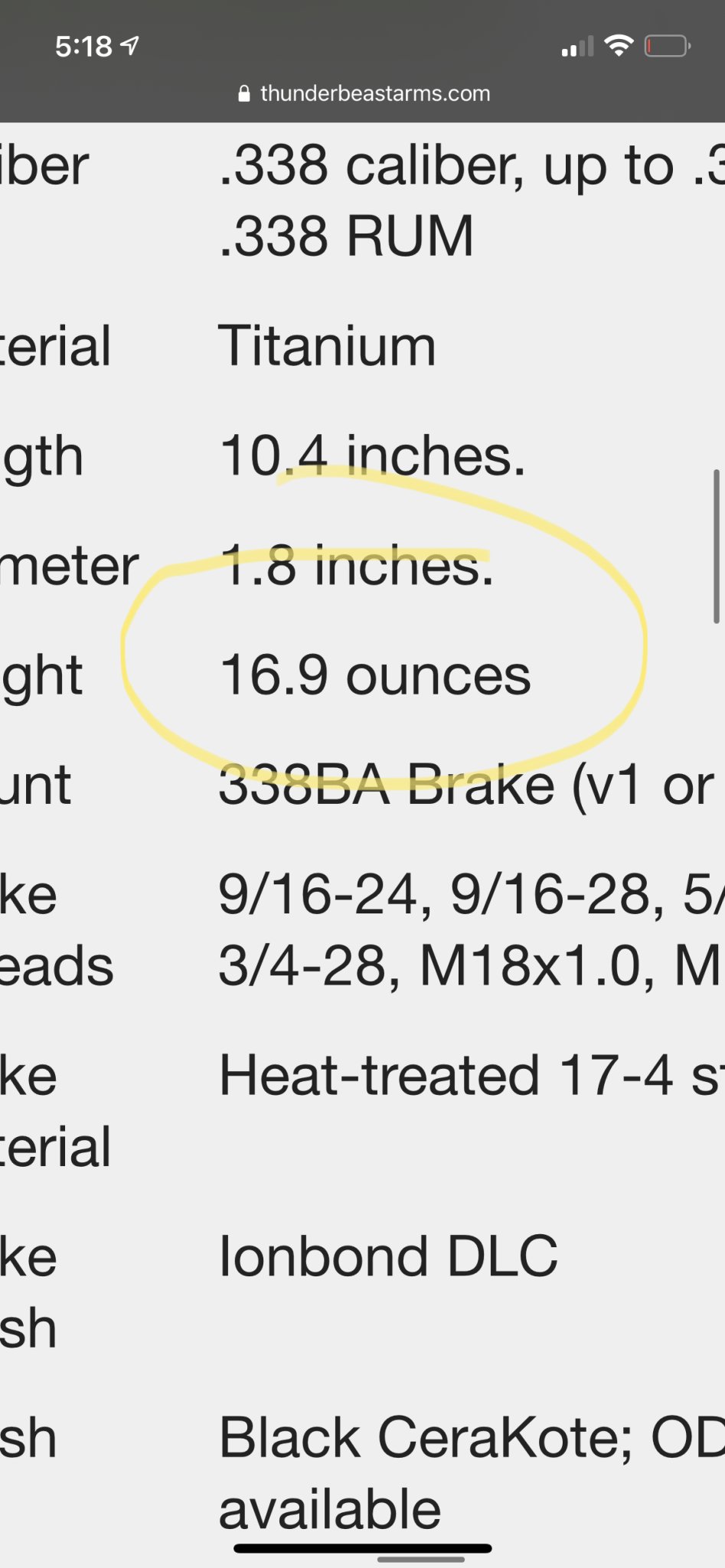

    Jeeze 6.5 oz in a ultra 7 ? I thought this one was bad
