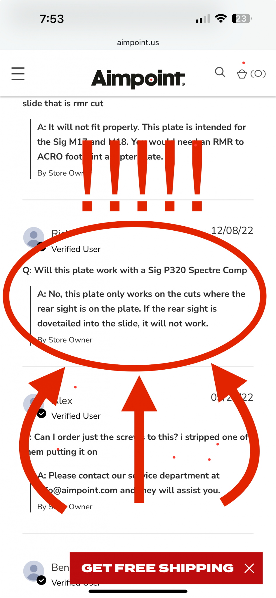

    Why you dirty rat! 🥴

    I get it. I didn't read the fine print! Maaaayyyybbbeeee this would work...
    or...
    or maybe...
    and lastly...
    P/N 112-011 because that one is what fits any sig that came with a Romeo1 PRO and the Specter Comp takes a Romeo1 PRO.
    Mea Culpa, @TheHorta

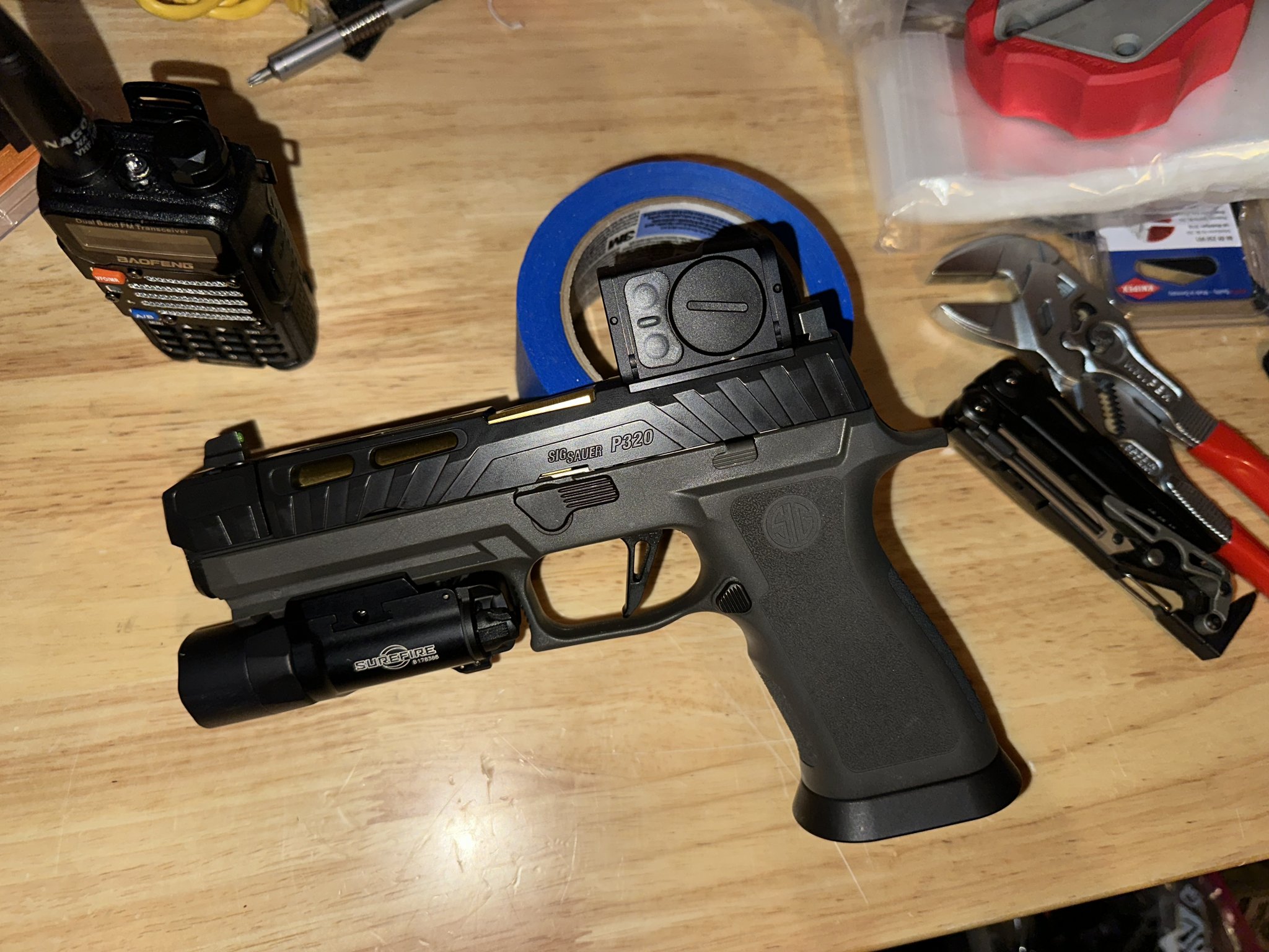

    I used the SSM-01LE plate for my spectre comp slide and Acro P2. Worked well. I bought the regular plate from Tango Down but it was the wrong one and didn’t fit. I guess the Spectre Comp slides are closer to the pro version for LE.

    Schweet. Just what Heir Doktor ordered!
