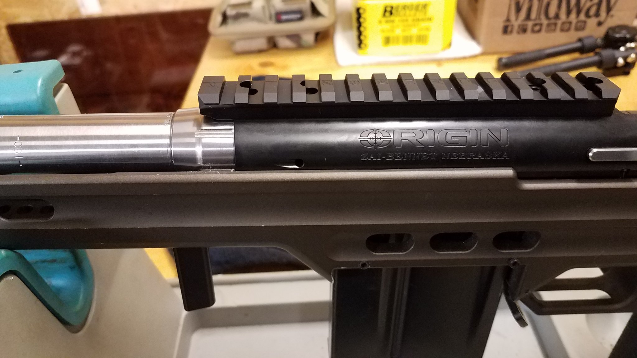

Criterion 6creed on an origin, cant even see the barrel nut...

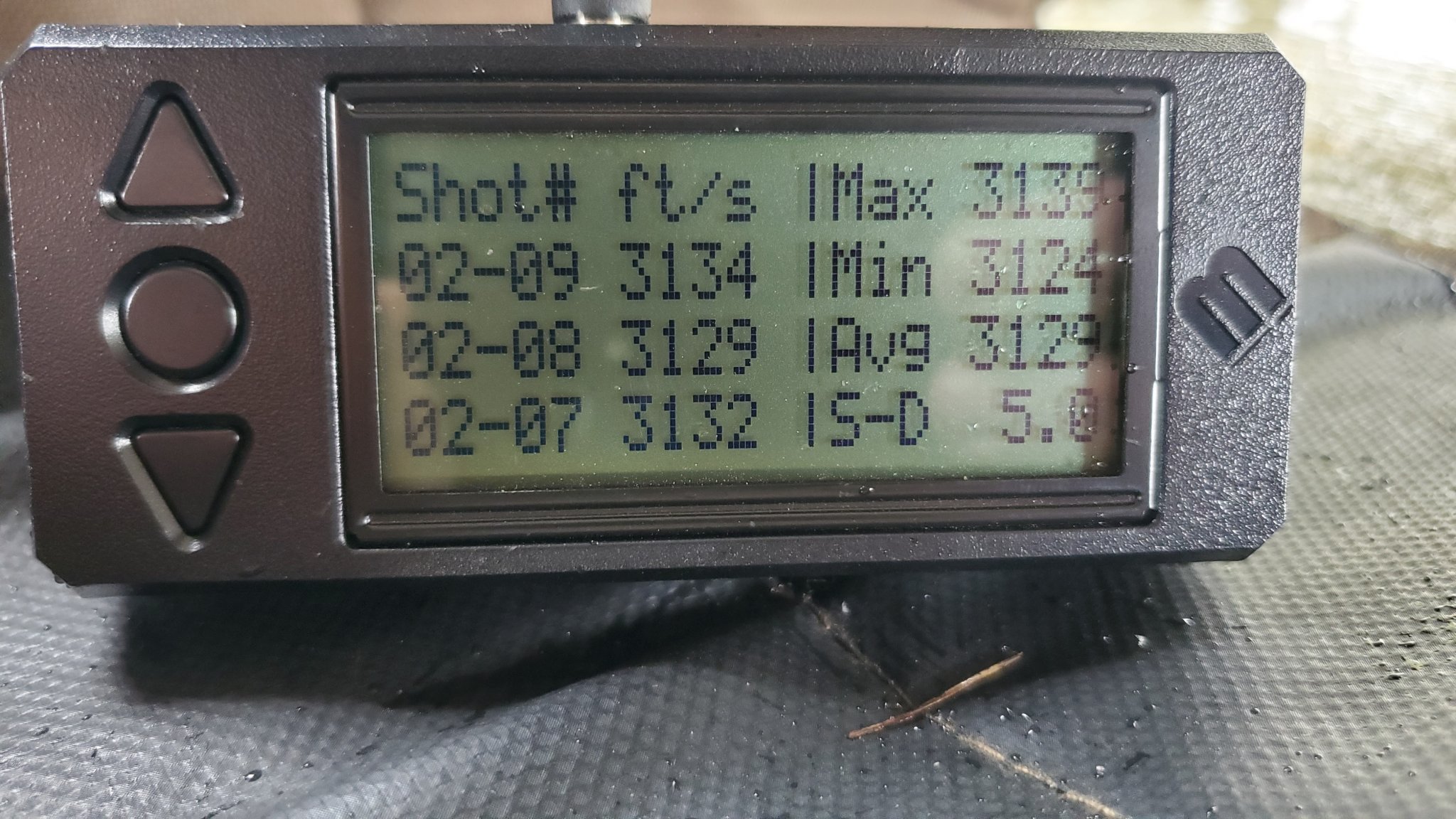

5rds of 105hybrids@3130fps
Chrony data from last outing
