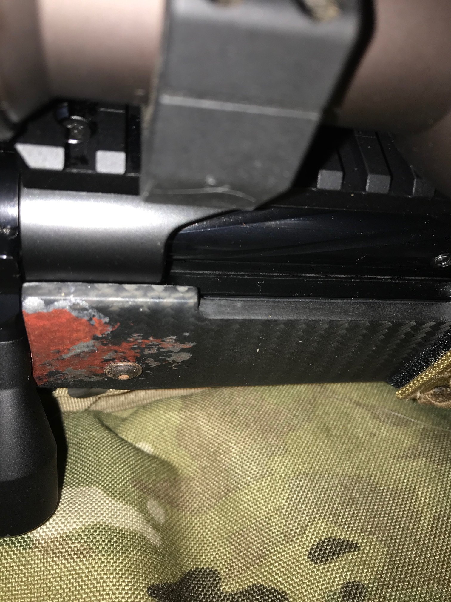

    I have a McMillan stock cut out for a Remington short action. I am thinking of trying a Big Horn Origin action but would like to know how the fit would be? Would the side bolt release clear the stock and how well would the port on the action match the cut out for the Remington action. With the swept back bolt handle I figure that the cut out for the bolt handle should work well. I am really not interested in having the stock cut on to work for the Origin action.
    Mine drop into Rem inletted stocks without issue.
    Zermatt put the bolt release high enough its no issue, would work even though I have them in stocks cut for the bolt.
    I can shoot you some pics of them tonight if you want.
    McMillan A5
    KMW Sentinel
    Manners EH1
    Here is an ejection port with a Bighorn TL3 and a Manners made for a Rem 700. It runs fine this way so you don't have to trim anything unless you wanted to.
