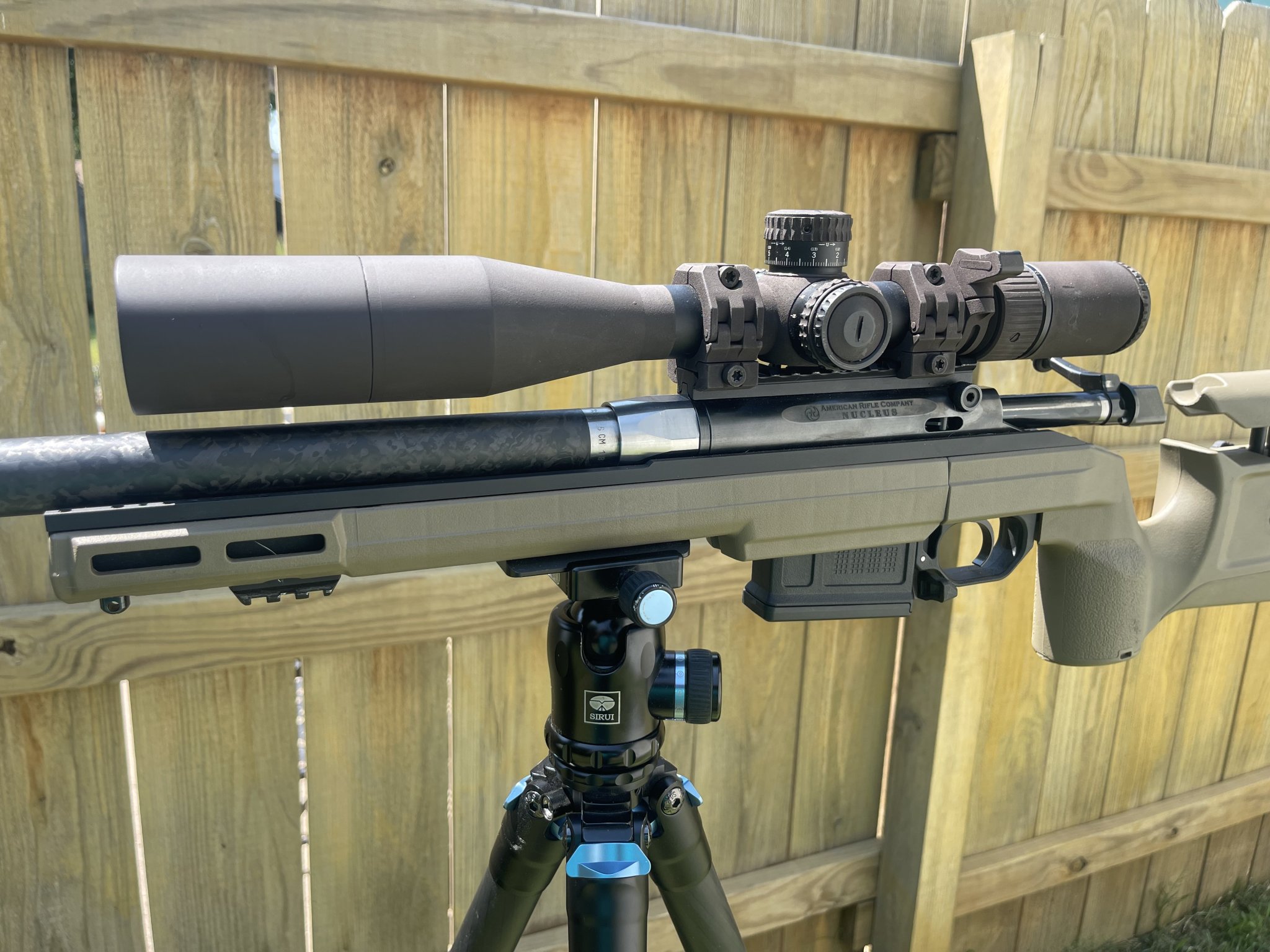

How repeatable is the set screw and loc-tite setup? I have a small shank savage prefit proof 6creedmoor barrel on my nucleus action with a barrel nut. It took me 3 tries to get the head space as it was the first bolt gun I ever put together. I have loads dialed in for it. And I don’t really want to take a chance starting over. I think it will be many years before I will have shot enough to maybe burn out this barrel. I get out once a month with 30-50 rounds at best every month of the year. I have been thinking about getting a shoulder 6.5prc barrel for this action and using it for hunting. I have a barrel vise the internal action wrench and the appropriate torque wrenches. I have seen people mention the set screw idea but I didn’t have a ton of faith in it repeating over and over again.
