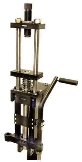

This was my go to press for all the big stuff. Corbin CSP-2 MEGA MITE.. A Beast....Everything else is done on a Redding Ultra Mag or Forster Coax.
