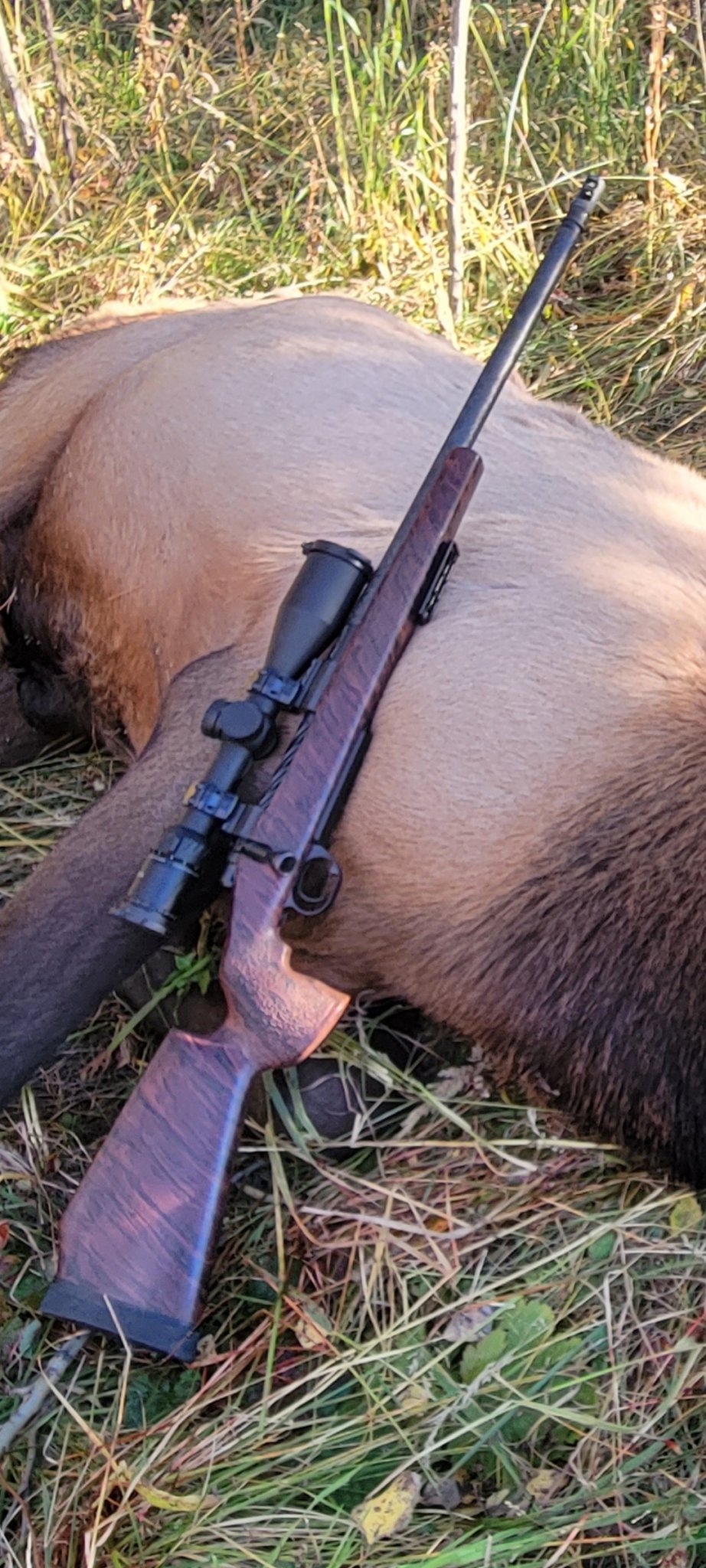

Personally, I have a new build in the works that will drop me from 8.25-8.5 all up. My hope is that, fitness levels and load out being equal, I can be that much faster and/or I can stay out longer. As long as accuracy and precision can be maintained in hunting scenarios (Shooting off a pack or UL tripod).
Reactions: gnochi
Yeah, if I planned to stick around 10x I’m sure I’d love the 3XR but I’ll be carrying at 3x, so the Hunter model looks best.
Speaking of, I just snagged said Hunter model at EuroOptic. I’m stoked!
@Wyfox it looks like the mountable section of scope tube is pretty short on a long action. I’d rather skip the rail interface, and stick with direct mount rings. Presumably the Talley extended rings would work; could you send me the diameter of the objective cap so I can figure out the right height?
Congrats, it's a great hunting scope!! Here's mine, anTi XM with 22" bartlein CFW, 7SAUM by George and the crew at GAP...
