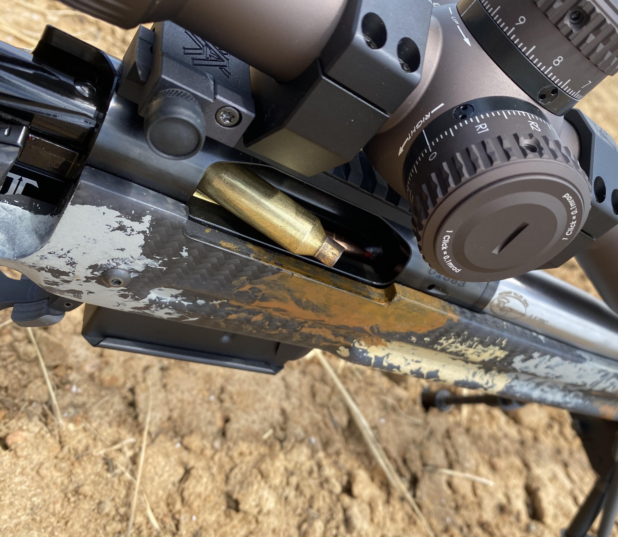

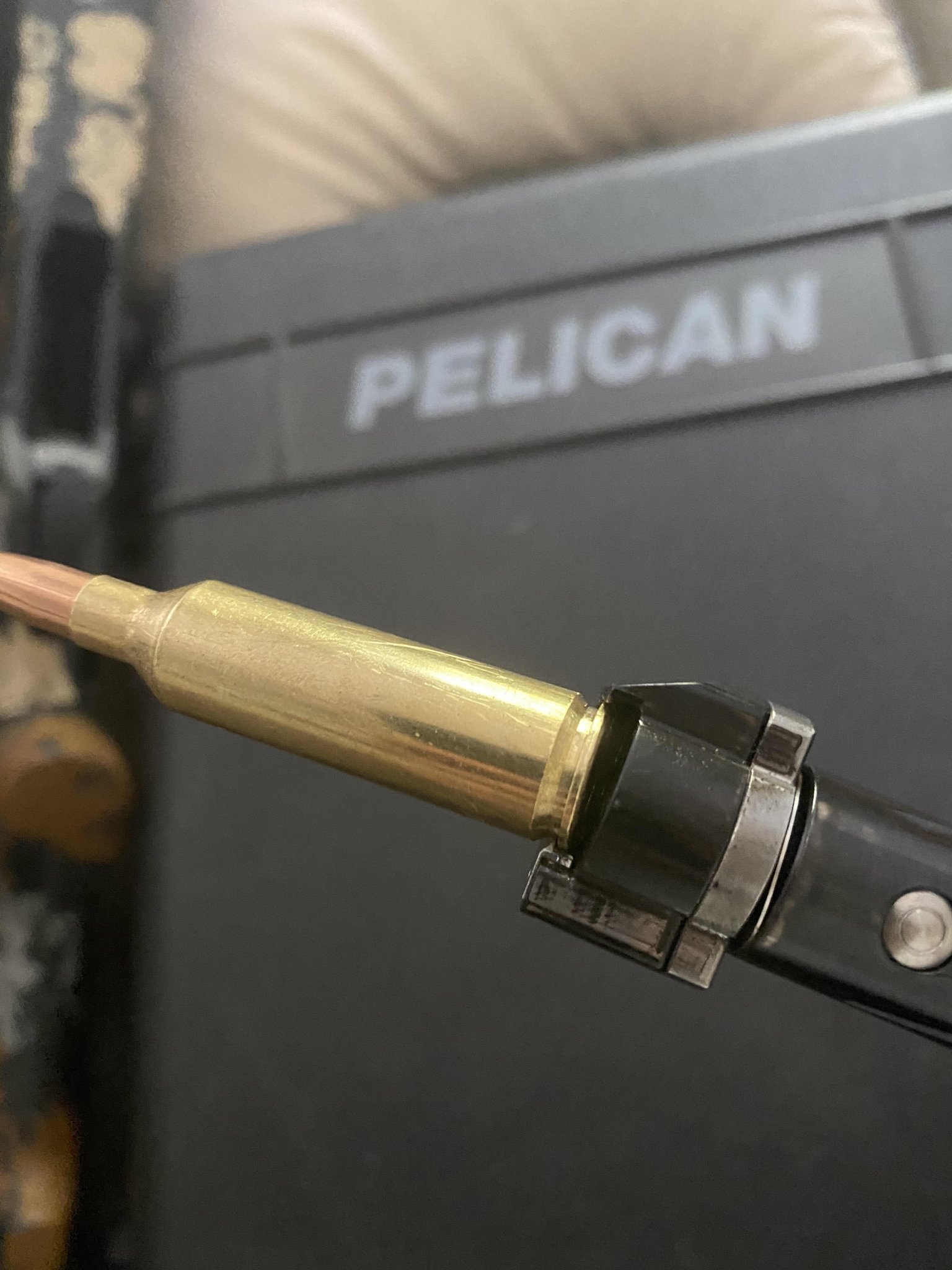

I recently was able to take my Origin build out for the first time and had some trouble getting proper ejection. It is a 6.5PRC with PVA barrel. The rounds chamber perfectly and the rifle shoots well so no other issues other than the ejection. When using a 3 round Accurate Mag 300 WSM mag, the first round always hangs up in the ejection port. Typically the 2nd and 3rd rounds will clear the port but are only thrown a few inches in the 2 o'clock direction no matter how quickly the bolt is cycled. I adjusted the magazines feed lips so that the rounds are held a little lower in the magazine and that helped some but definitely not 100%. It does not have the same issue when cycling live rounds... live rounds cycle just fine. Even with no magazine inserted, ejection is still pretty weak and if the bolt is cycled relatively slow (not unreasonably) the case will just fall straight through the magwell. Being somewhat of a noob, i'm not sure if this is significant or not, but if i take the bolt out of the rifle, rounds don't seem to be held very tightly to the bolt face... if I invert the bolt, the round falls out of it. Let me know if y'all have any thoughts on this or if this is going to take professional help. Thanks.

It is a magnum bolt head. Disregard the whole running it slow thing then. Those that didn't clear the port (as pictured) happened when running the bolt full speed. I tried to run it with varying degrees of oomph just to see if there was a certain speed it liked and nothing worked.

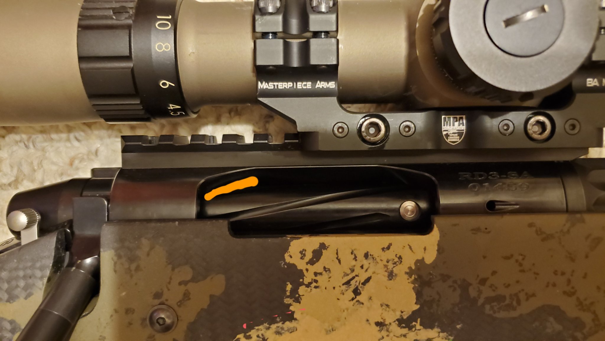

The brass isn’t hitting your windage turret and falling back into the action are they? The razor has large turrets and mounted low they can cause some issues. Check underneath the wind age turret and see if you have brass marks. The live rounds may be heavy enough to keep them from flipping up and into the turret.
Reactions: MarinePMI
200 bucks says its doing what I said, lol. I really like the origin, and tl3 actions, I just wish they'd squared up the rear corner of port.

It was clearing spent cases (ironically... considering that was my initial issue) but would drop live rounds straight through the magwell. Ray at Zermatt ended up just sending a new extractor to try out and that fixed it. I still needed to adjust to feedlips so that the rounds would sit just a little lower in the mag to get some extra clearance but I was able to cycle a few mags through it and there was a big difference in how the action was throwing brass with the new extractor.
