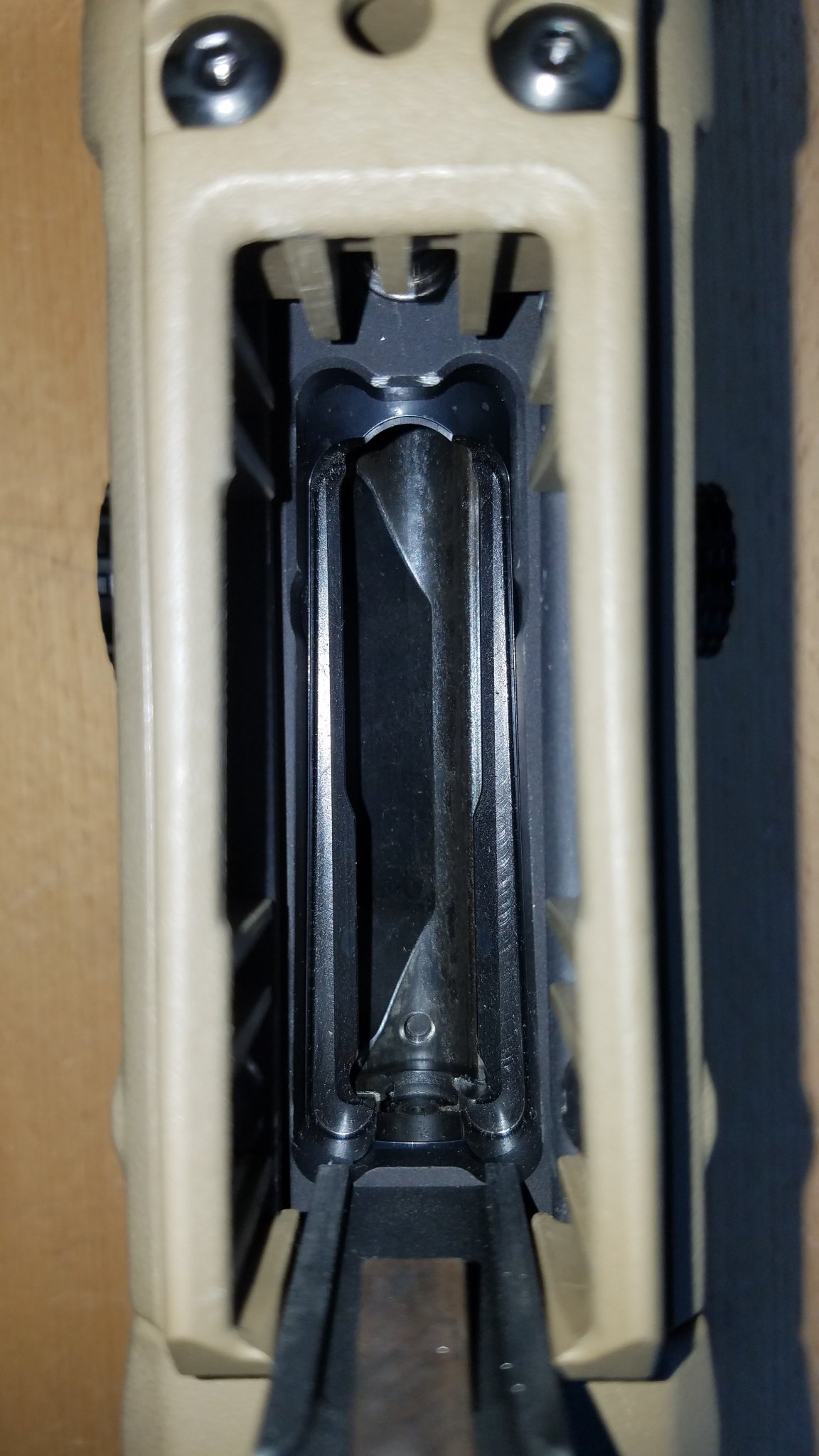

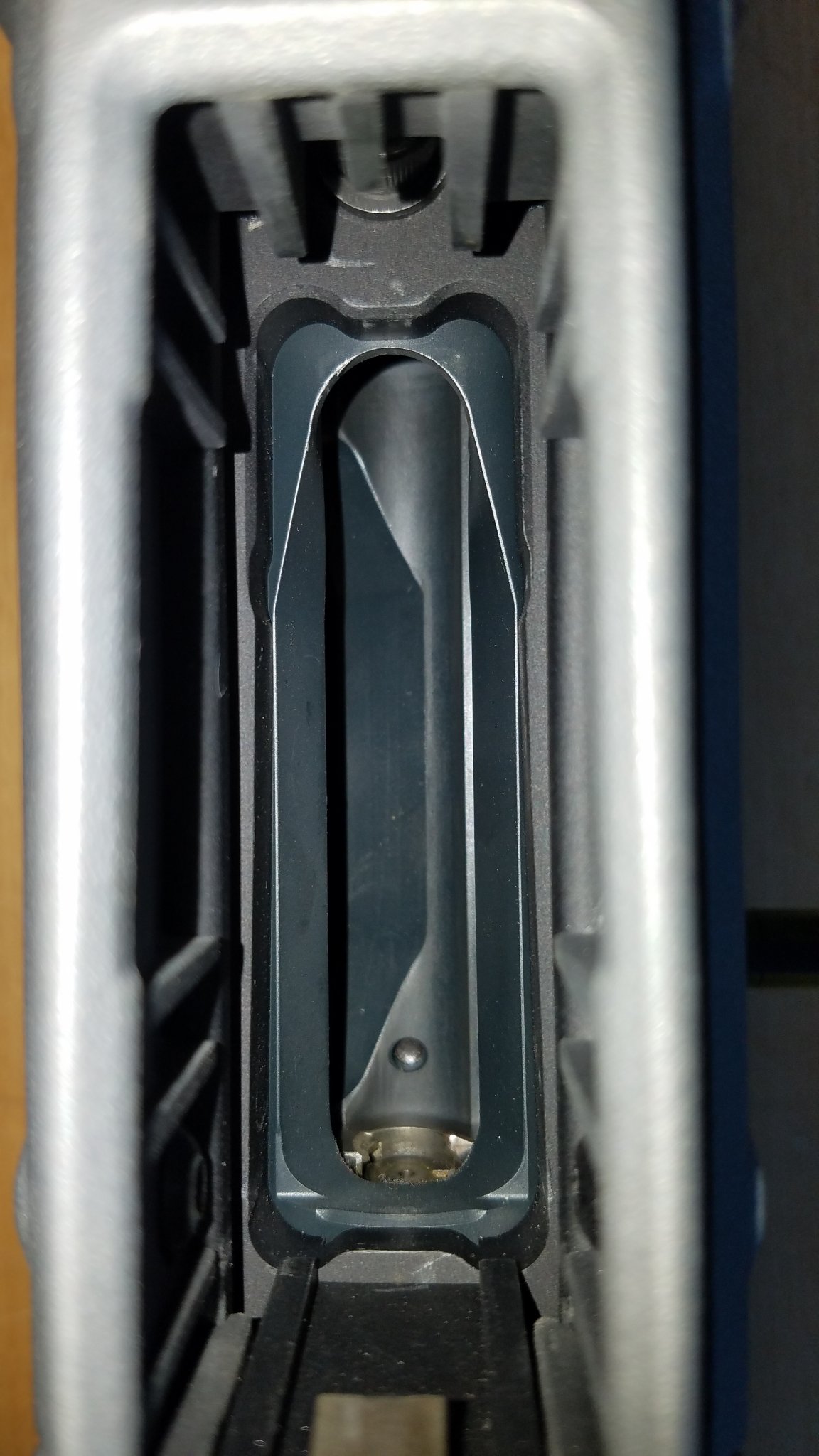

Do you have a picture of the Origin in a Chassis from the vantage point of the mag well? My Rem 700 is notched but overhangs the mag well a bunch, my Deviant overhangs like half a millimeter. I was about to pull the trigger on a Origin build but I don't want issues with feeding from a magazine like the ARC. Is the TL3 with AICS magazine cut different dimensions from the Origin?
Here are two pictures that show the Origin and TL3 (AICS cut) in a KRG Whiskey 3 chassis.
The Origin is cut to accept standard length BDL's and AICS magazines so it's a little different than the AICS specific TL3 cut.
If you have feeding issues (with ANY action) they're most likely related to magazine geometry. Call that bias if you want, but magazines are generally either stamped metal or molded plastic. Those processes are far less accurate than machining is so there will be variance from one to the next. The magazines can always be modified to work with the action you're using. If you have issues, don't assume it's the action first, try making adjustments to other products to fit your specific setup.
If you've got any questions relating to the pictures attached, please let me know and I'll address them. Thank you - Ray
Yea, magazines are definitely finicky but as a reloader I like the option of being able to load to the max length of the magazine without the plates and even on the defiance with the small overhang, the tip of the bullet can get wedged between the top of the magazine and the bottom of the action. It seems like the only way to do that is if there is 0 overhang between the action and the bottom metal.
I'd have to agree with Ray. This does not detract from the quality of the magazines that are being made today, but it's just that the tolerances of the processes used are wider than those typically held during precision machining.
