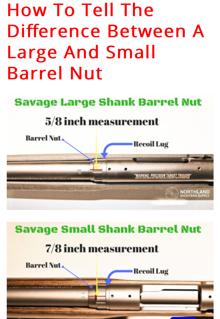

So anything that is a “savage pre-fit standard shank” should be good to go for a tl3, or does it need to specify as a tl3 prefit?
Savage prefit is a barrel nut configuration. The standard refers to the two different savage barrel tenon sizes. Standard (aka small) and large.
7102613
TL3 prefit description should be a shouldered.
