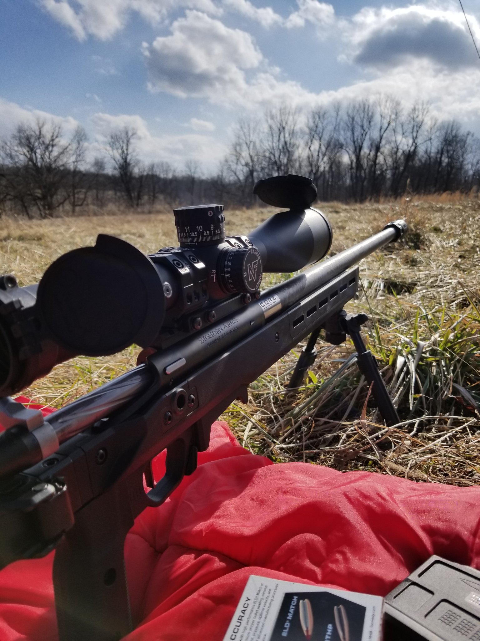

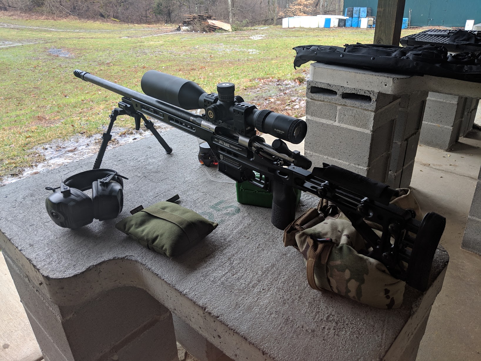

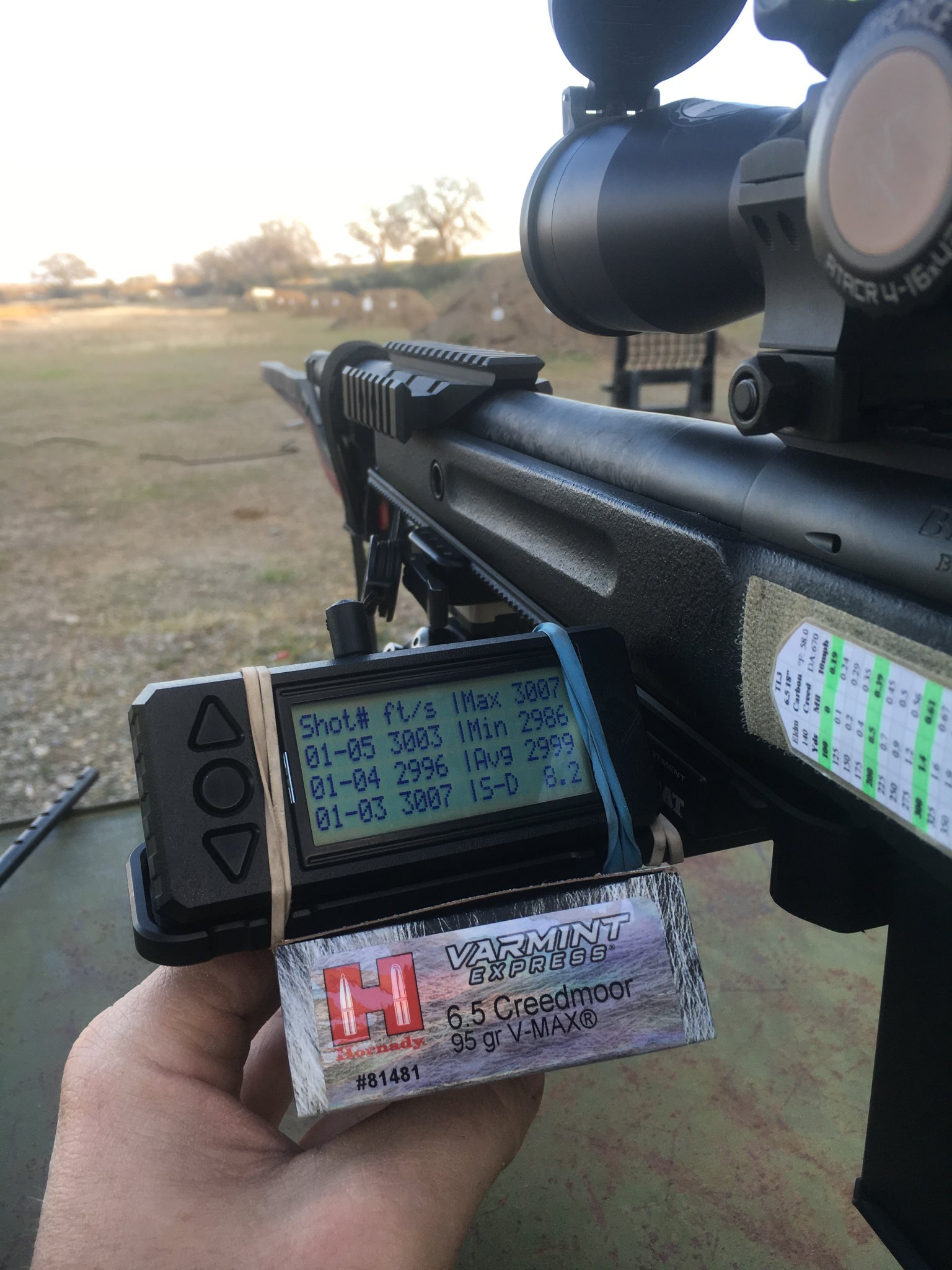

Newly finished 18” 6.5 carbon creed coyote/night rig. Was surprised to see accuracy and single digit SD’s from the new varmit ammo.

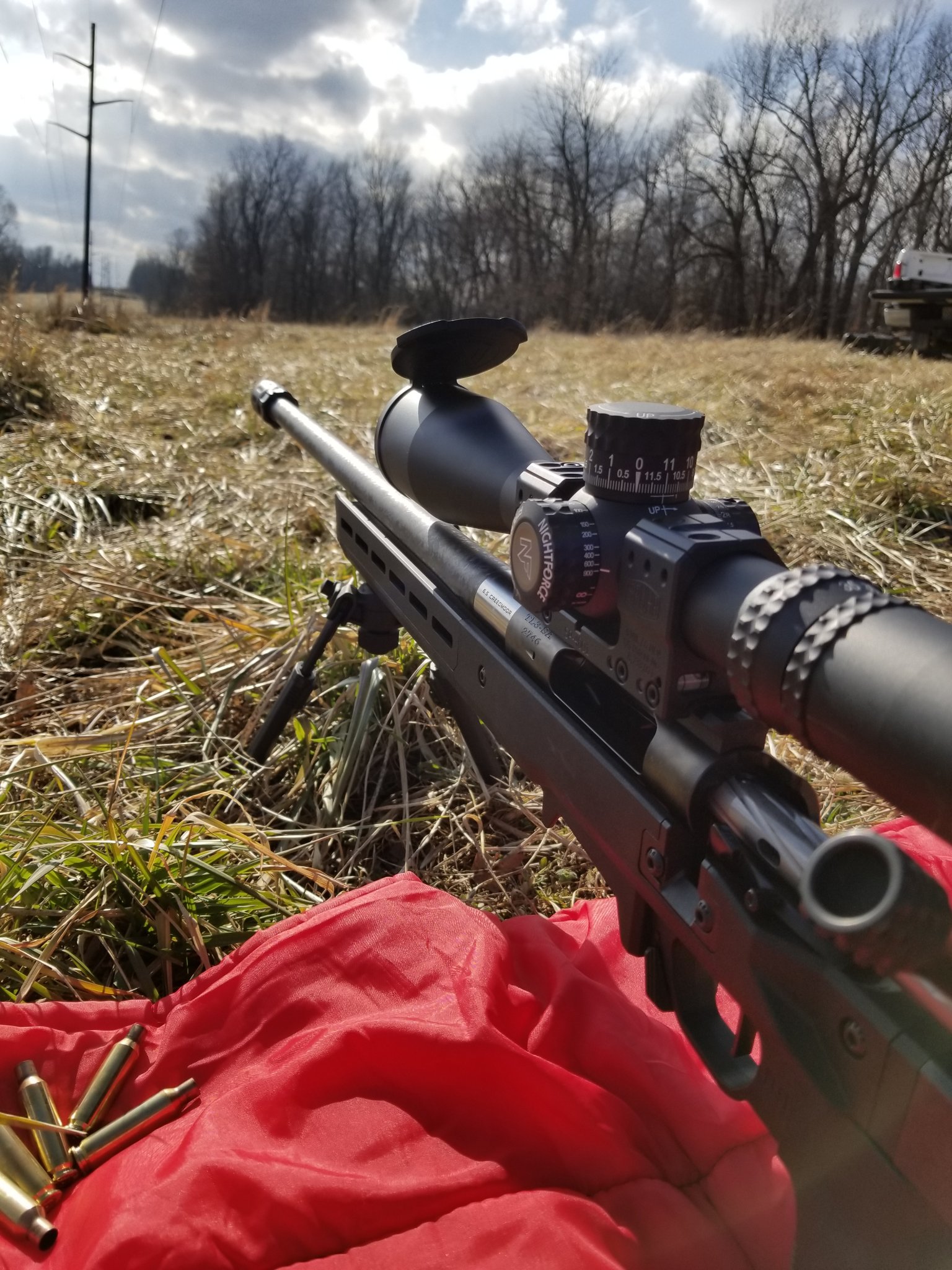

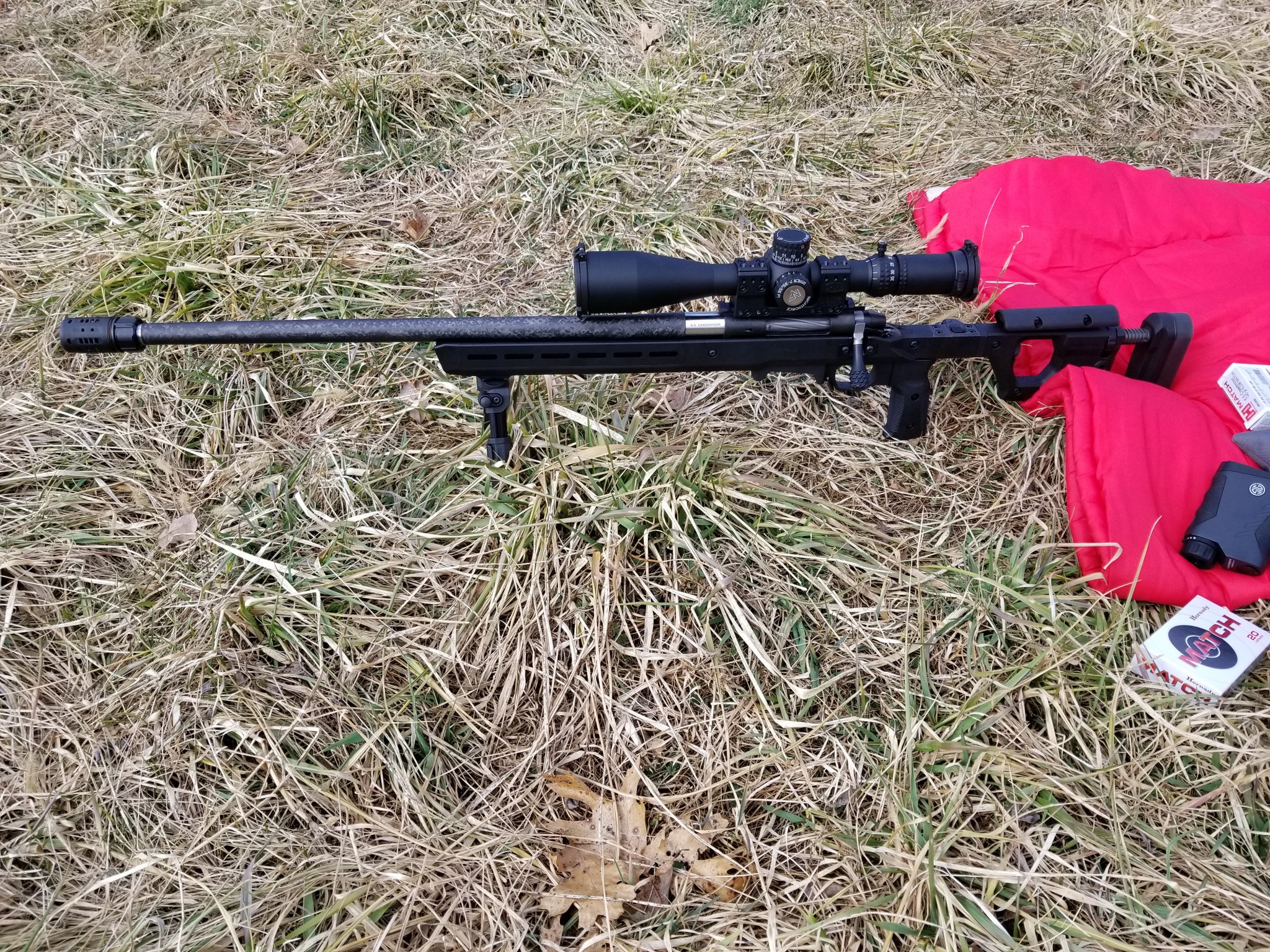

Newly finished 6.5 CM TL3 build. Beyond pleased with it!
Big Horn Arms TL3 LH DLC
Proof Research 26" Sendero
Triggertech Special - PVD Flat Shoe
Magpul Pro 700 Folding Chassis
Spuhr SP-4001 Optic Mount
Nightforce ATACR 7-35x56
Dead Air Muzzle Brake / Sandman L
Magpul Bipod

Nice build! What caliber you running? I have a TL3 and 26 inch proof sendero lite. Going to have it chambered in 6.5 Saum. Unsure of what stock or chassis I’m going to end up going with though.

Nice rig bro! How are you liking that chassis? I’m undecided on what I’ll go with but have been looking at this as an option. Been finding some new for around $800.
Thanks man. I'm liking the chassis quite a bit. As a lefty I appreciate everything being ambi and literally everything is adjustable so it is pretty comfortable once you get it set up.
This chassis is looking more and more like a viable option to me. I like the LOP starting at 13.25 inches and that the buttstock pad cants 5 degrees left or right. I’ve read some threads about it and will keep researching but if I can find one at a decent price I may snag it.

How does that Proof carbon prefit shoot??? Im Thinking about about one in PRC but want a 20” and its not listed on site.
I actually just picked that up on the exchange and started load development. It's actually quite nice I will try to put up a pic of a 10 shot group from it. It put 10 under an inch at 200. It's not the fastest barrel I have in 6 cm but it's the most consistent by far and that's really the name of the game.. oddly enough it didn't like the 115s it likes the 108 eldm and 41.8gr of h4350. So far no mirage issues and it doesn't throw any flyers on long strings. I'm a fan lol
