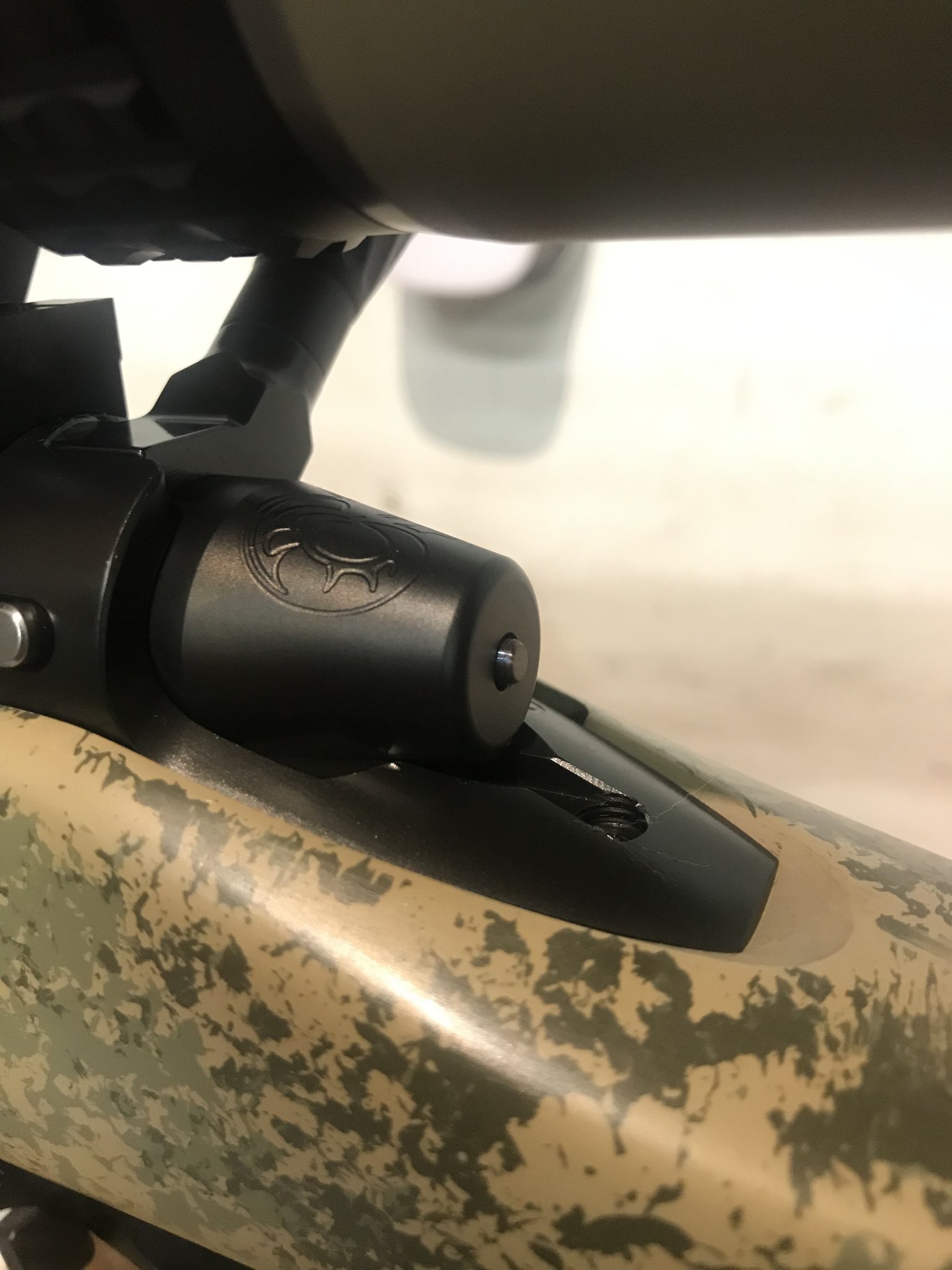

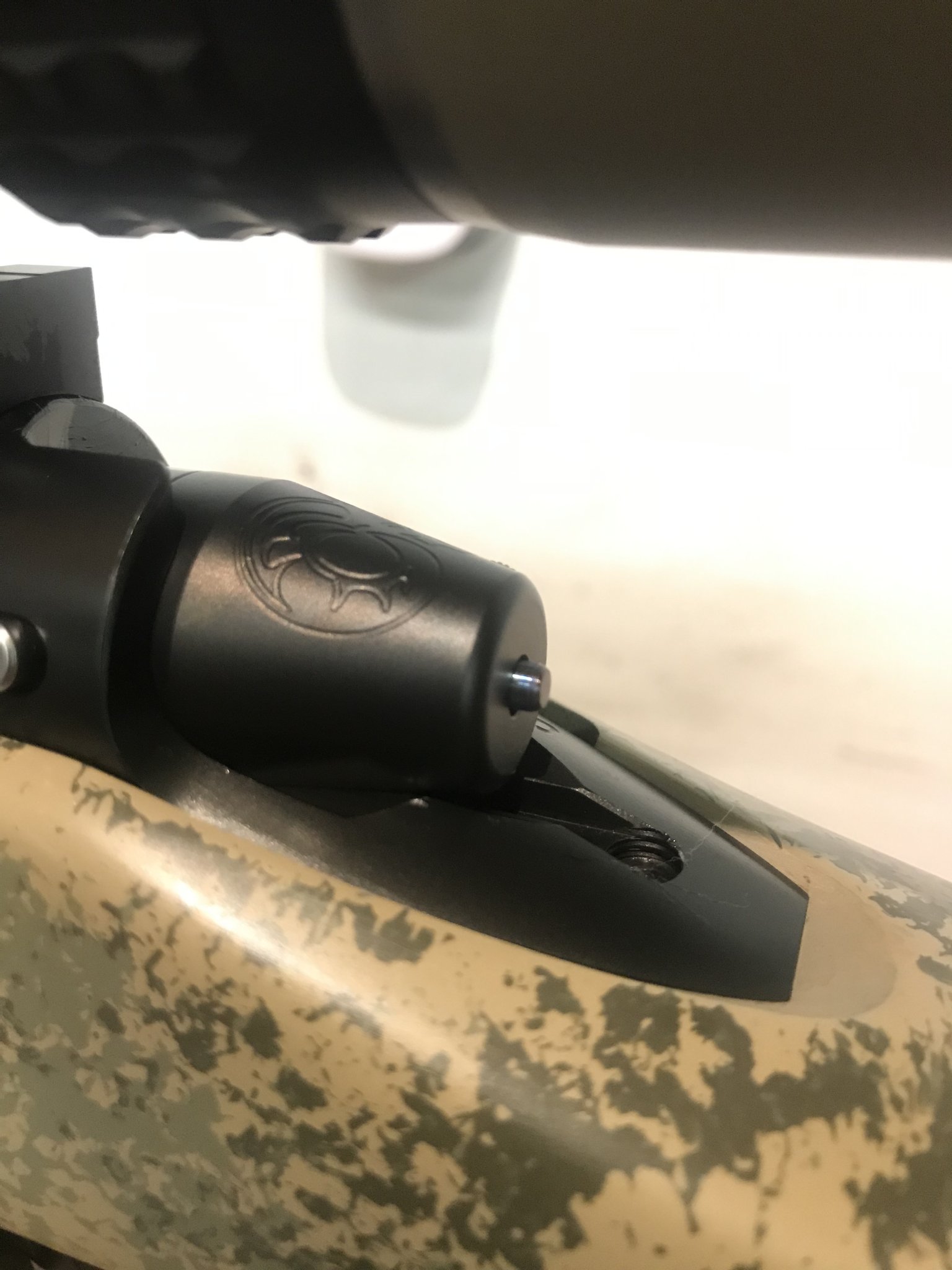

So I’ve got about 0.030” of cock on close, I’ll follow up with what I get back from Bighorn.

I told them about my measured .030" of cock on close, and they are sending me a a new cocking piece undersized by that amount. New cocking piece plus shipping was $33. Order was placed thursday and I'm supposed to receive the new cocking piece tomorrow. I can follow up with my results after I get the new one in.
