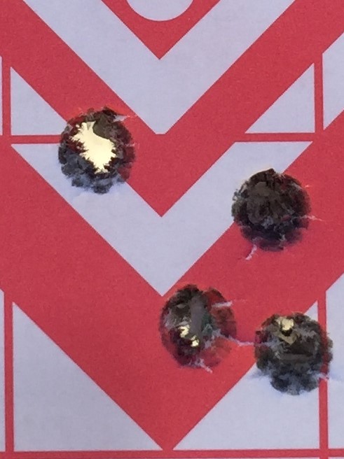

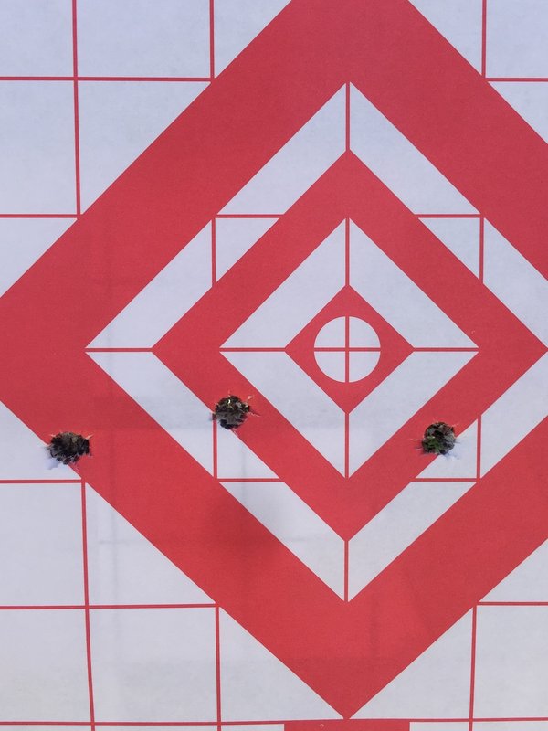

I am new to the Bi-pod world. I have been lucky enough to draw a tag for Pronghorn in 2 months and Id like to use a Bi-pod. Problem at hand my groups go from .65" of of a bag to 3"+ off the bi-pod on a bench at 100yds. The gun is a Montana 1999 in 6.5 CM sporting a Swarovski Z3. It is nothing fancy just a hunting gun. Bought it 3 days ago new. I figure ill be walking and shooting prone off of some sort of rest. Any suggestions on what to do or check to make it "shoot" on something besides a 10lb sand bag.
The good and bad groups. Top left was a called flyer on the good group. Hell I stopped at 3 on the bad one. Figured my 4th shot would have missed the back stop the way it was going.

What stock are you using? You are either overloading the bipod, not loading it enough, or the bipod is pushing the stock against the barrel.

Is the forend stiff enough to handle the bipod? Bipod legs act like a torque arm on the forend, a situation that isnt present when shooting off a bag. If your barrel is floated, but with iinsufficient clearance, you'll have issues. If it uses a tip pressure point, you'll have essentially the same issues due to inconsistencies shot to shot.
Bipods take practice for sure. A little forward loading helps. Whatever you do, you need to be very consistent shot to shot. Many have it down to a science, and they'll be along to give you the scoop.

The stock is Walnut I think. Seems pretty stiff to me. I checked the float by folding a dollar bill in half and it is good even when the bbl is hot.
Have someone run the dollar bill through it when you are loaded aiming at a target. You would be amazed how much flex some stocks have, and how little it takes to really throw your shots off.
I think ill clearance the bbl channel a little more. Cant hurt I wouldn't think. What is forward loading?

Forward loading is pushing the gun forward a bit into the bipod. This puts tension in the bipod legs and firms everything up tight.
Try shooting it off the ground. Sometimes shooting a bipod on the bench can be erratic due to bounce. But lack of sufficient stiffness or appropriate bedding in the stock is a bigger issue to look at.
Great advice here. I'll bet that your bipod, and your use of it, is causing contact between your stock and barrel. I have a similar issue with a Savage 10/110. The only solution, in my case, was to swap stocks (to a stiffer forend) or move the attachment point further back, where the stock is stiffer. OR....build a custom, which I did. Lol! I still have and shoot that Savage but I shoot it off a backpack or off a Hog Saddle and tripod when I want to go prone with that rifle. One day I'll put it in a better stock (heck, it shoots sub .3 moa all the way to 700!) but I haven't gotten around to it. You could also open the barrel channel a bit, as you mentioned; but you may need to do it more than you like esthetically. I don't know how far you're intending to shoot but shooting off a pack should be a really convenient solution for you. It's a lot easier to stalk and belly crawl with a bare rifle (sans tripod) and a backpack on - IMO. If you're bound and determined to go with a tripod, Frank (Lowlight) has some great instructional videos in the online training section and it might be worth paying for a month or two of access to watch them. I'm guessing your hunt is coming up here real quick; so getting some instruction on how to use a bipod properly is going to be important.
One other point - don't get too hung up on groups and group size. We all love shooting tiny groups but, for hunting, it's that cold bore shot that matters. Sure, you may need a follow up shot if you flub the first one but if your cold bore shots are consistent you likely won't have to worry and testing your group size in the field.

Your elevation looks good. This is almost certainly position, not gear.
how tall is your bipod? If it's a 12", just use a pack. If it's a 2', then take a knee, shoulder the rifle and gently lean into the bipod until you start to feel tension.(loading) I think with the feet in he dirt/grass your results will be better. Try to use bone structure to help steady your position as well. Do NOT put your elbow tip directly on your knee cap. Try to place it between the knee cap and your quad or your tricep off the inner leg. If you know how to use a sling on your non-dominant arm, this can really help too. Focus on your breath control (not go in to be easy if a Boone and Crocket is 100 yards out) and follow through. You're probably not going to shoot bug holes from field positions but basic bone structure, simple bipod technique and your fundamentals will almost certainty lead to a successful hunt.

Yes it does jump up a little to the right. However looks like I'm going to try another route now since the grass is waist high I've heard.
