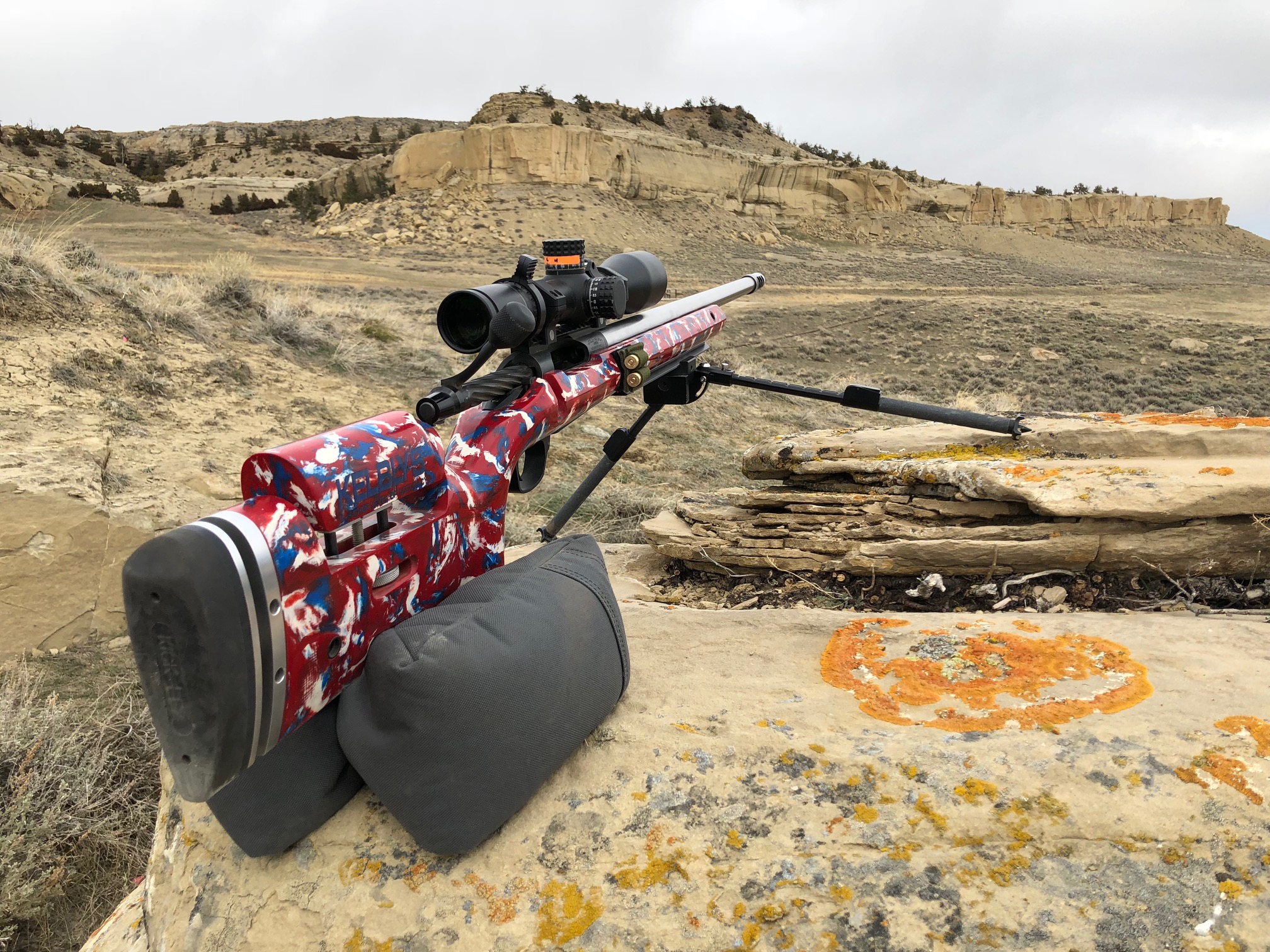

My friend up in Montana has just released this bipod. I have been using it for 3 years working out the kinks with him. Going from a Harris to a CKYE-Pod is like going from 2d to 3d no joke. No bipod comes close to its versatility. Period. Some bipods actually advertise 2-3 inches of adjustment...I don't understand why you would waste time with that..

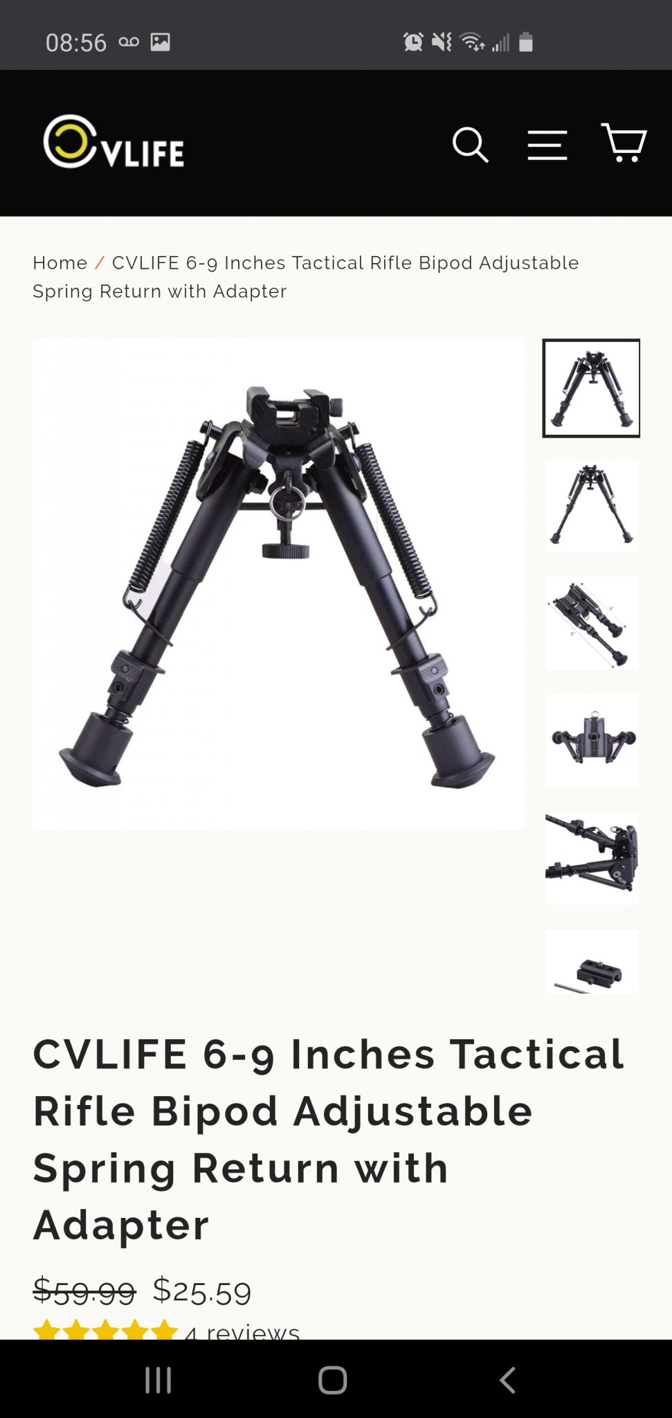

Well, somewhere between the below pictured $25 chinese Harris knockoff thing and the $500 bipods is the answer
Full disclosure, the above Chinese thing allows me to ping steel out to 600 regularly when I put it on my AR.
