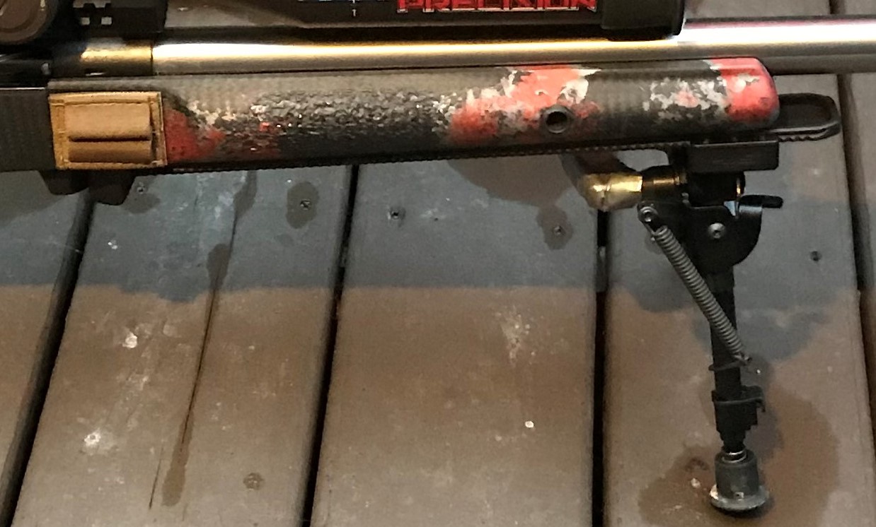

I have now shot my first NRL 22 match, I have been using an older Harris bipod sling stud mounted on my CZ457 AT ONE. It has the “pan” feature and I hate it, I am curious about the Atlas Cal specifically but am curious would I need an ARCA mount say from Area 419, or do they make an Atlas that mounts to the stud? Not sure what I need here, and am newer to the game.
Thanks
Steve

You can buy an Atlas Cal NC (no clamp) and then get the RRS BTC-Pro clamp. This will allow you to clamp on to Arca or Picatinny. You can then get the sling stud pic rail mount as a stopgap until you install an arca rail.
This seems like the definite answer, see I had no idea that extra hardware existed form RRS.

Harris doesn't make a bipod with built in panning, just cant or "tilt". That feature is with an adapter that has a lock for it.
What you likely need is a locking lever:
or
Something like - https://amzn.to/3JF8Yx7 for a stud to pic rail converter.
The RRS btc-pro and arms-lr are pretty expensive, but they're components i have transferred along with me for many usages. My new magnetospeed mount allows for me to use a btc-pro, and also different bipods (thunderbeast, atlas) also use the same mounts.
BTC-Pro is $80 but sold out.
Is the best place to get RRS stuff w/ no tax and free shipping.
Additionally you can try to find them used but they go quick.

As mentioned above the Harris don't pan so if it's the swivel feature then I can see your problem if you don't have a pod loc. Without one you really can't tighten it enough to take the swivel out. You can also get an ARCA attachment for the Harris so you don't need to buy a new bipod. Get an ARCA rail and you are all set. Pod Loc, Bipod clamp kit and 14" Universal rail and done.
That’s exactly what I needed I really appreciate that. Saves me a buck also.

Another good option (assuming that your going to upgrade from the sling swivel) is our new MDT GRND-Pod: Check it out!
Quick feature list:
  • 4.5” - 9” as measured by the pivot point
  • cant w/ tool less tension lever, but no pan
  • RRS Dovetail/ARCA compatible as well as picatinny (ARMS-17 in the works too if you want to run a RRS SC-LR or ARC clamp)
  • 4 leg positions (0, forward canted, vertical, 180 (stowed))
  • Rapid deployment and easy to adjust when you're behind the gun!
I am biased, but I think that this would be another great option for you!
- Josh

I’m kind of in the same boat, looking to upgrade my Harris to something better that I can use with my centerfire and rimfire rifles.
A few years back I swapped the Harris swivel stud mount for the RRS Arca/pic clamp to be able to quickly remove The bipod during a stage when bipod wasn’t needed.
One of the first things I added to my rimfire rifle was the 14” Arcalock rail from Area 419. I also put a Arcalock rail on my centerfire, so both guns can share the same bipod.
If money is an issue, I’d rather stick with the cheaper Harris and put the money saved towards equipping my rifles with Arcalock rails because of the added versatility the rail brings to the different positions we shoot in (e.g. slide the bipod closer to the magwell for shooting off the top of a barrel) and the ability to attach a bag w/ Arca clamp to the rail for barricade shooting.
That said, the 3 bipods on my list are the Atlas CAL, Accu-Tac BR-4, or Grnd-pod (all with an Arca clamp). Problem right now is the Accu-Tac and Grnd-Pods are backordered.
Totally agreed on the ARCA setup that’s where I’m headed, I did message Josh at MDT and he was more then helpful. I signed up for a class and I’m not sure when the MDTs will be available so I want to make sure that If I do order it will get here in time. I’ll probably hold off and wait for the MDT though.
Reactions: MDT_Josh
