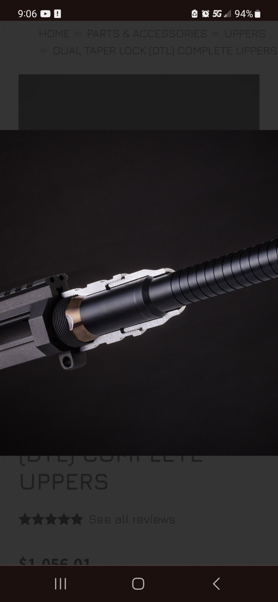

Using the dual taper lock system with a quad rail, for instance

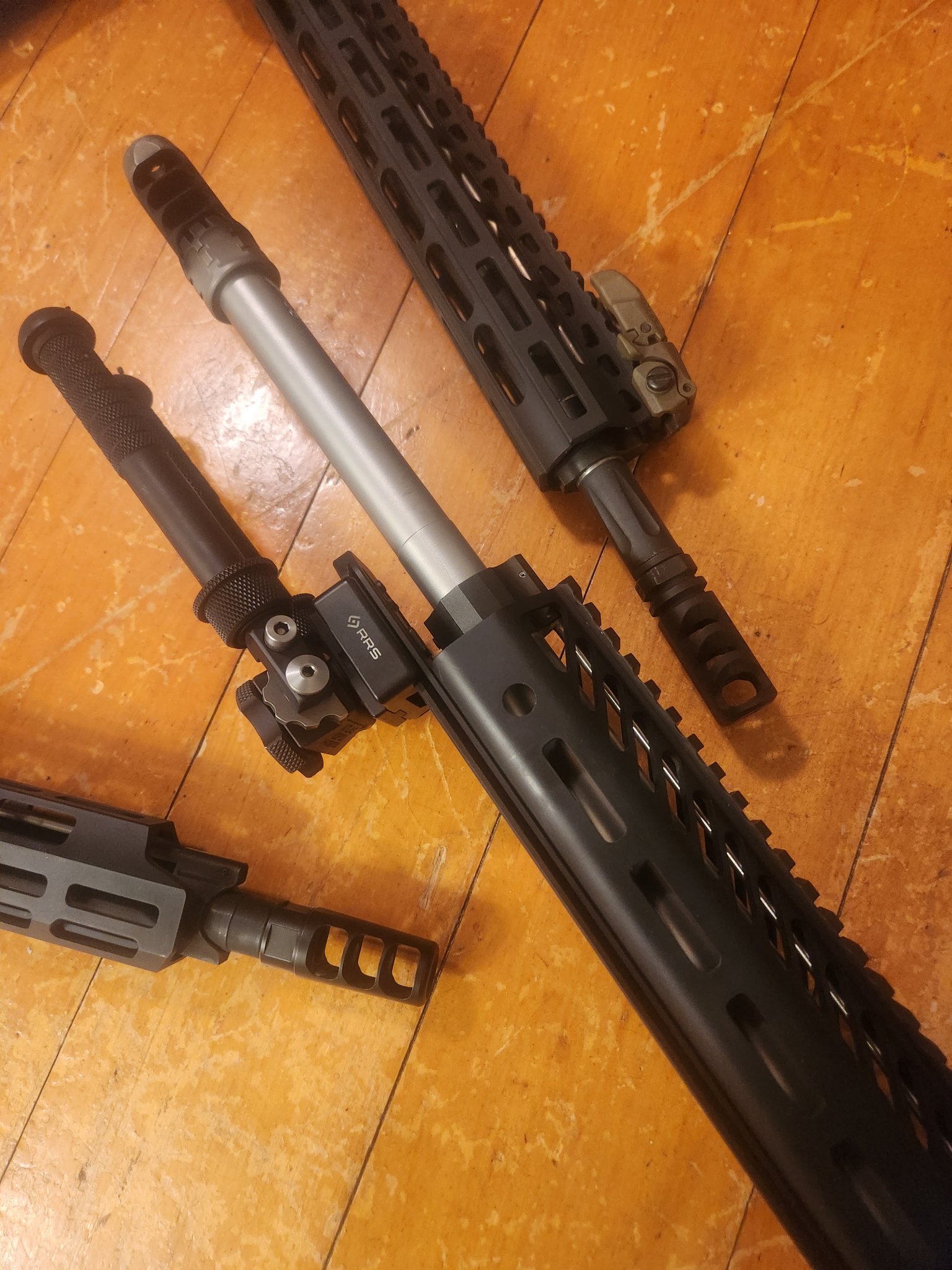

Me too. Shortest dwell time I've got is the bottom in the pic, 14.8" rifle gas. I don't know if I'd want to try an 11.5" mid unsuppressed. I'm going to check out the Blackout Defense though, I like seeing companies push the envelope.

Even better, check out their dual barrel nut system with thermal expansion rings cut into the barrel.
That's actually hilarious. I wonder if they genuinely think that's going to accomplish anything different? If they do, they need to get some education in bolted joint design. It's hard to tell with some of these companies if it's just completely marketing gimmicks, or if they're just bad at engineering? Could be either one too be honest; I've mentored more than a couple young engineers who really were that bad, but there's a lot of snake oil in this industry too.
