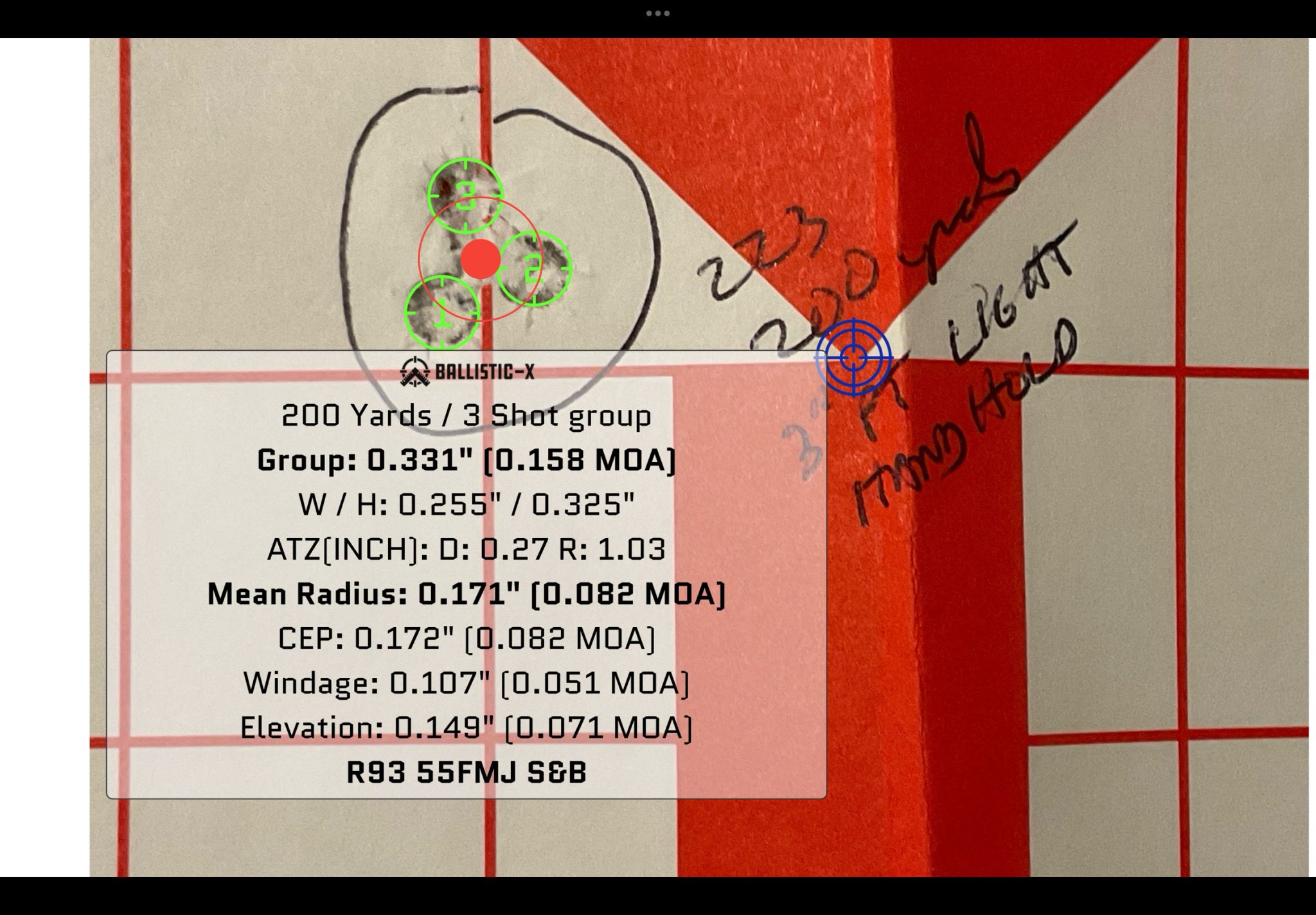

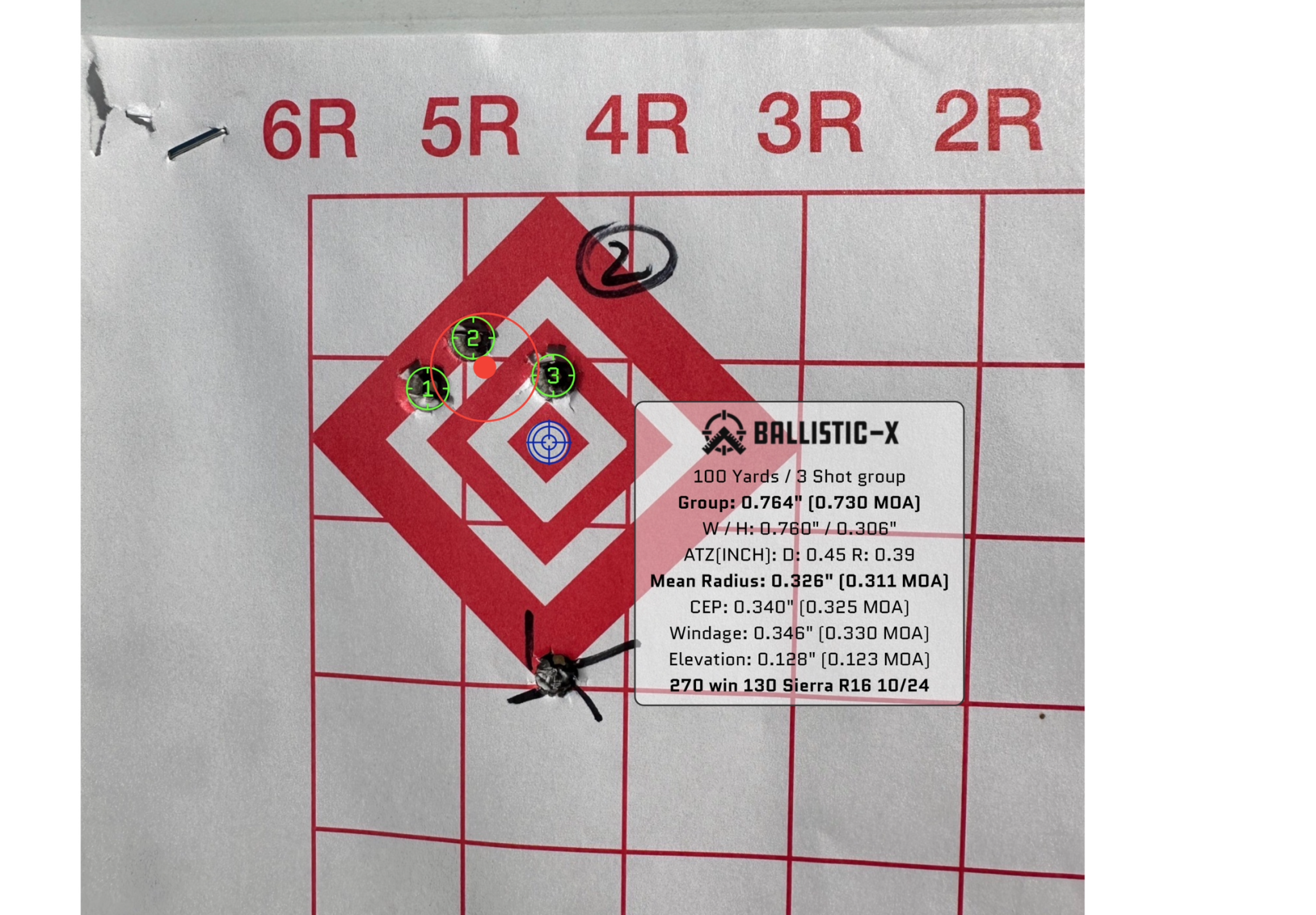

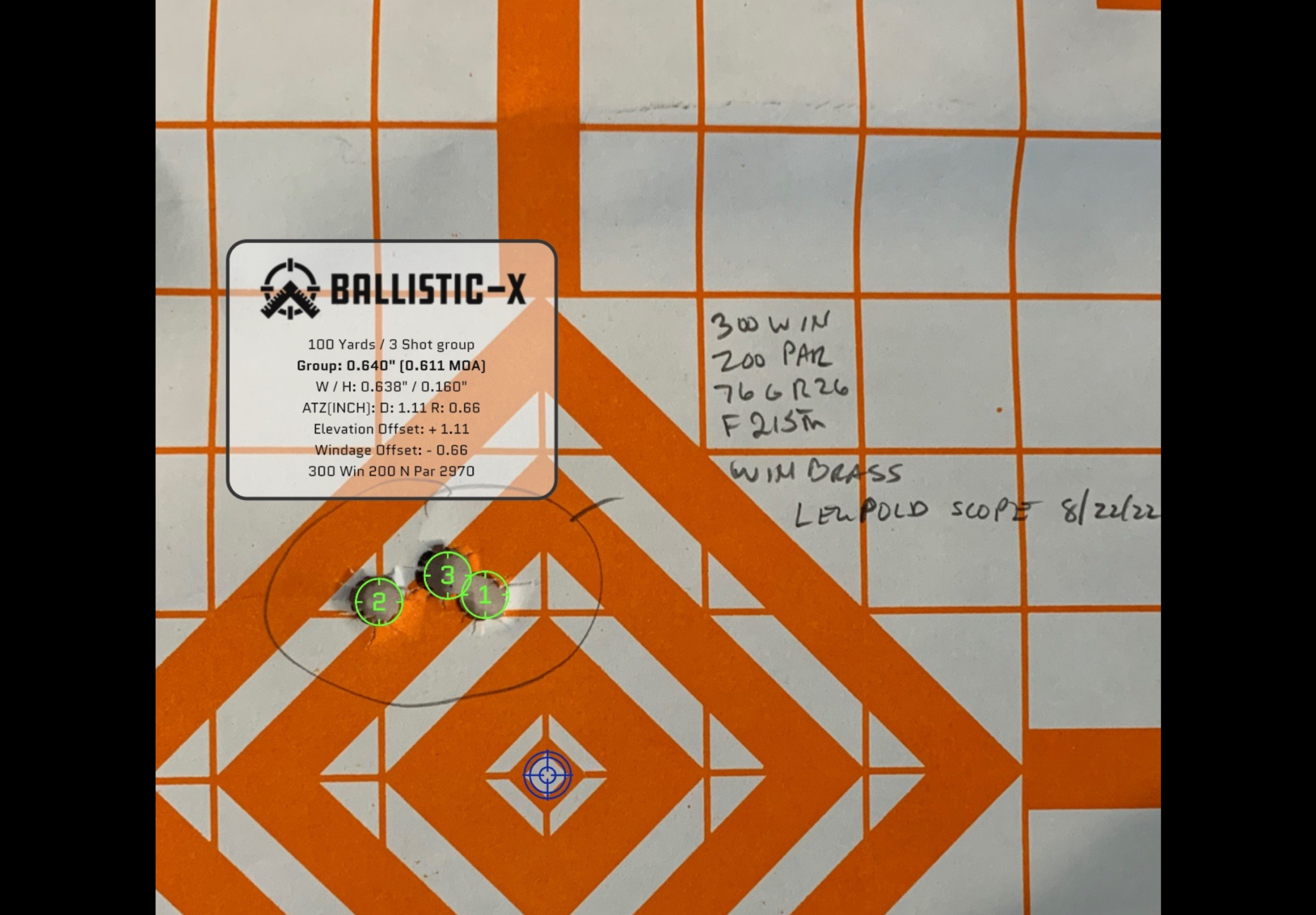

I have a R93 I bought used in 2001 for what is now a stupid cheap price. I have a 223, 270, and 300 win mag barrels and two saddle mounts. They are all stupid accurate for a light very balanced hunting rifle. The 270 barrel is the only rifle I have that oddly shoots the same sized groups at 100 and 200 yards; I’ll translate, if the group is 1” at 100 yards, it’s typically 1” at 200 yards, not 2”. I’ll try to find some pictures of groups and post them.
LRS2 definitely buy it.
1st picture 300 win 200 Nosler Partition. 2nd picture 270 130 Sierra BT. 3rd picture 223 Sellier & Bellot 55FMJ cheap factory ammo.
View attachment 8546991View attachment 8546992View attachment 8546995
